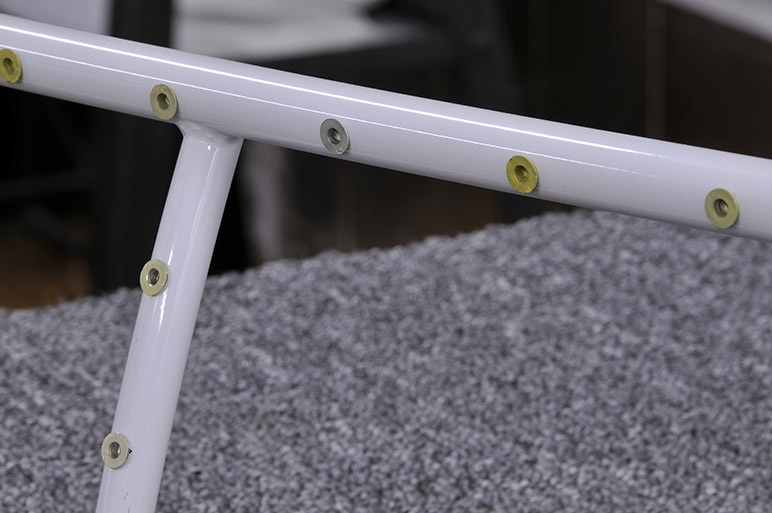

Thanks everybody for the feedback. Installing those two-legged nut plates are definitely a pain in the rear. What's everyone's opinion on using #6 AN Rivnuts instead ( http://www.aircraftspruce.com/menus/ha/rivnuts.html )? Seems like the sheer and clamping strength of these has to be at least as good as those pop rivets? I used the #6 AN Rivnuts to attach the canopy and they are really nice, easy to install, and hold very well. I've attached a picture of them from my canopy frame for those that haven't see them before.

Matt,
With unkeyed rivnuts set in sheet aluminum, it's not a question of *if*
they will spin, but *when*. Think about the fun of drilling off the head
of a steel screw that's spinning with the spinning rivnut when you make
your decision. Smile
I have a strong aversion to them; I'd rather drill out a few dozen
aluminum pops than deal with a spinning rivnut.
