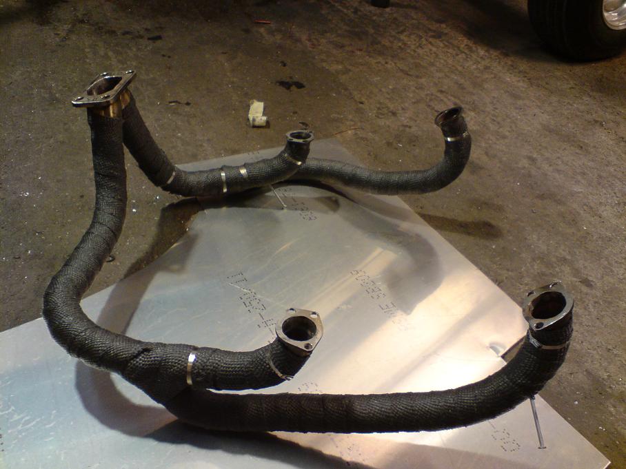

I wonder if anyone else has tried to turbo convert the jabiru 2200 engine before. I have a Kitfox IV with a early model engine witch only put out 50-60HP I guess.
What I have done is ported the heads both intake and exhaust chambers, mounted a Aerocarb 35mm carburetor intended for the 3300 jabiru and mounted a turbo on my custom made turbo manifold.
I run 6.5psi of boost and it makes so much more power now after the rebuild and convertion.
These are the before and after performance on the kitfox.
Climbrate BEFORE - 500ft\m NOW 1600-1700ft\m
Cruise speed 2900RPM BEFORE - 82mph NOW 105mph
Full throttle level flight BEFORE 90mph NOW 122mph
I have just run the engine on different throttle settings for 6 hours now with no trouble with either CHT og EGT. All lambda readings are ok as well. The Aerocarb with the mixture controll makes it perfekt for the turbo convertion.
