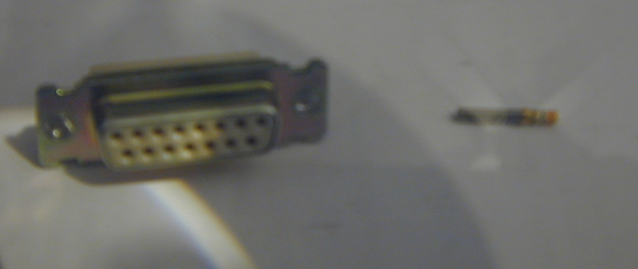

Is there a reliable and INEXPENSIVE crimp tool out there for the ITT pin sockets Garmin PN 245-0022 and 245-0027 20 to 24 AWG?
These are in a 162-0100 or 162-1575 15 pin Dsub connector shell. I haven't any conversion list for these Garmin part numbers.The specified tool for the 245-0022 is Astro 615708 w/positioner 616356 and for the 245-0027 ITT/Cannon (regular duty) 995-0001-585 crimp tool (M22520/1-01) with locator 995-0001-244 (TH25) or heavy duty 995-0001-584 (M22520/2-01) with locator 995-0001-604 (M22520/2-0Cool and also insertion tool 274-7006-000 (CIET-20HD).
The Dsub shell that came with the radio is marked X ITT 0903 DAMAE 158. The pins that came with it are colored silver for the longer socket end and copper on the short wire insertion end with three color rings starting at the end with orange then green then black or navy. The stepped band for locking in shell has a small hole drilled into it.

http://www.bandc.biz/index.asp?PageAction=VIEWPROD&ProdID=146
