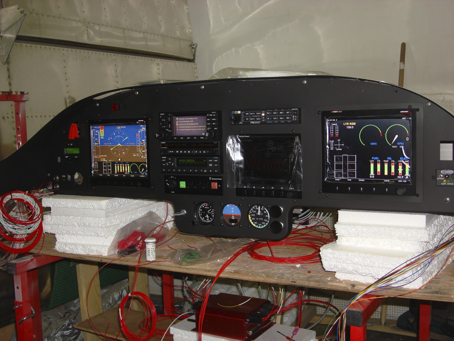

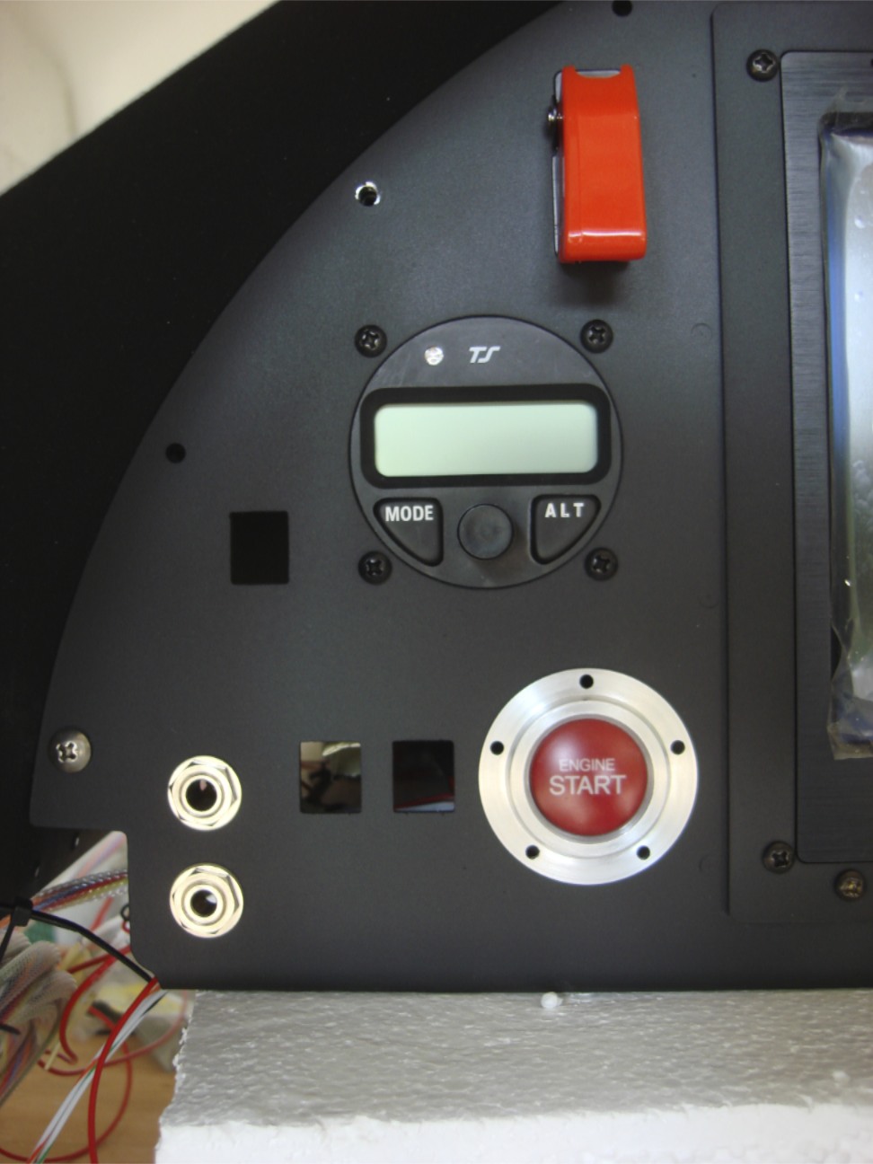

PostPosted: Tue Jun 09, 2009 1:03 pm    Post subject: Closing Note regarding VFR code on the Garmin GTX 330 Reply with quote
I just wanted to let you know about a software glitch in Garmins GTX 330. Nothing critical but in case you try to change the VFR ID if you have set before the Aircraft ID to HEX and entered the HEX ID it won't save the newly entered VFR code.
YOu have to set the Aircraft ID to N number then reboot and after that you can change the VFR ID in my case to 7000. Then reboot again and set the aircraft id to hex and enter the HEX ID.
Now all works fine and now that was the last bit in my panel that needed to be resolved as far as I could test it in the workshop.
Now I am waiting for the new VP-200 software update to see the external starter button work.
Attached some pics.
Cheers
Michael
Panel
 Filesize:  508.69 KB
 Viewed:  18783 Time(s)
 Filesize:  151.57 KB
RV-10 builder (flying)
#511
