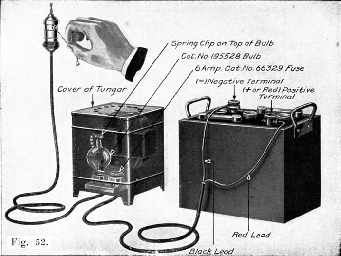

over the map. The very first charger I owned was a
6v Tungar rectifier electro-whizzy.
[img]cid:.0[/img]
The output quality of this thing would have been
REALLY noisy, ZERO voltage regulation, hideously
inefficient, but entirely suited to keeping my '41
Pontiac straight-6 ready to start on a cold morning.
By the way, anyone interested in exploring/reliving
some of the history of lead-acid battery technology,
feel free to download this item. (Caution 9+ MB)
http://tinyurl.com/owad89
