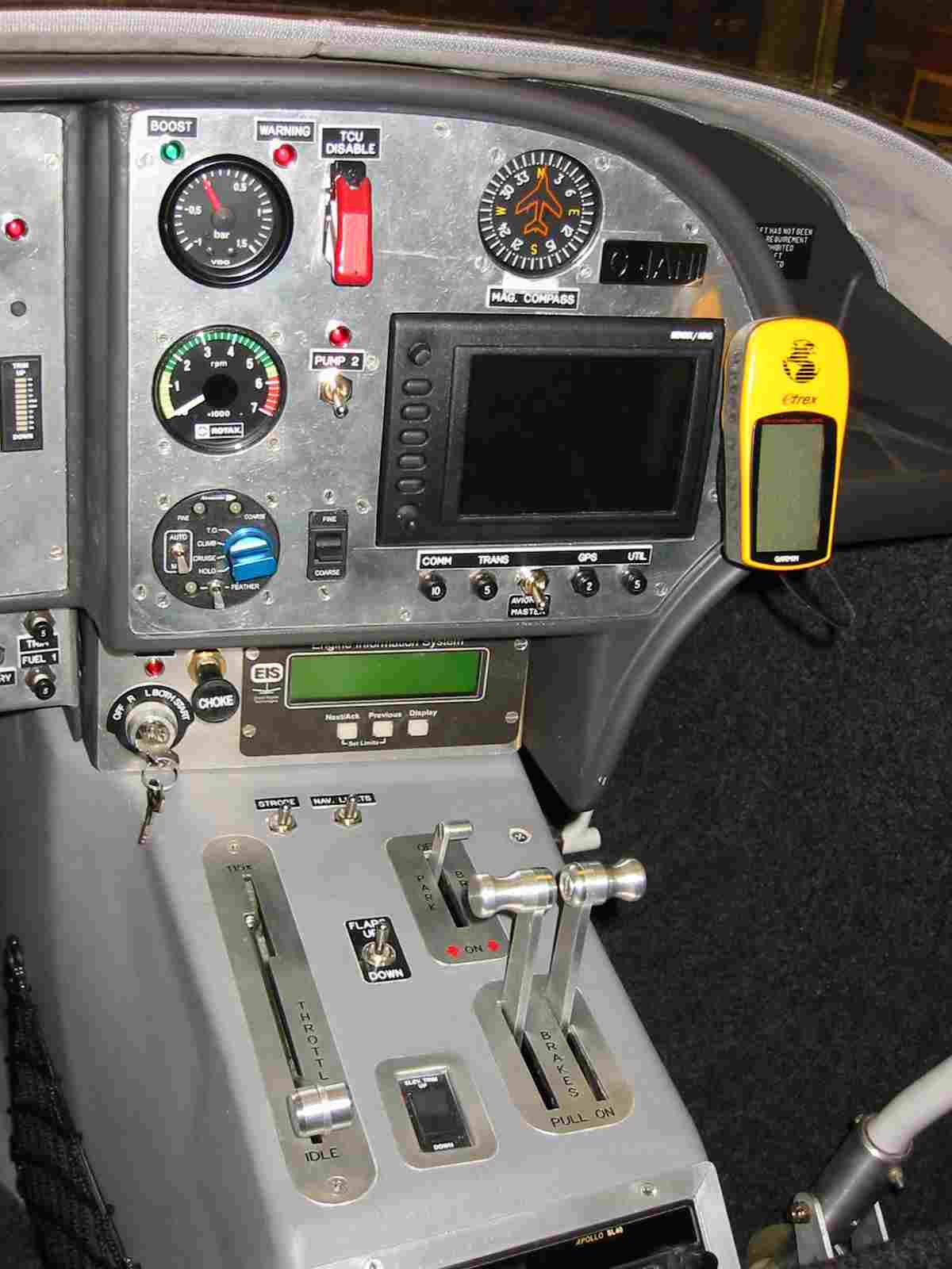

Ron
What Craig has described is set out as LAA Standard Mod 10402. This is
available on the Club site.
I have "guide rails" on which the panel slides as you install it. This was
achieved by having the lower area over the tunnel attached to the tunnel
(not the panel). The benefit of this is that my mag switch, choke and all
the leads to my EIS stay in place when you remove the panel. Have a look at
the picture. It was a lot of work to create this but it works well. If you
are interested e-mail me of the forum and I can send you more details.
Ian Rickard G-IANI XS Trigear, 200 hours
Europa Club Mods Rep (Trigear)
e-mail mods(at)europaclub.org.uk
or direct g-iani(at)ntlworld.comththe
