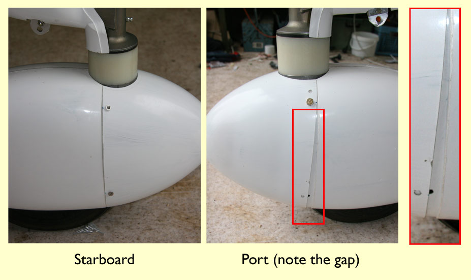

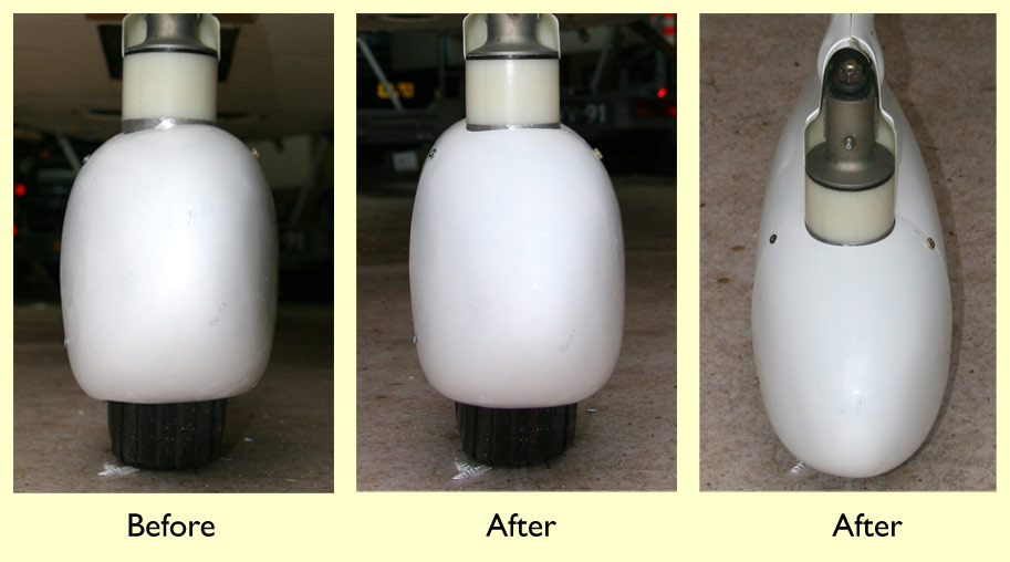

By coincidence, I found the secret!
Actually, it is very simple to get these things straight. The ONLY thing
you need to do, is to leave a gap on the bottom of the port flange. This
will make the fairing straight, viewed from all angles! No heating
necessary, no cutting needed at the bottom, no filling at the top, nothing.
The only thing you will have to do is to extend the port flange a little
bit to attach the bottom anchor nut, and use some expancel to fill the gap.
It seems that the only error the factory made was to cut the port side
of the front half at the wrong angle.
About the pictures:
Keep in mind that this is preliminary fitting. Even the anchor nuts are
not attached, the bolts are just inserted through the holes to keep
everything temporary in place. (Should have used cleco's for this, but I
already drilled the holes before I discovered that these fairings are
wonky).

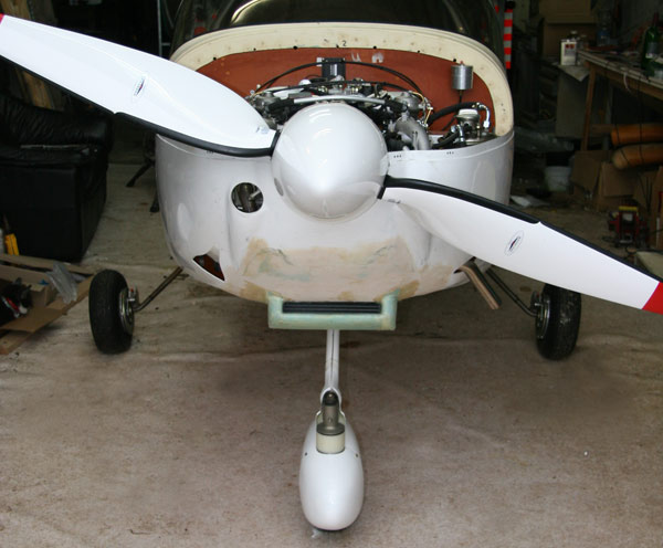

The white shaft you see is my 2 inch nose wheel shaft extension, to
allow for a larger prop. The metal ring you see just above the wheel
spat is the fork, and is very usefull to provide a straight reference.
Then, for the folks curious about my nose wheel shaft extension, cowling
mod, and prop, a picture of the entire nose section. Again, this is far
from finished, but gives an idea how it will look like when all is finished.

PostPosted: Fri May 15, 2009 12:54 pm    Post subject: Tri-gear wheel fairing Reply with quote
ALAN YERLY wrote:
Looks great, I never thought of that Frans, looks fast and easy.
I didn't think of that as well. I was just wondering whether I could
force the front half somewhat in the correct direction. To do this, I
attached the starboard side of the front half fairing to the rear half
of the fairing, to be able to bend the port side, and then discovered
that I could get the correct shape, without any bending, but at the cost
of creating a gap at the port seal. If you try to close this gap, the
fairing twists and takes its odd shape again. Leave it alone, and all is
right.
I love to think out solutions, but this one is really a coincidence, not
the result of thinking.
Next time you prepare a speed kit, try it, and let me know if it works
out the same for you.

Most of the time in a situation like yours, I add glass to the front cover gap, tape it in place on the rear pant where it looks good and fits without flexing (with release tape of course) and allow to cure to fill the gaps. Then sand and fill.
Having made my own entire speed kit, I disagree with your point on being a bargain. Although the nose gear pant is wonky, the gear leg covers are finiky, try making them from scratch or even buying from a third party. It takes me a half day per 5 day week to mold my pants, and wing covers. Gear legs and covers take another two days. Yes they are very nice, but then I have to make the metal parts, get the fasteners and hardware together etc. It still takes 40 hours to do a nice job of alignment, fillets and transitions that allow full gear leg movement without cracking. I have about 60 hours into my set and I will not make another. I'll buy them. The mods to make them fit nicely is far easier. Try doing an RV speed kit sometime....Talk about frustrating.
It is always about life being too short and time is money isn't it.
