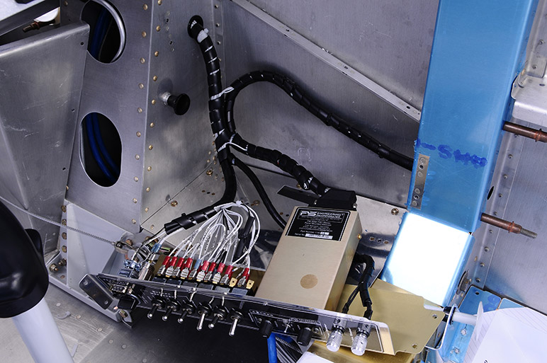

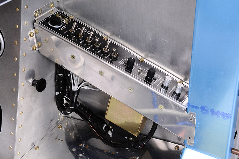

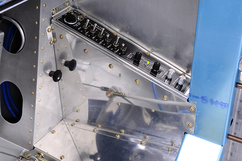

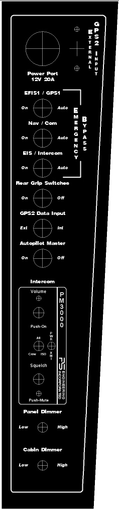

Hi Robin,
I didn't "expand" on the surface area available on the right hand console
of the RV-8, but I did make pretty good use of what is available. Attached
are a few pictures of what I've got. The Vertical Power VP-200 does most
of the Switching and Circuit breaker leg work, so I really only needed to
add switches for the Emergency Bypass functionality giving me redundant
connections to the battery if the VP-200 fails in flight. I also added a kill
switch for the Auto Pilot and Rear Grip switches.
If you guys haven't checked out the Vertical Power systems, I would
highly recommend you give them a look. http://www.verticalpower.com/
Very nice system that greatly simplifies the wiring installation.
Exceptionally high quality product and support. A+

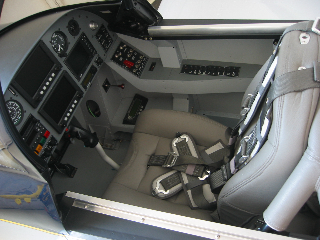

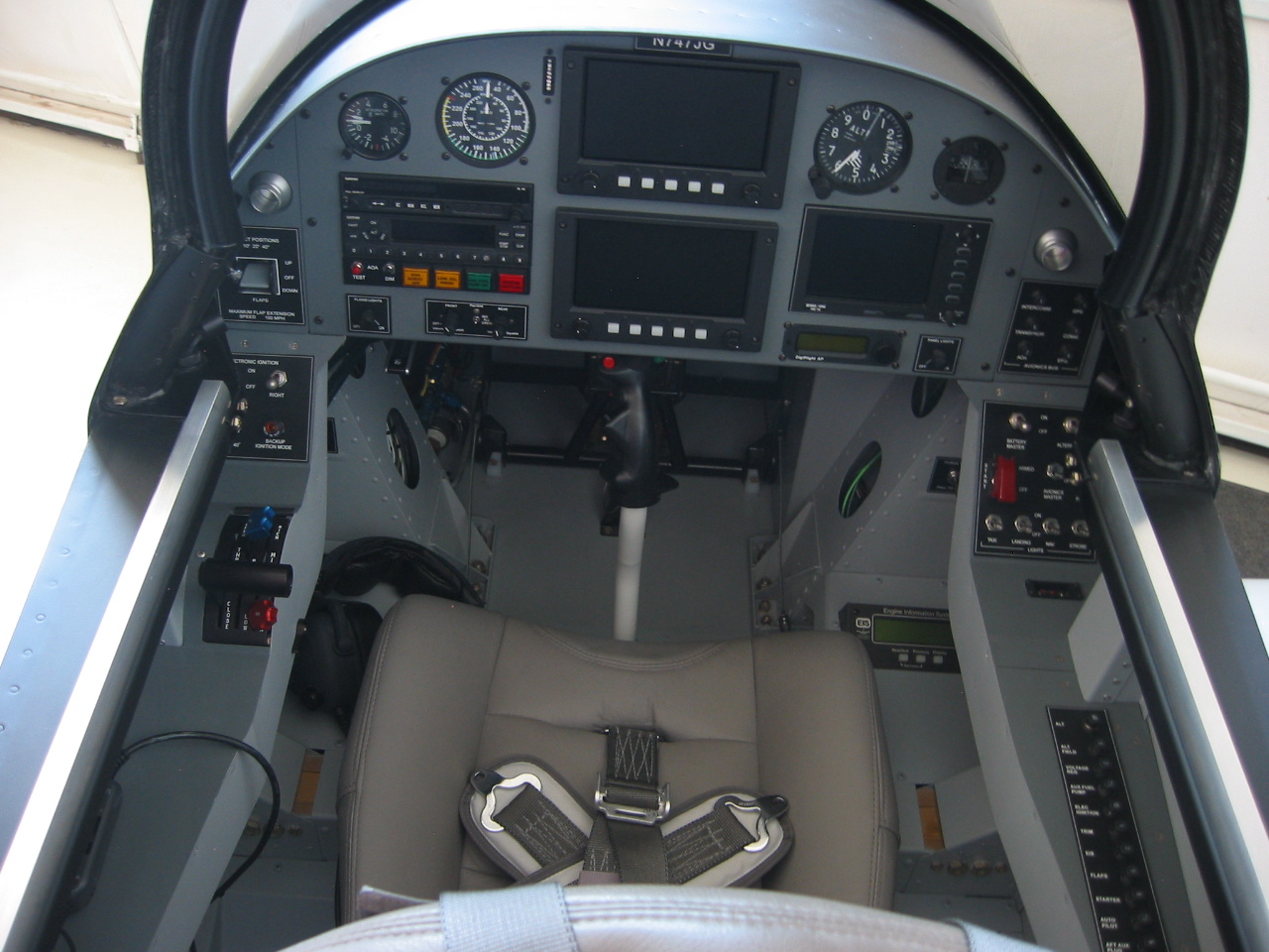

Robin, I have lots of pictures of side consoles in my RV-8 (and a few
opinions on what should go where, ha). After 75 hours of flight
time, I have no complaints at all about placement, maintainability, or
operation of any of the switches, etc. If you would like more
pictures of construction, or information, let me know.
