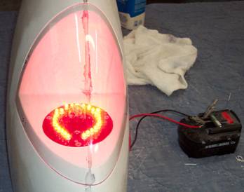

PostPosted: Thu May 07, 2009 7:30 pm    Post subject: Lights Reply with quote
They are a heck of a lot brighter that the traditional Nav/Strobe combination like these:
<![endif]--><![if !vml]>[img]cid:image001.jpg(at)01C9CF52.6E9ED260[/img]<![endif]>
Robin
