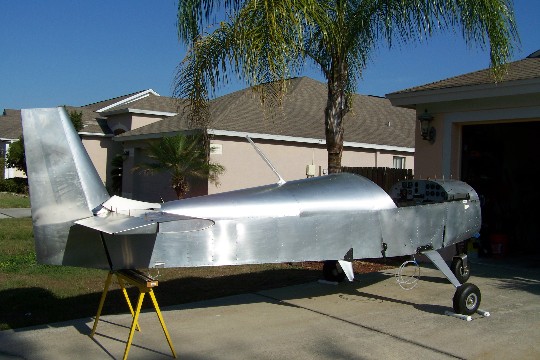

This is a great and encouraging thread. Lets keep it going.
I rolled her outside to day to see her in the Florida sun.
http://www.geocities.com/pdn8r/Outside.jpg

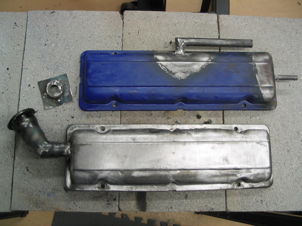

I learned how to weld, and then modified my Corvair valve covers, and made a firewall pass-through for the fuel line.
I'll clean these up tomorrow, and if I'm happy with how they turn out I'll paint them and install them. If I don't like them I know I can fix them.

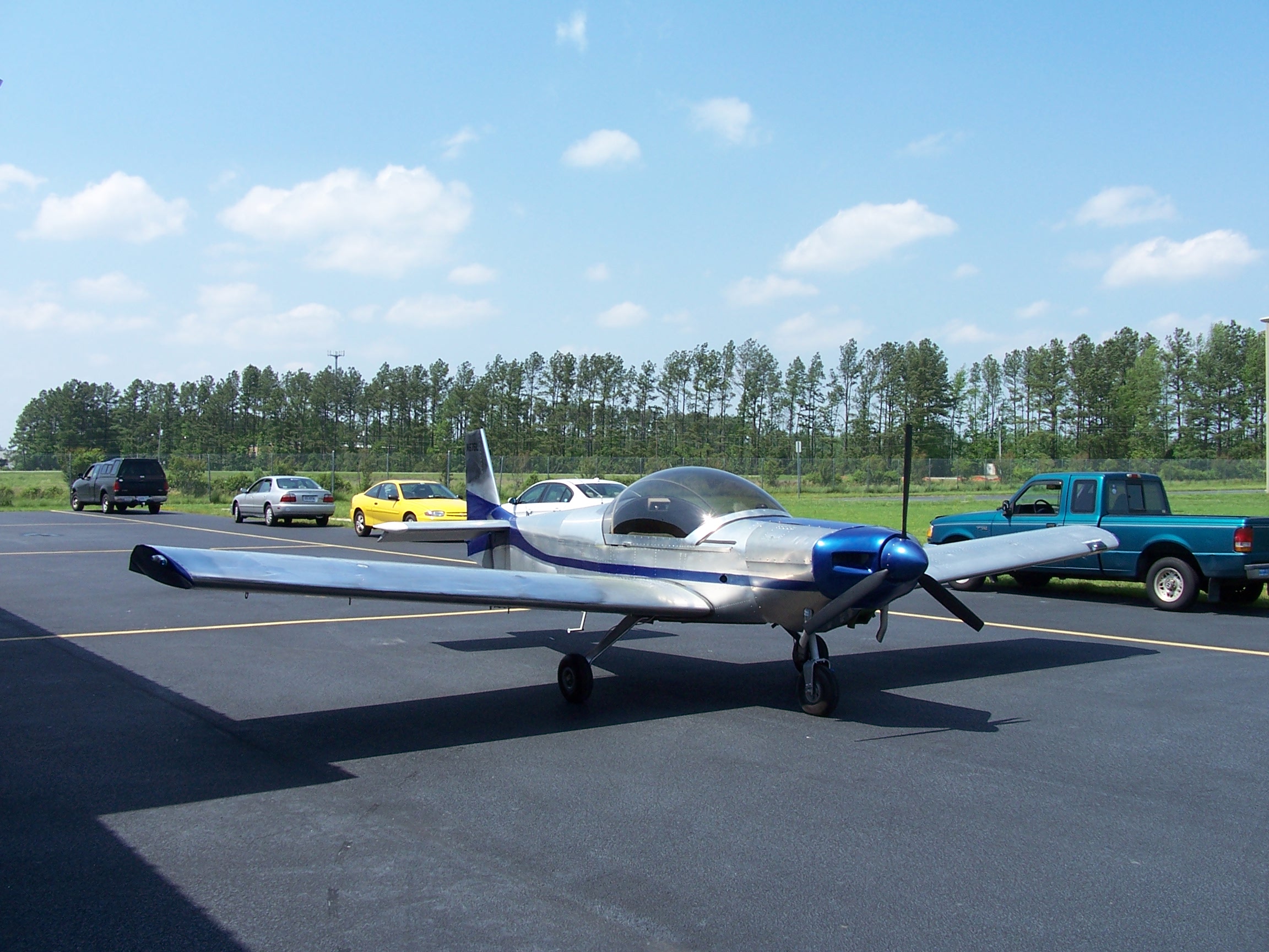

I secured the air hoses inside the cowling and put everything back together and then taxied around the airport. I have an inspection lined up in three weeks
