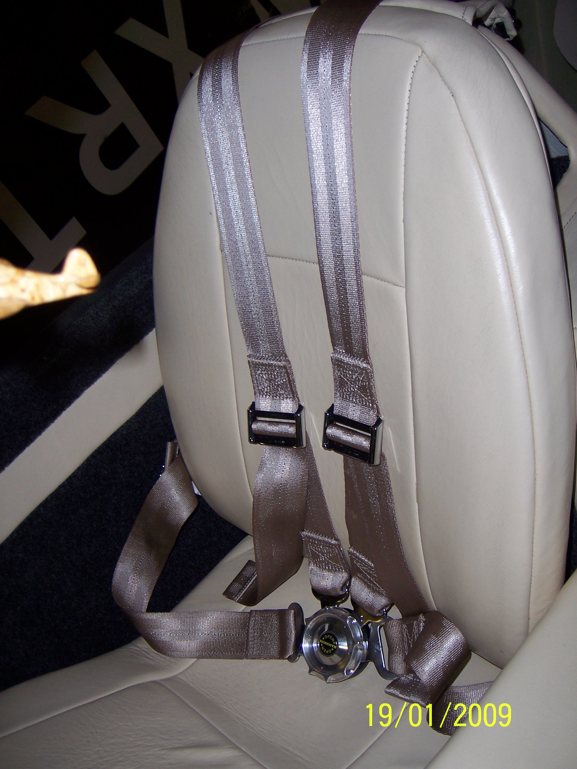

All who use or are going to use Europa original seat belts
There is also one another (one is the potential hip hit in accident) safety problem with Europa-type belts and installation:
They form a fixed loop around your shoulders.
In the case of accident if you are upsidedown it is hard or even impossible to escape.
That may be very difficult even in a car with just an ordinary three point seat belts.
Think:
- after ditching or any bad landing you may be upside down. What kind of last moments you have before drowning or burning or starving if you cannot escape because of unlockable safety belts?
After certain this category fatal accidents those type "loop" belts have been illegal and strictly forbidden in Finland since 2001. That order is also valid for experimentals and ultralights.
I do not know the actual situation in other countries.
That is why I have German made Schroth TSo belts with central lock and four fully separate laps.
I wish you all have anyway minimum a lap knife in a practical place near by.
I hope nobody will suck a pea into her/his nose because of my message!
Wishes, Raimo OH-XRT
PS: I have one free free set of Europa belts for anyone but they are definetely not for aviation use!
