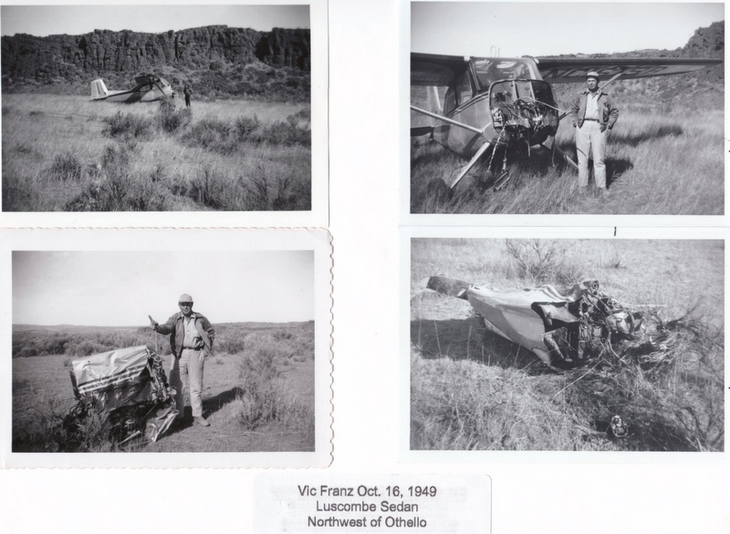

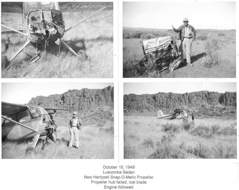

In the case of my Uncle Vic's propeller, the original factory prop was a composite and
it is not the one that failed. He ordered a newly designed Hartzell which was either a
fully pitch adjustable in-flight propeller or a two speed deal. The upgrade used all
metal blades and it is thought that the all-metal heavier blades were the cause of the
hub failure. The details of this propeller aren't clear to me. I believe the original
composite propeller was a wood composite rather than the modern day carbon fiber
plastic composites. The original factory propeller was not the one that failed. In
another photo of that airplane before that fateful Sunday afternoon it looks like a
wood prop to me.
Unfortunately when I did the posting on the forum interface, I posted the original
scans my uncle Vic sent me rather than the rotated and resized ones. I have attached
the little buggers to this e-mail.

I did. I have some more photos of that plane I'll send to Derek and I'll let Vic know
who owns that airplane now. There was a time after Vic last knew the owners in TX that
the plane was listed as "salvage" in the registration so might be interesting what
happened. Vic said it was a bit squirrelly on rollout compared to the C170 and some
other tail draggers he owned.
