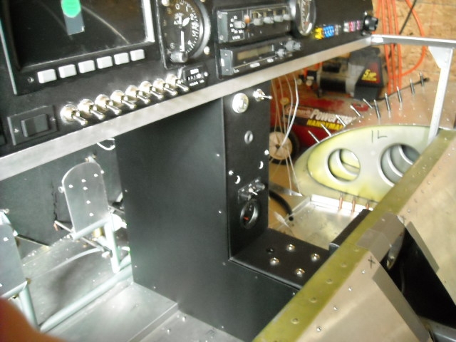

PostPosted: Sat May 02, 2009 7:17 am    Post subject: What did you make today? Reply with quote
Pat and all-
I'm making the final electrical connections with the panel in place
before putting in the battery and powering everything up. It worked on the
bench. Famous last words.
1. I got the Homebuilders Help glass panel DVD after I was half-way
through doing it the hard way. In retrospect, Mark's way will save you a ton
of time. Check it out.
2. You can cut any size hole you need for the panel with a H/F - SKU
P37370 fly cutter, but you have to use a drill press and wood backing. The
main problem with the off the shelf tool is that the setscrews are garbage.
Replace them with decently hardened ones and you'll get good results for
about a $15 outlay.
3. I was pleasantly surprised to find that Radio Shack stocks .093 Molex
connectors. Type in "Molex connector" and you get nada. In desperation, type
in "Terminals" and on pages 6, 7, and 8 of the online catalog you'll find a
batch of really tasty connectors, cheap.
Picture of my console attached. Not everything is firmly screwed down
yet, which accounts for the warpage. I highly recommend Jeff Small's
suggestion to add a chunk of 3/4" extruded L to the bottom of the panel. It
really firms up the slab of Jello you're trying to work with.
To paraphase the old saying, "I'm not a fast builder, I'm not a slow
builder. I'm a half-fast builder".
It seems the list is a lot happier when it thinks positively.
Bill
 Filesize:  176.6 KB
 Viewed:  20435 Time(s)

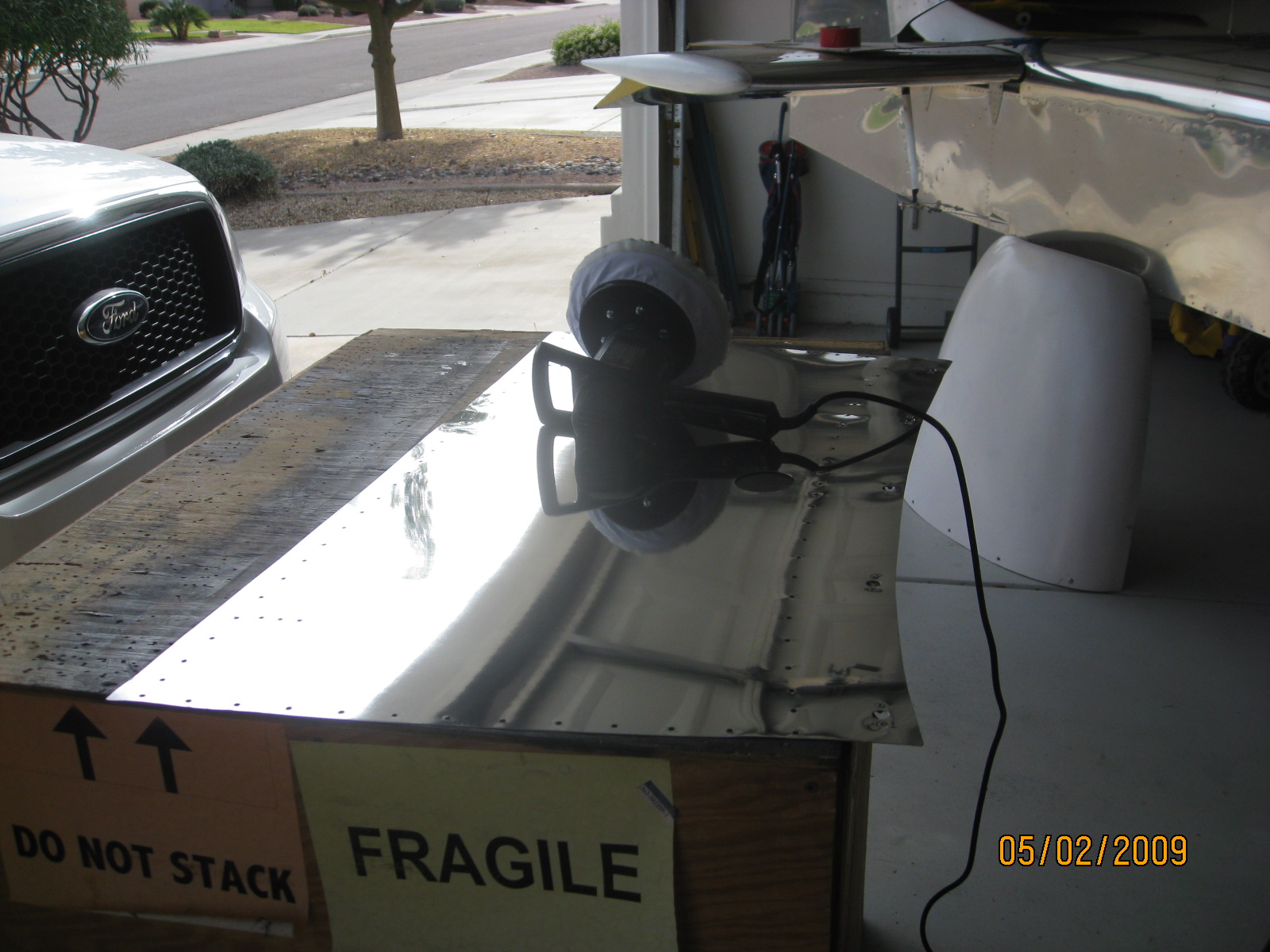

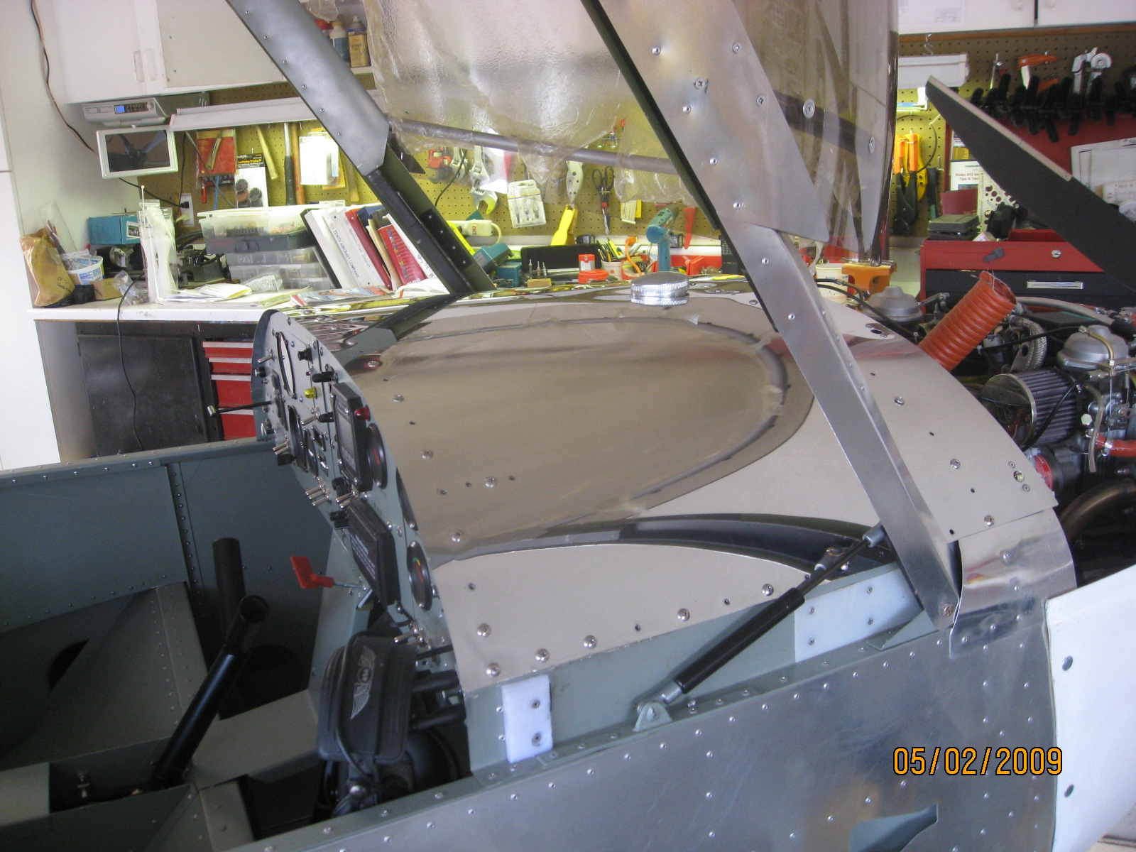

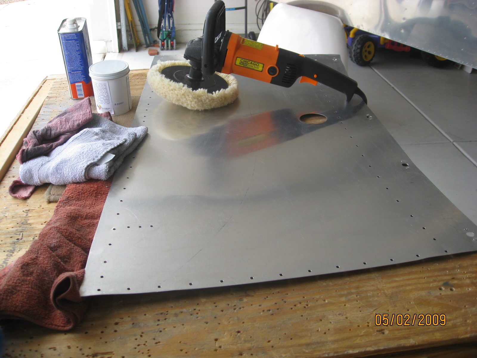

PostPosted: Sat May 02, 2009 4:50 pm    Post subject: What did you make today? Reply with quote
Well I got my Nuvite aluminum polish today and had my front nose skin off while doing some work behind the panel so I thought I would polish it. See before and after photos.
I also finally got around to reserving my N number. (316JL)
Jerry
 Filesize:  432.09 KB
 Viewed:  20394 Time(s)

PostPosted: Sat May 02, 2009 5:11 pm    Post subject: What did you make today? Reply with quote
That looks good, but it's a shame that, eventually, you will want to
paint about half to that piece flat black. The glare from the part of
that nose skin that ends up under the canopy will be intolerable
otherwise.

PostPosted: Sat May 02, 2009 6:04 pm    Post subject: What did you make today? Reply with quote
Brian
Thanks. I plan on painting it tomorrow. I thought it would be easier to polish the whole thing prior to painting. I needed to work out my polishing process on something easy.
Jerry

naumuk(at)windstream.net
PostPosted: Sat May 02, 2009 7:26 pm    Post subject: What did you make today? Reply with quote
Jerry-
How long did it take you, and what grade did you use? I use F9 for the
rough cut and it still takes me forever.
Bill
jlatimer1(at)cox.net
PostPosted: Sat May 02, 2009 8:39 pm    Post subject: What did you make today? Reply with quote
Bill,
It took about 1.5 hrs to do the top skin.
I did 4 passes with F9, 2 passes with C, and 1 pass with S. I used a Harbor Freight polisher with Nuvite wool bonnet for the F09, the HF polisher with HF wool bonnet for the C, and an orbital polisher with a cotton bonnet for the S.
Each pass got easier and less polish was used with each pass. It actually took less time than I expected.
Jerry

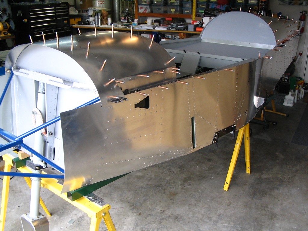

PostPosted: Sun May 03, 2009 7:19 am    Post subject: Re: What did you make today? Reply with quote
This is a great thread, because it gets us back to the reason we all joined this list.
I finally made my way through most of those 9,200 rivets. Yesterday I pulled my last fuselage rivet, and even managed to climb in the cockpit to make some inaugural inviso-engine noises. The pictures tell the story. Keep on building, guys.
 Filesize:  164.19 KB
 Viewed:  20347 Time(s)
 Filesize:  182.01 KB
 Viewed:  20348 Time(s)
