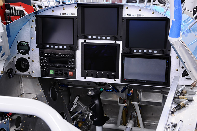

Greetings,
Since all of the panel and internal wiring is done, I thought I do a "System Off" current draw check today. There is a "keep alive" buss coming off the VP-200 system that I have connected the GRT HX displays to as well as the Kenwood DNX8120 and a couple of other things. I've currently got the standard Concord 25RG-XC battery that Van's sells. With the VP-200 system "off", I'm measuring about 6ma of constant current draw.
My question is, how long is the standard battery going to last with this amount of draw?
Also, is the Concord 25RG-XC the best choice for batteries? I've got an IO-390 and the battery is mounted in the back of the my RV-8. Is this battery going to have the staying power to support the electronics I've got as well as crank the engine?
Thanks in advance for the advice.

Absolutely stunning panel. Of course, I could support all my flying
habits just on the interest on the money it must have cost. Smile

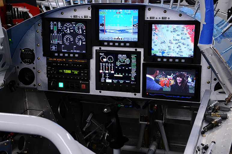

I see some space left on the panel that is not being used. What a waste!
I can imagine his radio transmissions:
Center: descend and maintain 7 thousand. Turn right heading 320 degrees. Contact approach control on 126.65.
Matt: Center, can you wait until the commercial? I do not want to miss this
good part on TV. Laughing

PS - And, btw, I'm saving that little space on the right hand side of the panel for an analog HOBBS meter. NOT. Wink
