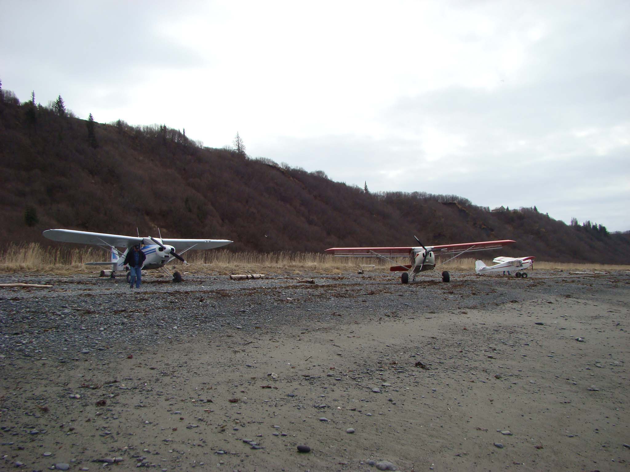

PostPosted: Wed Apr 29, 2009 5:08 am    Post subject: Re: VG generators Reply with quote
We were out playing on the beach a couple days ago. The KF did a lowell approach, mine was more of a clint approach. The cross wind did not make for ideal use of full flaps, but you will get the idea.
http://www.youtube.com/watch?v=3bddee4CSqg
