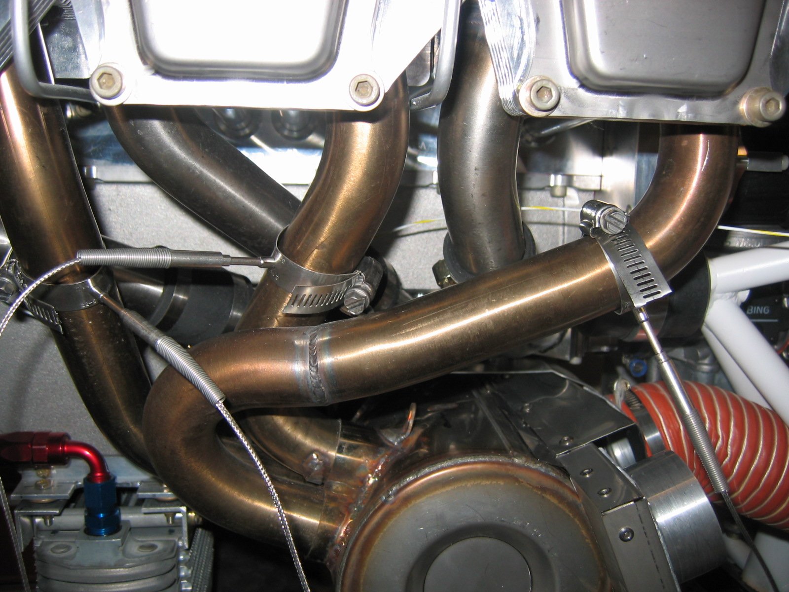

Ok I'm Stumped
The manual says to install the EGT Probe 100mm from the flange
Since the pipe is curved where am I making this measurement?
Anyone got any insight or a pic to help a feller out??

Stick the measuring tape up alongside the pipe all the way up to the flange then measure along the center of the side of the pipe around the curve to the 100mm point. Don't measure the outside radius of the bend or the inside... go halfway between the two and measure along that line. The measurement is not critical but getting all the sensors nearly the same is important. Does that help?

How about taking a piece of single strand heavy wiring (maybe 10AWG) and
cutting a pie 100mm long. Then place it on a side of the pipe midway
between the inside and outside bend (does that make sense? Someone else
said about the same thing.) Voila!!! exactly 100mm from wherever you
measured. Worked here. Coat hanger wire would work too.

The installation manual I have, dated 2006, says 100mm is the distance to use for the EGT probe palcement. The Jabiru engine tuning Service Bulletin JSB018-1, dated October, 2007, says to use 120mm. I don't have my Oshkosh notes with me, but I remember Pete K. saying in the Jabiru forum there that 120mm was the new recommended location. I used 120mm on my installation.
