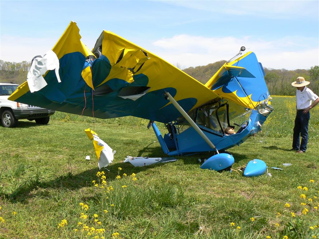

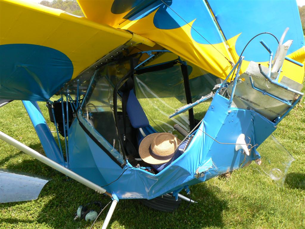

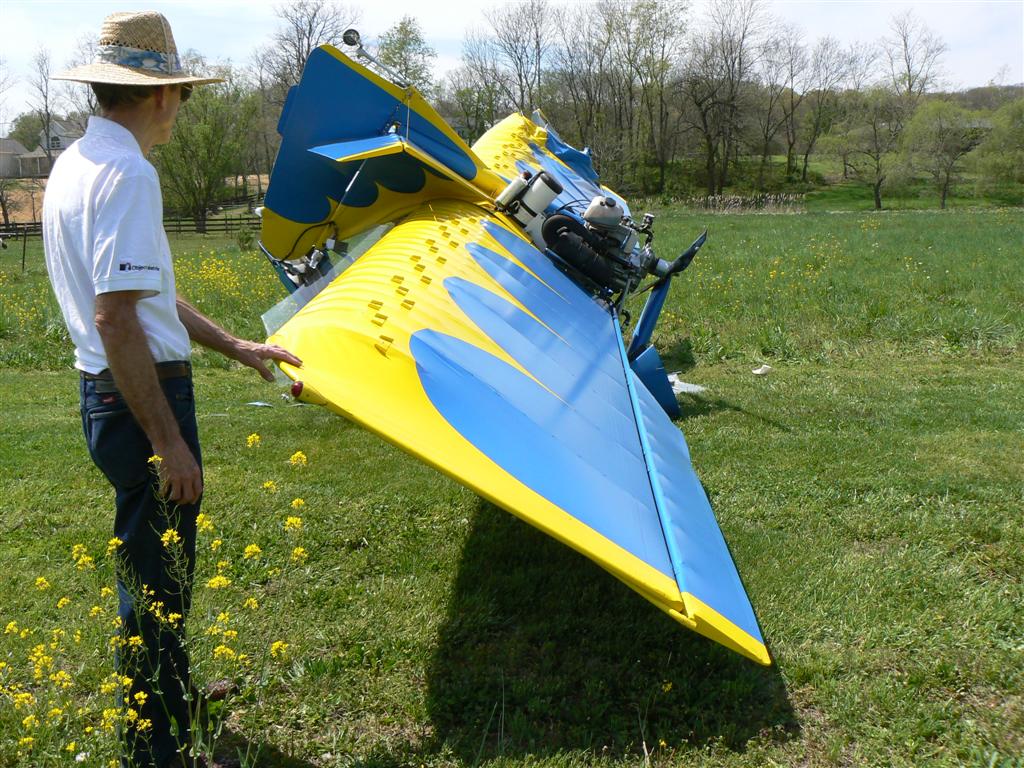

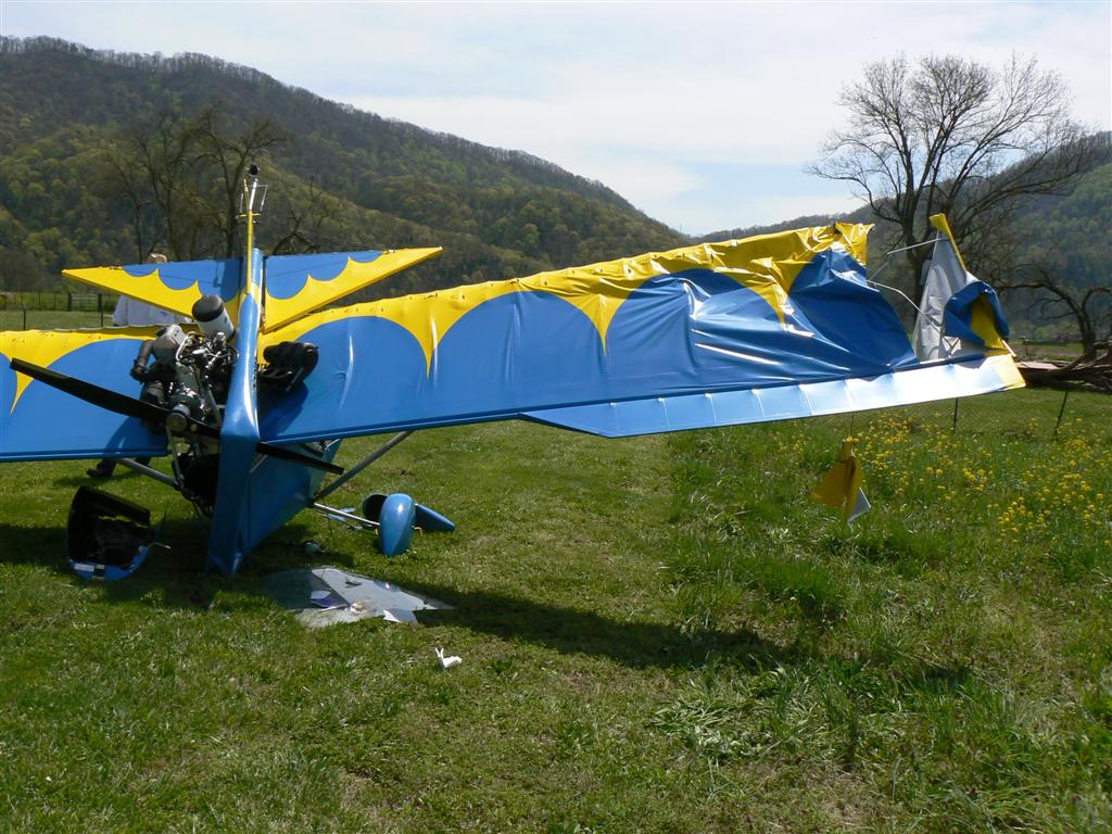

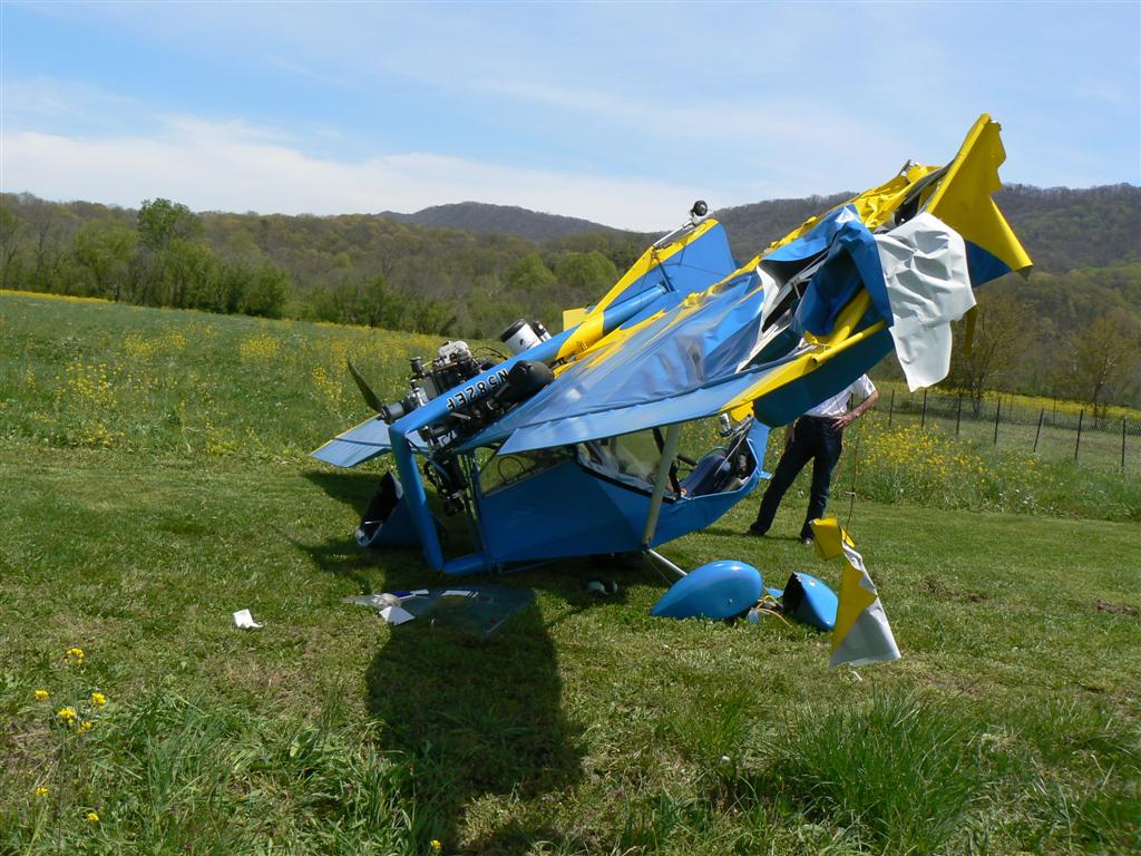

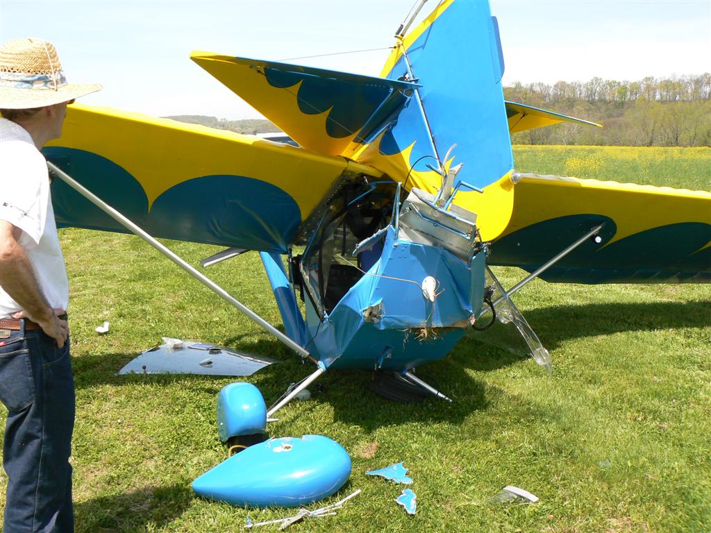

Ed is doing pretty well and will probably have surgery today to set his leg bones in place if the swelling in his leg has gone down enough.
All of us have heard the phrase "He rolled it up into a ball?" Well, this is how a Kolb looks when you do that: notice the integrity of the main cockpit area.
And yes - it is rebuildable and we do plan to rebuild it.

PS: Over the years most everybody - including me- have taken for granted the comparative fragility of Ivoprops. Uh - notice what the tail boom is wrapped around... Currently the prop is the only airworthy thing on the airplane - go figure.

Amazing pics. Steel cages are good!

Ed's crash looks a lot worse than mine. I hope he is resting comfortably, and heals up okay. Give him my best wishes. Yes, it does look re-buildable. Mostly, lots of labor.
"Before" photo's are at www.bcchapel.org/pages/0003/kolb.htm
The comments about the steel cage are correct- mine folded about the same way. I barked my shins on the instrument panel, but no other leg damage. I think if I was 20 years younger I wouldn't have taken the back and neck damage (no discs prior to the accident). How old is Ed?

Inquiring minds want to know. How did the tail get rapped up over the top? I
looks like the left wheel might have caught the fence flipping the plane
over on the right wing but that doesn't explain how the boom tube got rapped
up that way. Did the plane get turned around back wards right side up in the
air then landed going backwards?? Any way it must have been a wild ride that
last few seconds. Thankfully he wasn't killed.

Some photos. I don't understand how he could have wrapped the tail boom
around the wing. It all most looks like it was was rolled over backwards.
This does not seem likely if one caught the tail wheel on a fence. Is this
after crash damage? Can you fill in the mechanics of the crash?

Looks like the main gear caught the fence plunging the nose into the ground. The forward momentum carried the tail over the top as the cage was springing the fusalage back up in the air. A forward flip it came back down on the tail as the fusalage was still going forward through the air over the tail. My understanding was that when help arrived the fusalage was upside down and not as seen in the pics.

FWIW - if the fuselage were indeed upside-down when found, it's one
thing.
I suspect the tail caught the fence, it bent the boom tube upwards,
then the nose dug in, and then the boom tube folded up again and
came to rest as in the pix.
If the plane were moved before the pix, another theorem. A forward
roll does change things.
Russ K

Probably should have put this in the original post, but just to help resolve the speculation - There was apparently a wind shear caused both by the local terrain and by a thermal cooking off, but either way - there was a sharp airpseed decay, the tailwheel hit the ground on the wrong side of the fence, but the mains cleared. (Love those VG's...)
Hit the fence with the tailwheel, flipped it nose low, hit the grass with the left main first. The fitting where the landing gear leg attaches to the axle broke, the wheel came off, and the gear leg dug in. (Tongue in cheek comment follows:) That was not helpful. (I WILL be talking this over with Travis) When we put it back together, the new fitting will get gusseted. I am also planning to gusset the fitting on my MKIII if it is similar. Fool me once, etc...
With the wheel gone off the end of the left gear leg, the leg dug in, and that is probably when the nose hit. Then, as the airplane was spinning around the left gear leg, I think the tail hit next, the airplane having turned 180 degrees and is now going backwards, the tail hit, and the boom folded, and now the airplane rolled up the boom, ending up inverted, with the empennage wrapped around the gap seal. Not sure when or how the right wing was destroyed. Maybe it hit as the airplane spun 180 degrees. Strangest of all, the Ivoprop emerged unscathed! (weird...)
Ed is in good spirits, already discussing how we will put it back together, looks like his surgery is now set back a couple of weeks, situation unsure. We are praying for good healing.
It will take a while to put the FSII back together, but we are already committed to putting it back together with a goal of 50 pounds lighter, (It was porky, too many bells and whistles) stronger, and better than before. This is all just a speed bump on the road of life. Guys build things. (because God builds things, we imitate Him, we build things) Because we live in a fallen world, we tear stuff up, then we fix it and go on, then we tear it up, and fix it again, and go on. We are guys, that's what we do. Ed and I have talked it over, and it gives us something good to do. Not what we had planned, but so what? Keeps us out of worse mischief...

PostPosted: Wed Apr 22, 2009 3:17 am    Post subject: Kolb crash yesterday Reply with quote
This does not seem likely if one caught the tail wheel on a fence.>>
Hi Jack,
I thought that was strange. I did the same thing in a Kranich Glider many
years ago. It was like picking up the third wire with your arrestor hook. we
suddenly lost flying speed, then the fence broke and the glider just fell to
the ground and stood up on the front skid, almost flipped and then fell
back.
With a Kolb with maybe an undercarriage tube sticking into the ground it
could go either way.
Pat

Richard Pike- First, how is Ed doing? Was he wearing a four point belt, or a six point? The cage collapsed almost exactly like mine. I was only wearing a lap belt, and that was probably what broke my pelvis. I can see shoulder straps in the photos. Also, what broke Ed's leg- the nose cone? I had marks on my shins from the cone, but no breaks.
Any damage to the main engine mount tube? I can't tell from the photos.
Sounds like a common result. When my friends crashed in the MKIII, the
results were broken legs, ankle, and pelvis. Of course, they went in
straighter and harder than you or Ed did.
