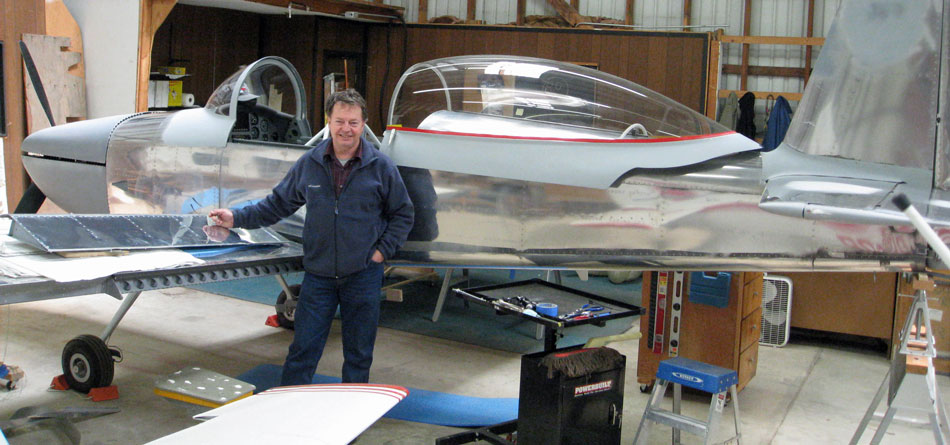

PostPosted: Thu Apr 23, 2009 5:11 pm    Post subject: -7: Hang the engine with fuselage still on a dolly? Reply with quote
Yes-Hanging the engine twice, mounting the gear legs twice, mounting the fuselage to the dolly twice...you get the idea.
Leave the fuselage as it is, raise the tail to level the fuselage (see pic), throw in a bunch of cushions (I like small plastic boat bumpers and cheap Wal-Mart blue camping matt foam) and move on. You could build a bench that runs the length of your fuselage as I did, but you may find, as I did, that a small ladder that you can easily move is more effective.
Even with the dolly, I doubt you will escape the extreme pleasure of being upside down, on your back with a flash light in your teeth, under the panel and trying to figure out a connector (or fitting) that is located right between the effective ranges of your bifocals.
Don't do any step in this project more than necessary!
My RV-8 a year ago
Vince H.
