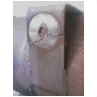

I don't know how many of you read the Rotax forum also, but if you do you'll remember that I have an exhaust leak. Here's the thread:
http://forums.matronics.com/viewtopic.php?t=55938
I first tried to simply replace the outside exhaust gaskets. That didn't stop the leak. So today I replaced the inside exhaust gaskets.
Since Lucien also mentioned checking the support and since I had been noticing lately that the rubber bushings on my exhaust mount were looking pretty worn AND since I had it all apart anyways to replace the inner exhaust gaskets (those were a challenge to scrape off the cowl), I decided to go ahead and take the mount apart and inspect it. Should have done that sooner! I attached a picture of what I found. The rubber bushings were useless and the bracket (or plate? whatever it's called) on the exhaust has cracked all the way through.

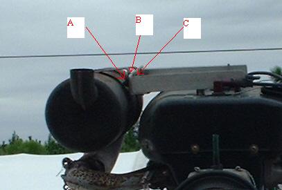

I've also attached a picture of my exhaust with the mount with some letters pointing to various places.
The male rubber bushing was currently where letter A is pointing (actually inside the exhaust bracket or plate).
The female rubber bushing was currently where letter C is pointing.
The people helping me say that the male bushing should be where letter B is pointing (between the exhaust bracket and the exhaust mount).
If it is currently set up wrong that might have further aggravated and caused the crack (besides the bushings being rotten).
I know there aren't many of you out there that have a 503 anymore and probably don't even have the same set up for the exhaust if you do have a 503, but if you have something similar could you please post a picture and/or diagram?
The CPS catalogue shows a mounting kit that uses a bolt-driven mounting clamp...does anyone use that?

Cristal, a couple of things I see in the pictures:
1) the reason it cracked is that you have the old style single-jointed muffler with one set of 3 springs. These older mufflers are prone to cracking.
2) it looks like the previous owner may have welded a washer to the muffler where it cracked. Maybe the weld job had the opposite effect and weakening it instead of making it stronger.

Yes, the rubber bushings should be on the muffler bracket and not on one
side of the muffler bracket and on half on the back side of the support
angle.
The cracked bracket could be contributed to the set up and also could just
be fair wear and tear from vibration.
I would suggest grinding the washer off the muffler bracket and welding an
1/8" thick plate the full length of the bracket where the washer is located
now. Just weld the sides of the muffler bracket, not across the top or
bottom as that will cause a stress point where the bracket bends.

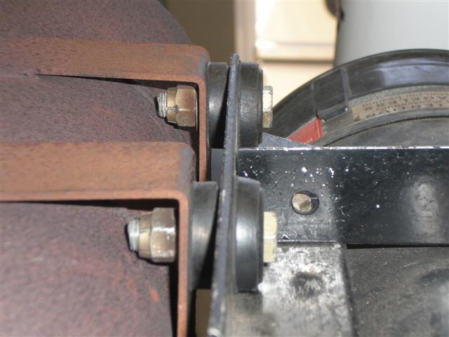

Know you've gotten lots of input since the posting..... but here's a picture of my set up on my FSII. (R503).
If you go with the recommended bushings from CPS, don't forget the backing washers.

It seems to me Jim H. has suggested the best way to repair the bracket. A TIG weld as he described should last a long time.
If you have the room on your support bracket C you might consider adding a duplicate bracket C while the muffler is being welded C anyway.
By distributing the vibration load between 2 mounting locations C you may not have a problem for a very long time.
Just an idea....

Thank you for the picture George. The more I think about it the
more I think perhaps me and my friends remembered incorrectly. I
wrote down everything I did as I took everything apart and laid
things out in order as I took them apart, but when I took this
piece apart it drew a lot of attention and I believe things may
have gotten out of order (physically and in our minds). From now
on I'll be taking pictures before I take things apart.
I have a friend of a friend welding it for me since I don't weld.
I'm sure he'll do a good job.
Thanks for everyone's input and help. Again if anyone has used
those barry mounts please let me know how it goes and what type/
size should be used. Otherwise I suppose I'll go with the male/
female rubber bushings I found in the CPS catalogue (with the
backing washers).

Private Pilot Aug 2008

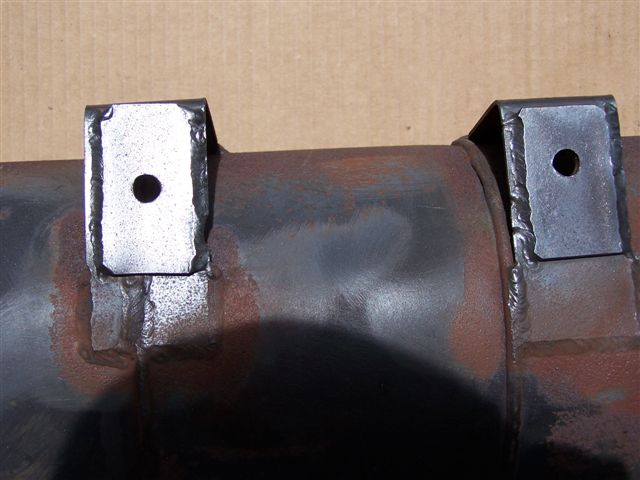

I got my muffler back from Jim Hauck this week. He reinforced the welding my friend did by adding an extra piece and welding the sides (you can see in the picture). Thanks again Jim!
I went to put everything back together today and discovered the bolts on the new rubber bushings I got from Travis were larger than the old ones. Luckily I had a friend around who had his drill handy and drilled the holes bigger. Then the nut was also bigger and wouldn't fit behind the bracket on one side where the muffler has that bump that sticks out all the way around it. So he banged that a little with a tool to bend that extra bend down so it wouldn't be in the way of the nut.
Then I went to put everything back together (this time by myself). It is difficult to hold the muffler up and put the bolts through the top of the engine/muffler mount by yourself. Then when I tried to line up the exhaust manifold allen bolts my INSIDE exhaust gaskets kept falling out of place. I tried three times (each time having to take everything apart again). The little tabs on the case that are supposed to hold the inside gaskets in place hold them fine when I have the case off (even shook it a little) but once I'm trying to line up the exhaust manifold to bolt it in those little boogers fall down. I suppose my tabs have worn down too much to hold them good. I want to put something on them to keep them in place but I don't want to use something that is going to be difficult or impossible to get off next time I have to change them out.
Dying to fly...it feels like it has been forever. Lots of people are stopping by our airport for free BBQ and a fillup on their way to Sun N Fun. It's great to see all the various planes but sure wish I was in the air with them! If I can get things running well I will fly to the Vidalia Air Show next weekend and line my Kolb up on the static display. That should be fun.

Cristal, use a little grease to hold nuts and bushings in place while you are readying to tighten them down. This job of putting on the muffler is tedious and frustrating as I have done this a few times myself. The muffler is heavy trying to hold it in place while the bushings stay in place. It sounds like you are just a few steps away before taking to the skies again.
You may want to tie the tail down with a nylon auto tow rope and wrap the other end around the front wheel of your car. Start the engine and run it up to full RPM for a minute to test things out before flying. It's much safer this way in case you missed something.
