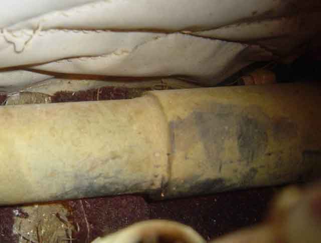

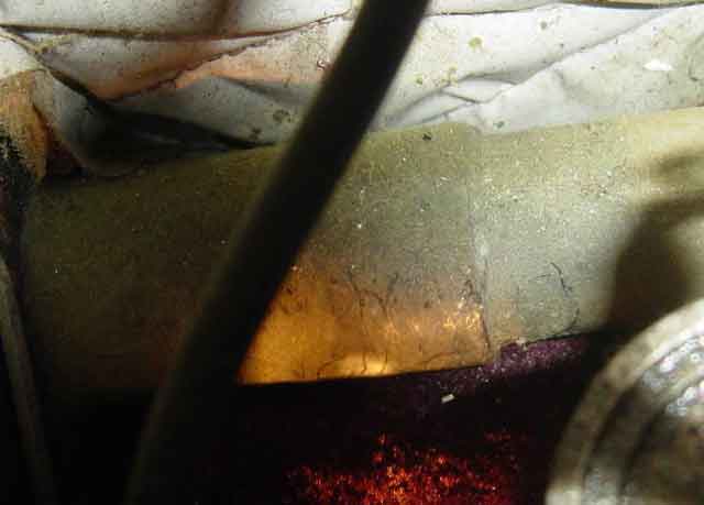

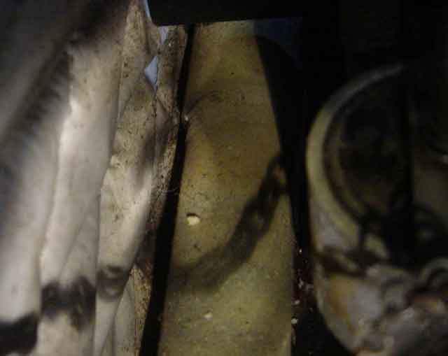

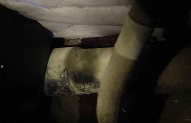

I crawled under the panel today to have a look at the torque tubes. The bonded joints definitely do not appear to be broken, and each side of the tube moves together. The squeaking appeared to be coming from the yoke area, between the rotating center of the torque tube and the bracket that holds it to the floor and firewall. After lubricating this joint, the squeaking went away. I think it is safe to say that the torque tube is fine.
I'm attaching a picture of each of the torque tube bonded junctions. Any comments would be appreciated. Thanks again for everyone's input on this.
I couldn't tell how the torque tube rotates in the firewall/floor bracket. The plane's annual is coming up next month, and we do have the service manual for the plane. Is there anything on that bracket that we should tell the shop to look at or lubricate?
Left Outboard Bonded Junction
 Filesize:  14.22 KB
 Viewed:  19267 Time(s)
Left Inboard Bonded Junction
 Filesize:  11.69 KB
Right Inboard Bonded Junction
 Filesize:  6.91 KB
Right Outboard Bonded Junction
 Filesize:  12.47 KB

I should probably add that the nose gear boot was torn, which could've let some moisture in right on the bracket/torque tube in question. A new boot is on the way.

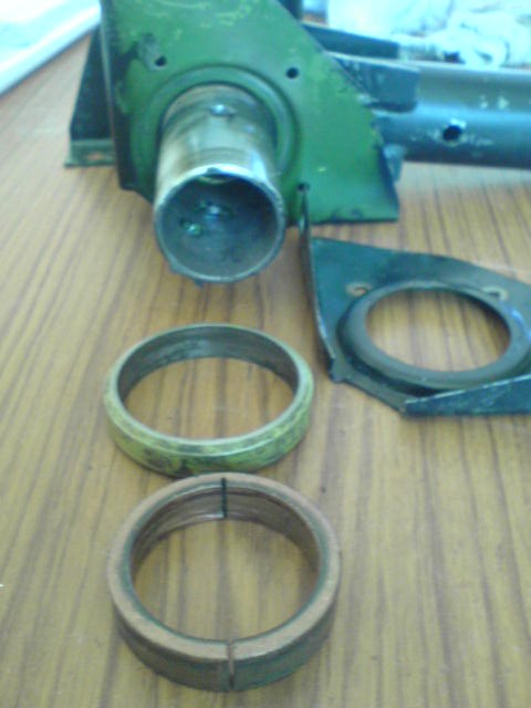

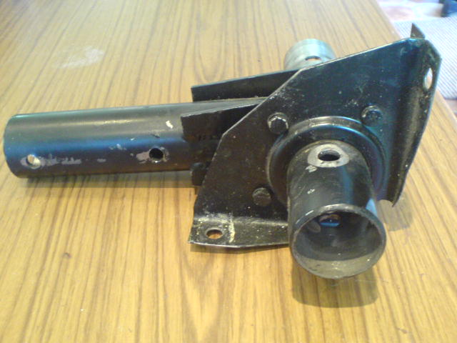

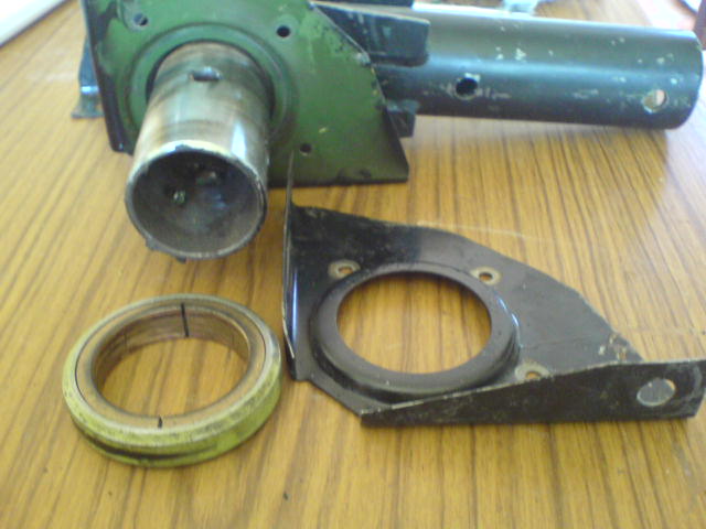

The only free moving parts in the torque tube is within the firewall/floor bracket. Held between the two halves of that bracket is a steel collar which holds a bronze split bearing p/n 702058-6. (part 31 in the picture shown on the forum site) When the torque tube twists under loads exerted to the nose leg attached to the torque tube yoke, the tube yoke section rotates within that bronze bearing. Although the steel collar is held tight within the two halves of the centre brackets, if the friction between the bearing and yoke become too tight, there is nothing to stop that collar trying to rotate within the bracket which may also cause squeaking. Why the parts book call out that p/n for the bearing I don’t know because it is not a replaceable/servicebale item. The only way to replace it is to remove the torque tube from the plane and debond/unbolt the end caps of the tube.
I assume by lubricating you may mean spraying so may be that has penetrated within and between the bearing and tube and helped some what.
For pictures of a broken down split bearing follow the “Read this topic online here” link below.
Comlplete split bearing breakdown
 Filesize:  47.36 KB
 Viewed:  19233 Time(s)
Bracket disassembled and steel collar removed with split bearing witin
 Filesize:  47.22 KB
Torque Tube Yoke
 Filesize:  48.49 KB

Here are some direct links to the bonded tubes if anyone still wants to look at them (see the end of my message). I don't think broken bonds are the problem though. I think it was just the bronze split bearing referenced by Ian. When I lubricated that area with some light silicone lubricant, the squeaking went away. I think some moisture had entered the area through a torn nose gear boot...I flew the plane about six hours then it sat outside overnight in a rain shower immediately before the squeaking started. The annual is about a month away, so we'll be replacing the boot, and maybe adding some lubricant to that bearing, although I'm not sure what the proper lubricant would be. I'd say we're really just trying to prevent corrosion there more than lubricating. Would something like LPS-3 be good for this?
Thanks again for the help everyone...this is a great list!
