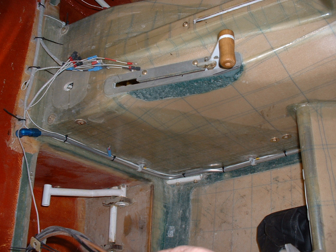

the neatest installation I have seen is Bryan Fogg's. Going throuhg the
stainless firewall is messy and stainless steel tends to cut things, not
good imho.
Graham

PostPosted: Sun Apr 12, 2009 7:06 am    Post subject: Fuel lines routing through firewall - monowheel Reply with quote
Hi Jean-Paul I did a similar routing to the pix Graham sent of Bryan Fogg's install.I am using Aeroquip 666 hose.http://www.europaowners.org/modules.php?set_albumName=album227&op=modload&name=gallery&file=index&include=view_album.phpIt is in a XS with 914 with both long and short.914 pumps and gasculators aft.http://www.europaowners.org/modules.php?set_albumName=album231&op=modload&name=gallery&file=index&include=view_album.phpRon Parigoris [quote][b]

PostPosted: Sun Apr 12, 2009 8:19 am    Post subject: Fuel lines routing through firewall - monowheel Reply with quote
good imho.
But if there develops a leak for whatever reason, whether in flight or
after a crash landing, you are sitting with your feets in a bath tub.
Not good imho too.
