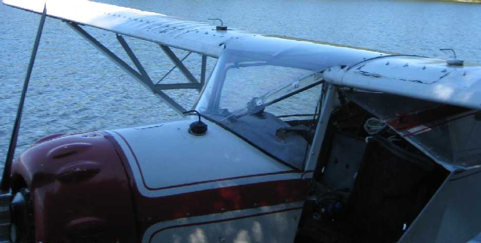

PostPosted: Tue Apr 07, 2009 11:32 am    Post subject: fuel tank venting Reply with quote
You have a pitot on your dash tank cap? Is it the kind of cap that is above
the cowling and you can fill without taking the cowling off? Mine is. I've
seen some fillers under the cowling and I agree a pitot might help that. I
know you have lots of pix - does any show a dash tank with pitot?
Attached is a picture of mine - notice the cap is tilted into the wind. I
also have had no problems with it the was it is, though not nearly as many
hours!
Bob
dave
Joined: 22 Sep 2006
Posts: 1382
PostPosted: Tue Apr 07, 2009 3:38 pm    Post subject: Re: fuel tank venting Reply with quote
All 3 Pitot tubes for you Bob. btw I never saw an attachment from you. ?
Kitfox IV on floats Pitot tubes

Lloyd,
My poly tank has no vent built into it but I think you need to have a vent somewhere or you could starve for gas. I have a shut off for each with tank so if they both shut off I have no venting at all on dash tank.
So it seems necessary to have a vent and in my case the pitot serves the purpose.
Dave
