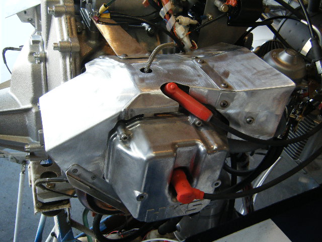

Jerry from Green Sky AV. sent me a pair of alum air scoops, that someone had made for an earlier model of HKS, to try to see if I could reduce the temps without moving the oil cooler. With the muffler and oil cooler on top of the Firestar wings the air is disrupted enough that the temps on the engine are way too high, bumping redline at anything over 5300 RPM's.
I am pleased to report that they worked just fine. I was able to use the engine as I wished without regard to overheating for the first time.
Results of the test are (at) 43 degrees OAT. (at) 5350 RPM - 286 degrees. (at) 5750 RPM 304 degrees. (at) 6150 RPM- 304 degrees. I currently have 21 hours on the engine.
I flew for one hour and 12 minutes, total of one hour and 24 minutes counting warm up and burned 4 gallons of fuel. 91 Octane mogas.
This is a reduction of 40 degrees through the entire range of operation. I can live with that.

Not unlike the scoops used on the Jabiru's on Titan airframes... Herb
