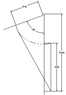

I have some information now. Pictures later. First is the geometry. Note that my struts are at the back of the door. The upper attachment is 5.16" out the door, the lower is 13.66" down the frame tube. (Both measured from the pivot centerline.) The strut centerline is offset 1 5/16" from the tube's centerlines. The gas strut is 8.5" long closed, 12" long fully extended, with a 4" throw.

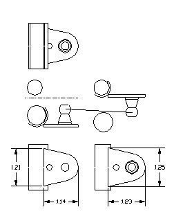

These are drawings of my strut attachments. I bought the tabs and balls from Guden and welded them to pieces of tube which were then pop-riveted to the airframe and door frame. The pictures show the tabs and struts bought from Guden.
