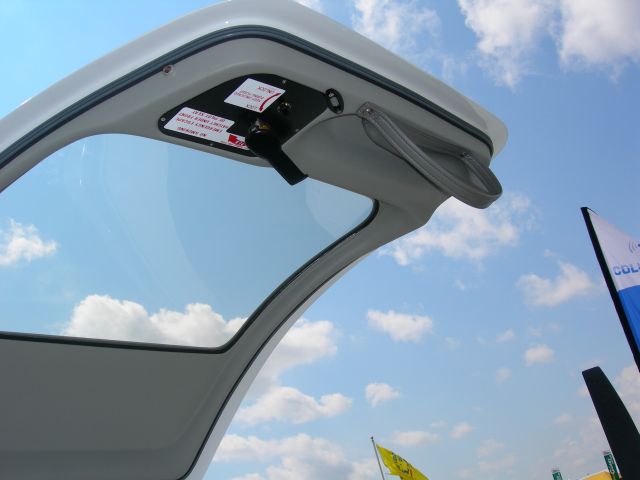

PostPosted: Wed Mar 25, 2009 3:54 am    Post subject: Baggage Area & Door Straps Reply with quote
I always liked the way the Columbia has its door strap attached. I will do something similar on my doors. Probably using a nylon strap, like that found on luggage. I may wrap the strap in my interior fabric. Attached is a photo of the Columbia door strap.
Larry Rosen

bkbrown(at)minetfiber.com
PostPosted: Wed Mar 25, 2009 6:52 am    Post subject: Baggage Area & Door Straps Reply with quote
That’s exactly what I described…tubular nylon webbing, sewn and upholstered to match your plane, attached at hardpoints.
