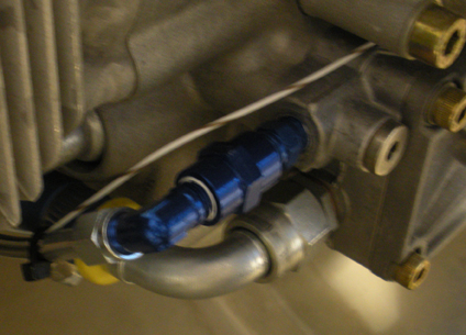

Hello Kitfoxers,
Does anybody have a part number for an oil fitting that screws into the oil intake side (oil pump inlet) of the Rotax 912, and the other thread end goes to an Earl's fitting? I have one from an auto parts store that claims it is 37 degrees (aviation) as opposed to the 40 degree automotive. Mine leaks and I think the fitting on the engine is not the same angle as the Earl's fittings.

Kirk,

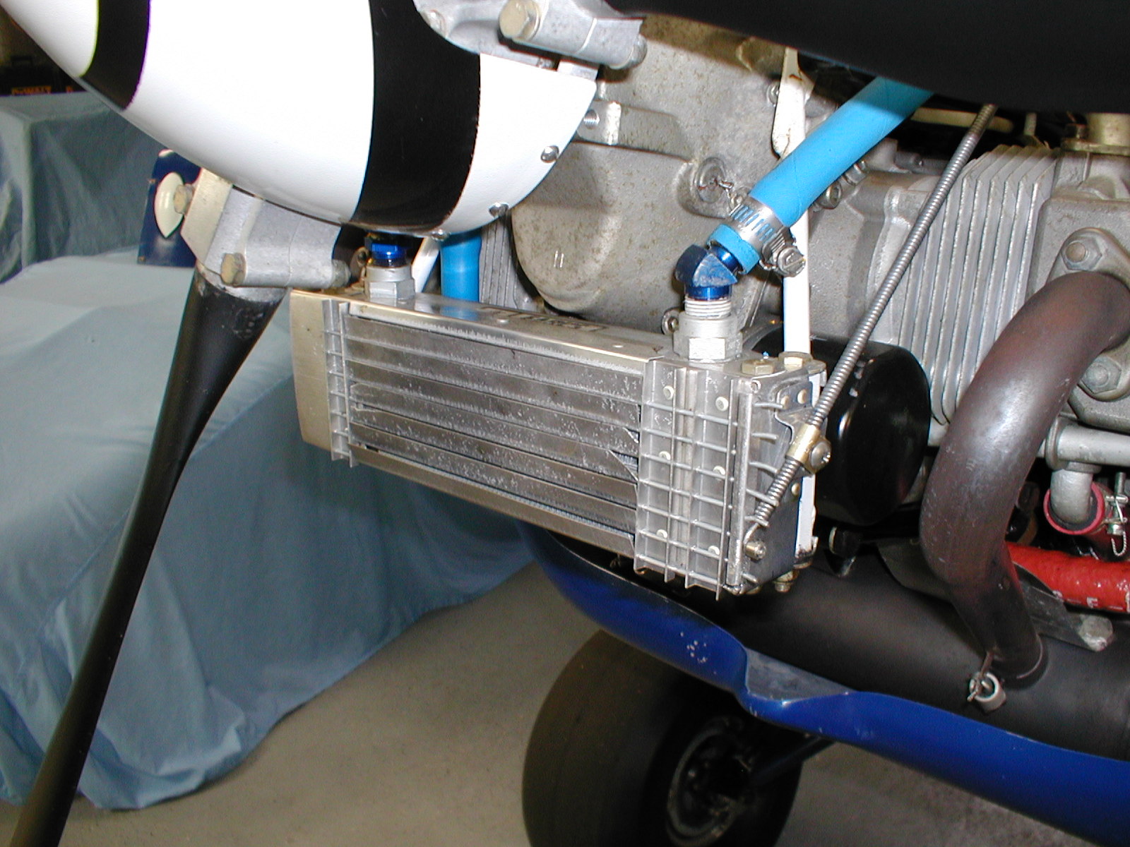

Do yourself a favor and contact Merle Willaiams at [url=murlewilliamsaviation.com]murlewilliamsaviation.com[/url] . He has the proper aviation fittings for your engine and will know what you need. I had to do the same thing. Here is an example on my oil cooler. The fitting on the far side (which you cant' see) reverses itself 180 degress in a very short space.It would have kinked a hose I then had to run a very short hose piece (about 3 ") then into a special fitting into the oil pump. Merle had all these pieces and knew exactly what I was talking about.
