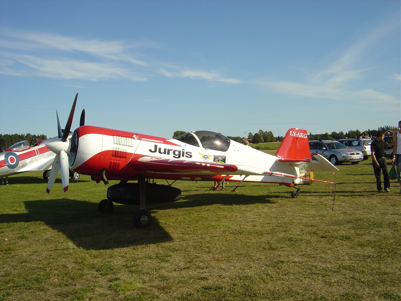

Jurgis normally runs a 4 blade prop not a three as illustrated here.
No matter the CAUTION note to hand propping still applies !

I didn´t mean to say that one doesn´t have to be cautious, using a rope ! However, I would fell a little more comfortable being a bit further away from a 360/400hp shredder...
He used to run a 4 blade prop some time ago, but the more recent pics show a 3 blade again. And the plane on your picture shows his SU-26, whereas the one in the clip is was LY-LJK, his SU-31...
