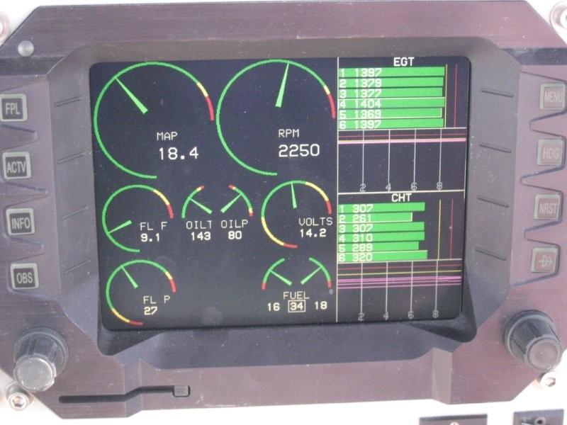

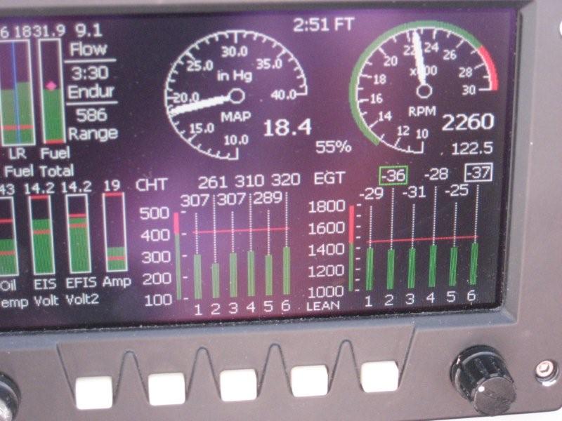

David, my real question is how did you get CHT/EGT's to read on both the
Chelton & GRT?
Also am I reading that right on the GRT there is a fuel left/right that
don't seem to add up to the total. 22/19 (L/R) 45.6 Total. I ask because
this is the 3rd or 4th time I noticed this on peoples EMS photo posts.

Just a stab at it, but the 22/19 is probably from the calibrated
floats and the 45.6 is probably from the totalizer (60 when full -
14.4 used = 45.6 remaining). Totally separate systems.

PostPosted: Fri Mar 20, 2009 8:06 am    Post subject: Leaning and cruising Reply with quote
David,
FYI, most of the numbers look pretty good but, the oil temp appears to be
a little low. Oil temps should ideally be in the 175-180 range (to
evaporate the condensation from the oil). Some guys who regularly fly
(LOP, or in cooler climates) rig a flap (controllable from the cockpit)
to limit the airflow across the oil cooler to regulate the oil
temperature.

I believe Jesse is correct. Mine works the same way.
