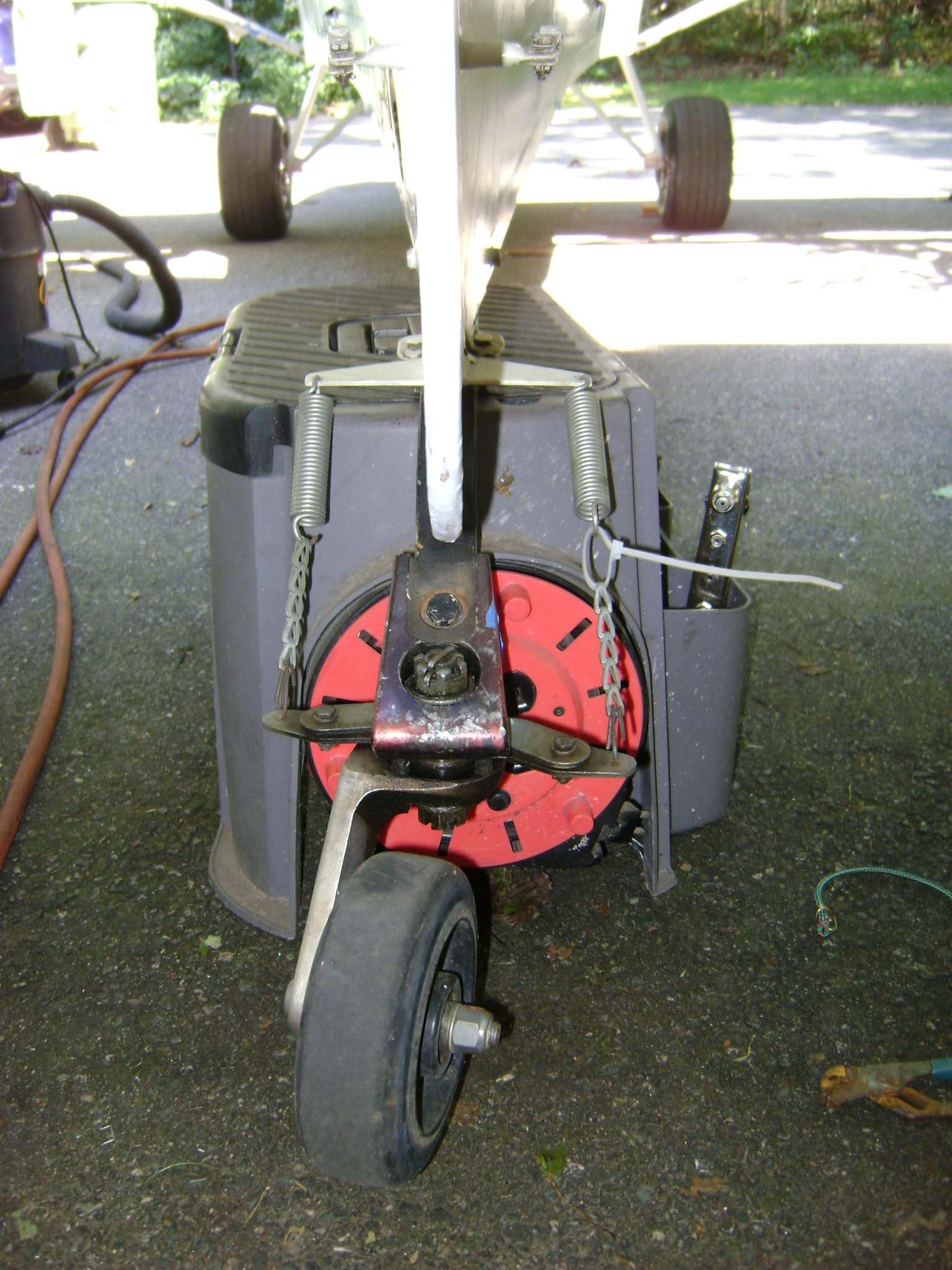

At 06:07 AM 3/17/2009, you wrote:
I think it is possible that I set myself up for some of that darting
with a tailwheel that would over-control and redirect me instantly
when I finally set the tailwheel down (more dual proved I was not as
religious about planting that tailwheel as I should have been).
I doubt it. I've been running bone tight springs from the start with
no problem, and I'm certainly no tailwheel phenomenon. I'd like to
see some pictures of your tailwheel setup.

Sorry, am replying to messages from last spring which escaped my attention. Guy asked for a picture of my tailwheel setup and I have tried to attach one taken yesterday. I attached a tie-wrap from chain to spring on the right side to show the amount of stretch that is required to hook it up. The J-3 I flew for my 709 (ride with the FAA) had a significant amount of slack from rudder horn to tailwheel, I think I sent a picture of that last winter. The stark difference is what prompted me to take a closer look. I bought some chain to loosen, but adding a link to each side produces such slack as to risk, or practically assure, spring detachment. I placed an order for compression springs from Spruce, which will hopefully eliminate that possibility. Now, having belatedly read your notes, I might go back to the tension I had and consider the sizable domain of reasons for the sudden darting I was experiencing.

The left wheel on my Classic 4 was seriously toed in. I could see it without the straight edges/clalk lines on the floor. I attempted the six foot cheater on the axle method to straighten but stopped because I figured that was going to break something. I ground looped good enough to collapse that left gear early on in my tail wheel experience.
I purchased a brand new left gear and figured it would fix the toe in problem. Wrong, it was toed in just like the first one. I took the axle out and bent it with a sledge hammer and a vise. The axles are soft and bend pretty easy. My wheel alignment is straight ahead now and is much easier to handle now.
On the stock steering springs on the tail wheel. The builders manual says to pinch the ends with pliers so the chains can't come off. I didn't do that at first because the chains were snug. A friend saw that before the first flight and told me to pinch them closed or I would eventually have one come off. He wasn't a kitfox guy either.

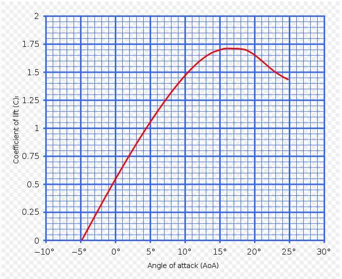

I gave your reply the weekend to digest. I was heartened by the first sentence which implied that touching down with my tailwheel "inches off the ground" was OK to a pro such as yourself. I want that to be ok, because in that regime, that AOA, I am confident that I can control the descent rate for a soft touch. Then later you take that away by saying you always practice tailwheel first landings. I get it that you might be able to control descent rate with power, although the 3 point attitude strikes me as too slow to do all the way down final, or with the least bit of gust. I have gotten leery about what another pilot calls a full stall anyway, usually a moot point, except in this discussion. just because pulling more on the stick does not result in more lift does not indicate a full stall in my mind. I think I have flown this airplane at a pitch much higher than 3 point (at altitude with lots of power), the buffet is heavy and the drag high. At those pitches, if you think of a typical lift curve, the lift actually decreases with additional AOA, but, there is still some lift available beyond max lift before the thing lets go. In that situation, you cannot control descent rate with pitch, only power, because more AOA produces less lift (and lots more drag). I guess now I have to attach a lift curve. Anyway, you get to a point where parsing this out with words creates diminishing returns, and you just have to get into the airplane and learn from experience what works and what does not. I doubt if most pilots have thought about this as much as I have, or in the same way. Words cannot do justice to all the considerations. The object of the game is to take baby steps within your own boundaries and expand the boundaries over time, which is what I thought I was attempting to do the day I wrecked it. But I would have admitted to you then that I did not have faith in the random physics that I felt I had to ride out, with ineffective flight controls, as my mains bounced like basketballs. Either with power, or a lower AOA, you must go for the soft touch.

The tail wheel hits first, because the main gear is not tall enough. To really drag it in slow the nose has to get way up there. The only way you can get that AOA on the wing and the most short field out of the plane is to drag it in and touch the tail wheel first. I have drug mine in and had the tail wheel on the ground when the mains were still a foot or so off the ground. It all depends on what you are comfortable doing.
While charts and graphs are cool, and will simulate theoretical numbers, I live in the real world. The operating book and brochures for my plane dont come close in terms of climb etc.
At the end of the day, no amount of charts, or graphs will teach you how to fly your plane. The first thing I do and tell people is to get lots of altitude, then slow the plane down and see how slow you can fly it and be comfortable driving it around the sky nose high and with lots of power. This will give you an idea of how I am landing when I really need to get in short.
