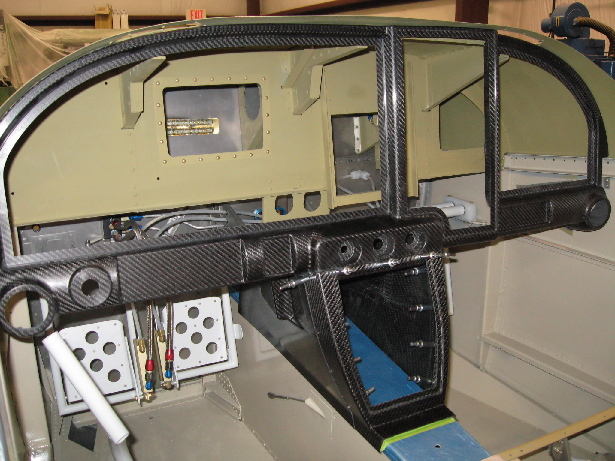

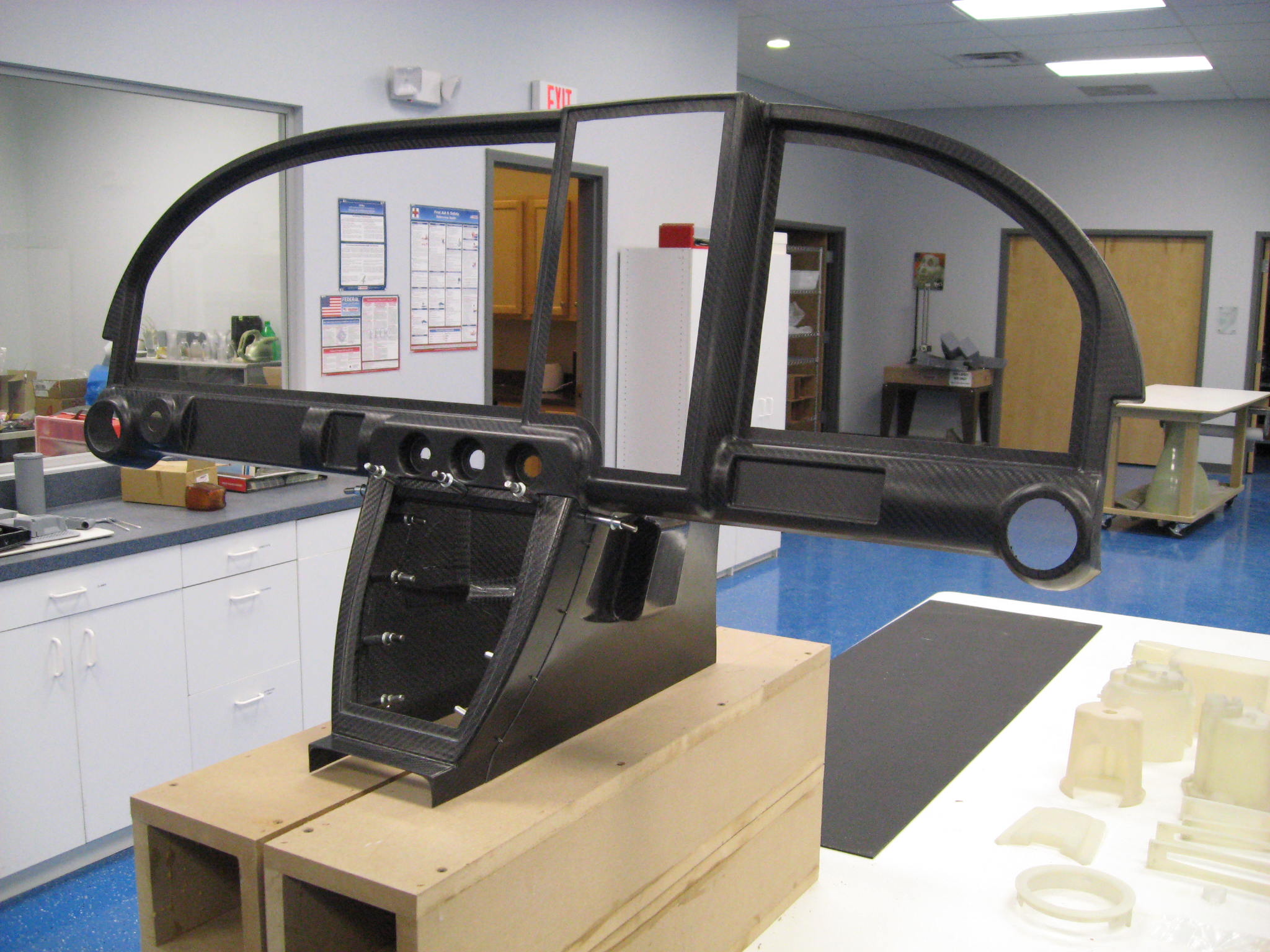

Here are some pictures of my carbon fiber panel and lower centerconsole. All parts weigh 2lbs. These will be available very soon if anyone is
interested. See more pictures at the link below
http://albums.phanfare.com/isolated/L5LenCCI/7068012/3161550
Geoff

PostPosted: Tue Mar 03, 2009 11:09 pm    Post subject: Carbon fiber panel Reply with quote
Geoff,
Sometimes it sucks to be an early adopter. You miss so many
"goodies" that come along. Clearly the design & execution are more than
just a goodie. Really superior work. I notice the rendering is
significantly different that the finished product in that the radio
stack is shifted right. Good call for side by side glass is ideal (for
me). The only downside is no throttle quadrant in this configuration.
Are you going to offer that as an option?

I watched the video of the CNC and block of aluminum. Is solid
metal required to form CF parts. Can carbon come off a wood form.
Robin

Geoff,
Gorgeous work. How tall is the panel directly in front of the pilot
or copilot. I'm working on my panel right now and could easily make the switch.
My layout is two AFS Advanced 4500's directly in front of pilot so this layout makes sense.
My biggest concern is whether the Infinity grips will still fit
(I'm assuming some cutback of stick).
Also, when do you anticipate available?
Availability through you or a vendor?

Wow. I wish I had my own backyard CNC and a block of aluminum the
size of the panel. Significant cost for the first one. I bet you will
be able to recoup your investment. Looks great.

Now the chunks of metal are not going down in price, that is why
I asked about milling wood to use as the mold. We regularly mill blocks
of aluminum or steel that size but we have to make two of each (male &
female) with a lot more considerations for end product wall thickness,
mold heating & cooling, mechanical part ejection...

I will try and answer most of the questions. Yes we will have a configuration for the throttle quadrants. This was already in the works.
We used a aluminum mold because it was cheaper than making a master
part and then making a carbon fiber mold. These parts are all Carbon fiber prepreg layups. Sometimes when carbon fiber or fiberglass molds are made there are voids that are not visible on the surface. When go and layup in these molds and vacuum bag and autoclave the parts it
opens these voids up and the parts have flaws as well as the molds break down much quicker. As for wood molds they do work OK but do not last like aluminum. As for the overhead console that everyone seems to be all fired up about. I chose to do what I did because it was very close to what I wanted. Yes it had some fit issues but it was OK. It was not AA overhead. It was much cheaper than making one for myself. It was not my perfect solution but it was 85% what I wanted. As for the little die grinder it is for the tool & die industry. Turns about 30,000 I think cuts thru
aluminum and fiberglass like butter.
Also if you use a throttle quadrant instead on the push pull you can just put a plate over that area and cut out the 3 locations. You could then put switches on the plate. Also if you do not want the center console or side panels we have a cap the fits over the bottom middle area that finishes off the panel real nice. As for cost somewhere between $0.00 and $1,200.00
