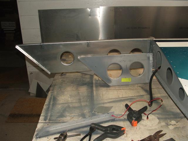

PostPosted: Thu Feb 26, 2009 4:15 am    Post subject: Re: Long wing Reply with quote
Here is a pic of a Savannah wing. The Spar doubler is .025 instead of .032 and it is about 500mm longer I also have the instructions to upgrade the Savannah to 1200 gross they do not include changing the doubler. Mostly the attach point and some mods to the fuselage.Also attached is the extended spar on a 701.
I have a folder called long wing share for anyone interested, to big to post here.

I am not quite sure what reinforcement you are referring to, since I posted a photo showing two different configuration of the stabs, that are not quite like the factory design for the 701.
If you are referring to the short 45 degree angles I riveted to the tip ribs on the original model, it was simply done to keep everything squared up perfectly for the skinning. These small sections have no use what so ever, once the skin is in place and riveted correctly.
On the other hand if it's the double spar modification you are talking about, I reinforced the stab in this way to try and diminish the destructive actions caused by the violent shaking that is seen at low engine speed, or when it is flown from the water. I also replaced the A4 rivets with the stronger A5 on the tip ribs, since these ribs are all that hold the outer hinges to the stabilizer
My original thoughts were that it most certainly be much more resilient in this way, and it seems that my impressions were not far off. The reason I say this is because not long after assembling the stab in this fashion, I received my plans for the 750, only to see that the factory had re-designed the stabilizer for the new CH-750 in the exact same way I built mine for the 701, albeit mine is the standard length. There is a very small weight increase, but you would not believe how strong the bare frame is, as compared to the standard build.
Hope this answers your question, Surprised)
