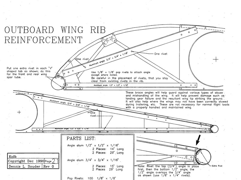

Rick:
I'd fly a Kolb mkIII at 1200 lbs, built strictly by the plans Dennis Souder
drew up in 1990, if I built it.
The kit manufacturer recommended my airplane be limited to 1,000 lbs. I
believe the max gross on new mkIII's is still 1,000 lbs.
The only thing I did to increase strength of the wings was put some aluminum
angle on the all main rib noses, plus some stronger lateral bracing from the
main spar to the leading edge, and beefed up bracing on the bow tip at 90
and 45 degrees forward. A copy of Dennis Sounder's plans sheet is attached.
I also added aluminum angle to the tails of the first four outboard main
ribs.
That's all I did. Changing the main gear did not change max gross weight
capacity.
I increased the up elevator cable to 1/8". It is the one that works the
hardest. Down elevator cable is still 3/32. It doesn't do much work.
Any other changes, as far as I know, did nothing to increase strength of my
Again, I am not encouraging anyone else to increase the max gross weight
capacity of a Kolb they build.
I did. It serves my purpose, and has more than proven it is capable of
1,200 lbs max gross under any conditions I can subject it to.
I emphasize, I only speak of my airplane. No one elses's.
Your mkIII may not be capable of 1,200 lbs.
 Filesize:  119.13 KB
 Viewed:  13513 Time(s)
NeilsenRM(at)comcast.net
PostPosted: Sat Feb 21, 2009 5:38 pm    Post subject: weight question Reply with quote
John
The plans from Dennis recommended that this be done to the outboard rib
only. Which I did but you did all full ribs and four of the outer tails. I
also added a jury strut which you did and it seems like you told me you also
beefed up the lift strut.
My POINT IS...... Your plane has been beefed up to handle the 1200 lbs.
gross weight. I never said you advised people to to increase the gross
weight. The problem is you have put your plane thru the ultimate test and it
did hold up with the higher gross weight. That says more than I or anyone
else can say. That is why if you say 1200 lbs you have to tell us everything
you did. John you are a friend so I really don't want to beat you up over
this but lives are at stake here. Want it or not we hang on every word you
say and I remember.
Does Brian do all this? I don't think a standard build would handle the
treatment at 1200lbs.
Rick Neilsen
Redrive VW powered MKIIIC
PostPosted: Sat Feb 21, 2009 6:05 pm    Post subject: weight question Reply with quote
also beefed up the lift strut.
Rick Neilsen
Rick:
Yep! Made sense to me. If it worked to beef up the outboard wing from
abuse, mishandling, drops, ground strikes, etc., then it ought to work to
beef up the other 4 main ribs on each wing panel. That has to be one of the
cheapest, easiest, simplest improvements one can make to vastly increase the
strength of the rib. I was primarily concerned with increasing strength of
the rib noses. Oh yea, and it adds negligible weight.
As far as handling, flying, hauling extra weight with Homer's wings, it'll
do it. I always said if I could stuff it in the mkIII, it would fly off
with it.
Only reason I stiffened the tails of the four outboard ribs was the load the
ailerons placed on them. Made me feel better.
I used 1/2" od aluminum tubing to brace the leading edge to the main spar
inboard and outboard. Keeping the main rib noses in column is critical if
they are going to do their job.
I ended up using 4130 tubing for lift struts inside the extruded streamlined
aluminum struts. Seems I had a difficult time getting the bolt holes
drilled straight, ruined two sets of struts, then opted for the 4130 tubing
(with fittings welded on) inside the aluminum strut. Aluminum strut is
nothing more than a fairing for the steel strut. Had nice 4130 streamlined
struts for the first flight, but one got destroyed during testing. Couldn't
afford to buy material for a replacement when I rebuilt.
If built correctly, the mkIII wing is tremendously strong in my humble
opinion.
I tore up a lot of parts and airplanes during my growing pains in civilian
aviation. Homer used to refer to me as his best test bed. If it could be
broken, I'd breake it. Wink
Hope I have outgrown being his test bed.
