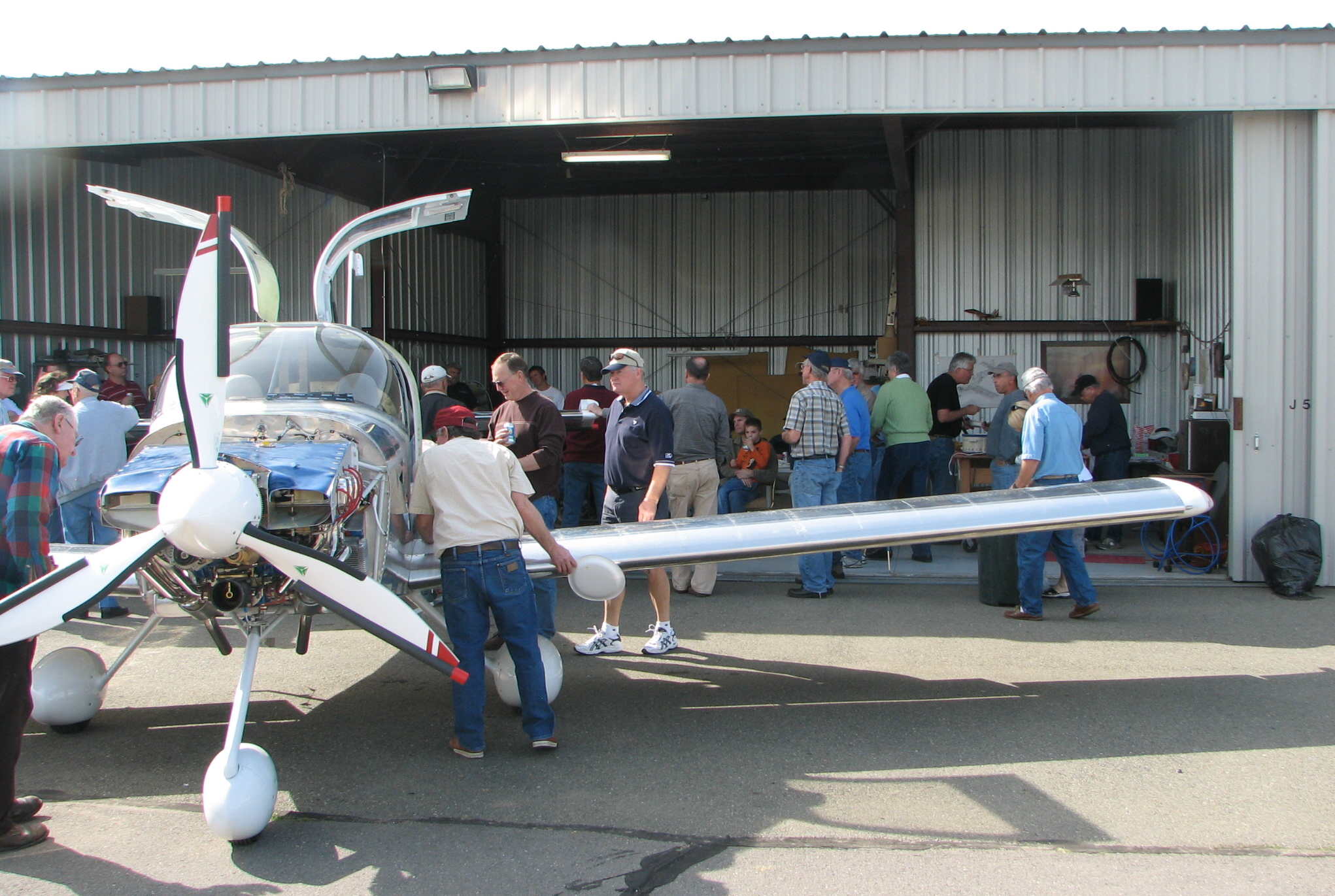

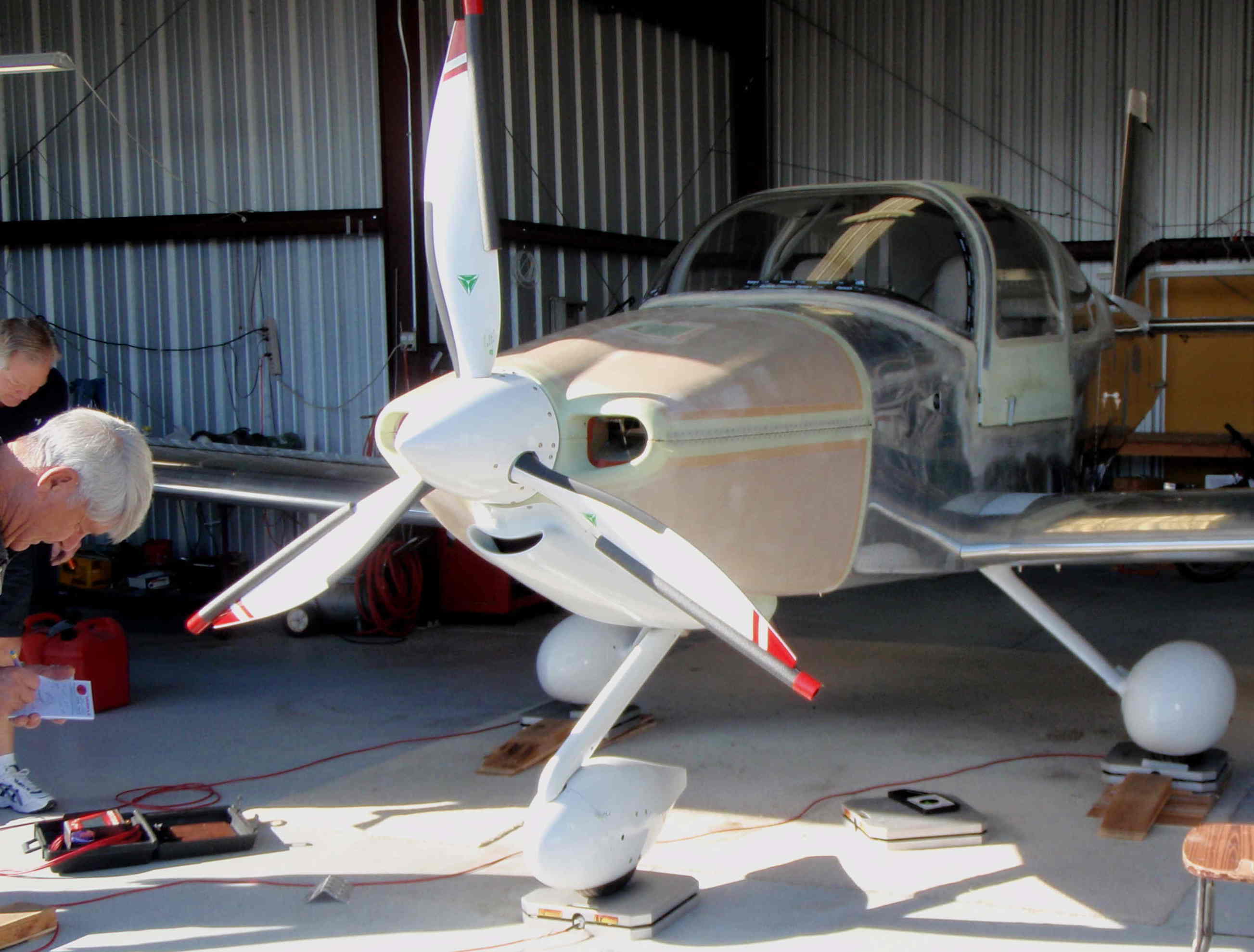

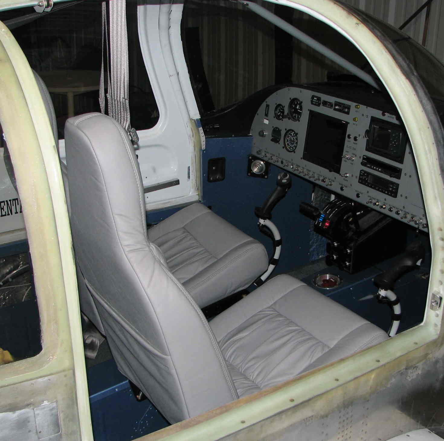

Deem's and I had been emailing last week because both our 10's were set to be weighed... mine last Sat, and Deems' yesterday. Anyway, since he made his public, I guess I should, in case someone is tracking this info. Weigh in included all upholstery, all carpet, balanced wheel pants, and the following painted; interior, wheel pants, gear leg fairings, and hs/vs fairing.
N414DM Left=639, Right=627, Nose=369....... Total = 1635
Mine was weighed prior to our meeting of the SacRvators (Sacramento).
As you can see, sorry about the large pics, we had over 25 RV's fly in and about 60 people, as quite a few reside at the Lincoln airport already, no need to fly in. I guess I did a decent job because I was only made aware of one potential problem, and it's fixed already.

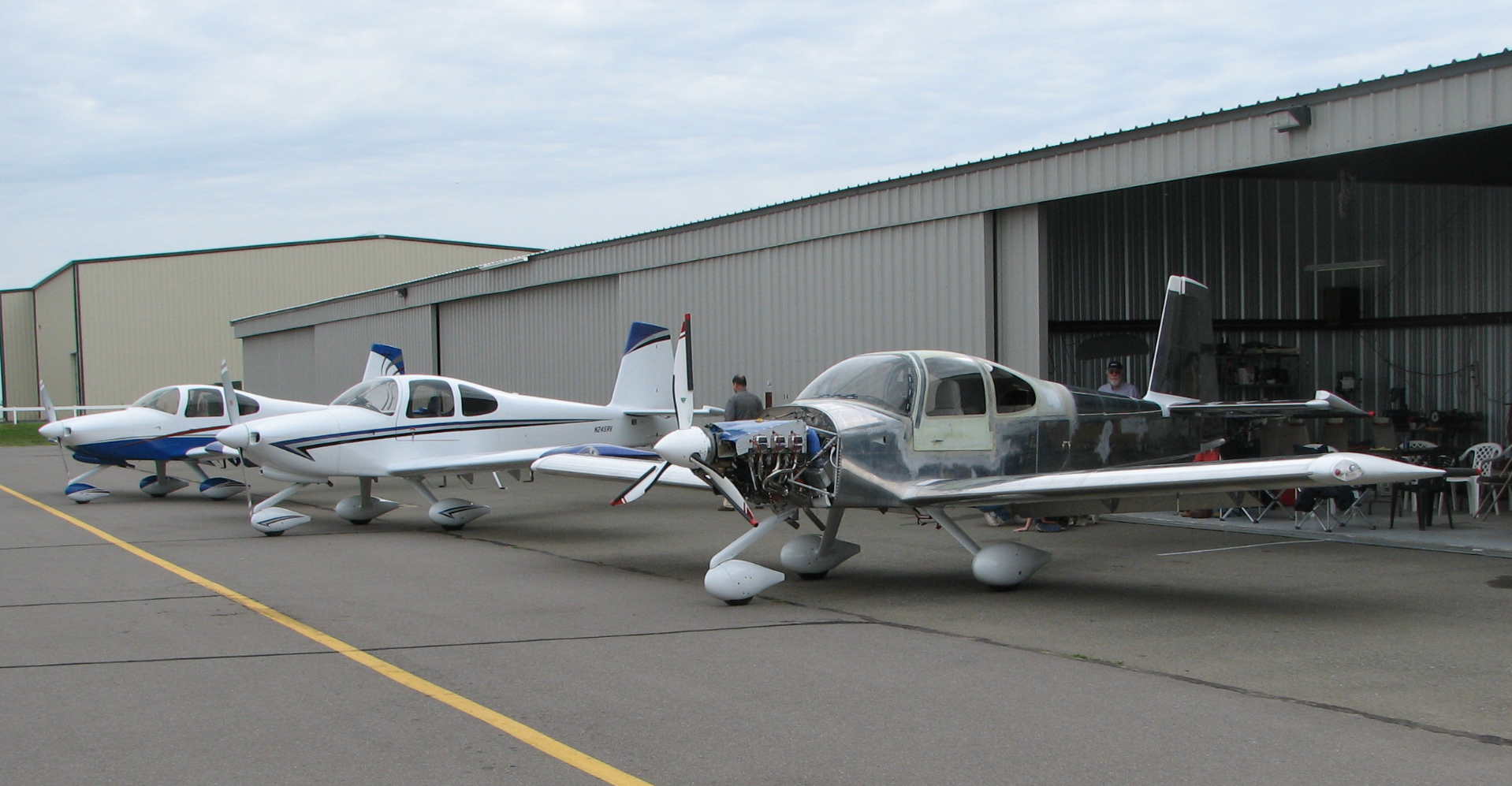

How about the 3 10's lined up?

Very cool Don,
Everyone should make note of Don's last photo...he weighed
the plane with the scales on the rear wheels blocked up
a couple extra inches. You want to make sure to do your
weight and balance with the airplane level in both
directions, and the fore/aft level line is along
the longerons that run along the aircraft under the door
area. If you don't have the rear wheels elevated above
the nose, your C.G. measure will be off quite a bit.

I think the longerons that run the full length are a little
lower, aren't they? I may be wrong, but yeah, they're not
far from the door sil. I do think that the door sil is
parallel to them though, but I never measured it to
be sure. I just used a long level along that rivet
line for the longeron. And the same long level across both
door sils for the horizontal.
You'd be surprised how huge a difference it makes if you
don't have things leveled though.

> Very cool Don,

Use the bottom of the door opening as the level reference. That is what the plans tell you to use for leveling the airframe.Jim C> --> RV10-List message posted by: Tim Olson <Tim(at)myrv10.com>> > I think the longerons that run the full length are a little> lower, aren't they? I may be wrong, but yeah, they're not> far from the door sil. I do think that the door sil is> parallel to them though, but I never measured it to> be sure. I just used a long level along that rivet> line for the longeron. And the same long level across both> door sils for the horizontal.> > You'd be surprised how huge a difference it makes if you> don't have things leveled though.> > Tim Olson - RV-10 N104CD - Flying> > > > Danny Riggs wrote:>> Tim,>> If I understand this correctly, the level should be put on the longerons>> that form the door sills? Is that correct? Thanks>>>> > Date: Wed, 25 Feb 2009 08:58:19 -0600>> >From: Tim(at)MyRV10.com>> > To: rv10-list(at)matronics.com>> > Subject: Re: RV10-List: Re: N519PJ Weigh -In>> >>> > --> RV10-List message posted by: Tim Olson <Tim(at)myrv10.com>>> >>> > Very cool Don,>> >>> > Everyone should make note of Don's last photo...he weighed>> > the plane with the scales on the rear wheels blocked up>> > a couple extra inches. You want to make sure to do your>> > weight and balance with the airplane level in both>> > directions, and the fore/aft level line is along>> > the longerons that run along the aircraft under the door>> > area. If you don't have the rear wheels elevated above>> > the nose, your C.G. measure will be off quite a bit.>> >>> > Tim Olson - RV-10 N104CD - Flying>> >>> >>> >>> > partner14 wrote:>> > > --> RV10-List message posted by: "partner14">> <building_partner(at)yahoo.com>>> > >>> > > Deem's and I had been emailing last week because both our 10's were>> set to be weighed... mine last Sat, and Deems' yesterday. Anyway, since>> he made his public, I guess I should, in case someone is tracking this>> info. Weigh in included all upholstery, all carpet, balanced wheel>> pants, and the following painted; interior, wheel pants, gear leg>> fairings, and hs/vs fairing.>> > > N414DM Left=639, Right=627, Nose=369....... Total = 1635>> > >>> > > Mine was weighed prior to our meeting of the SacRvators>> (Sacramento).>> > > As you can see, sorry about the large pics, we had over 25 RV's fly>> in and about 60 people, as quite a few reside at the Lincoln airport>> already, no need to fly in. I guess I did a decent job because I was>> only made aware of one potential problem, and it's fixed already.>> > > How about the 3 10's lined up?>> > >>> > > Don McDonald>> > > #40636>> > >>> > > -------->> > > Don A. McDonald>> > > 40636>> > >>> > >>> > >>> > >>> > > Read this topic online here:>> > >>> > > http://forums.matronics.com/viewtopic.php?p 31965#231965>> > >>> > >>> > >>> > >>> > > Attachments:>> > >>> > > http://forums.matronics.com//files/img_2797cc_395.jpg>> > > http://forums.matronics.com//files/img_2792c_125.jpg>> > > http://forums.matronics.com//files/img_2762c_171.jpg>> > > http://forums.matronics.com//files/p2210036c_110.jpg>> > >>> > >>> &======================>> >============>> >>> >>> >>>>> ------------------------------------------------------------------------>> Windows Live&trade;: Discover 10 secrets about the new Windows Live. View>> post.>> <http://windowslive.com/connect/post/jamiethomson.spaces.live.com-Blog-cns!550F681DAD532637!7540.entry?ocid=TXT_TAGLM_WL_t2_ugc_post_022009>>>>>>> *>>>>>> *> > > > http://www.matronics.com/contribution> > > > [quote][b]

Thanks Jim/Larry,
I do think that the longeron and door sil are probably both
identical in angle, so this may be a horse-a-piece kind of
deal. I don't think you'd see any difference, but....
Straight from the RV-10 Weight and Balance section, provided
by Vans:
"Leveling Datum - A point or surface on the airframe where a
level can be placed to determine when the aircraft is in a
level position for weighing. For the RV-10 the Level Datum
line is the fuselage longeron at the door opening"
So, you guys may well be correct, and probably are, that the
door sil works, but the official word in the RV-10 W&B
procedure section from Van's specifies the longeron.
If anyone is near their plane, maybe you could take a sec
to verify if the door sil is completely parallel to the
longeron or not. I bet it is.

The door sill sits directly on top of the longeron. It gives a
convenient place to set the level.
Yes a horse-a-piece kind of deal.

> >> > Very cool Don,
> >> (Sacramento).
> RV's fly
