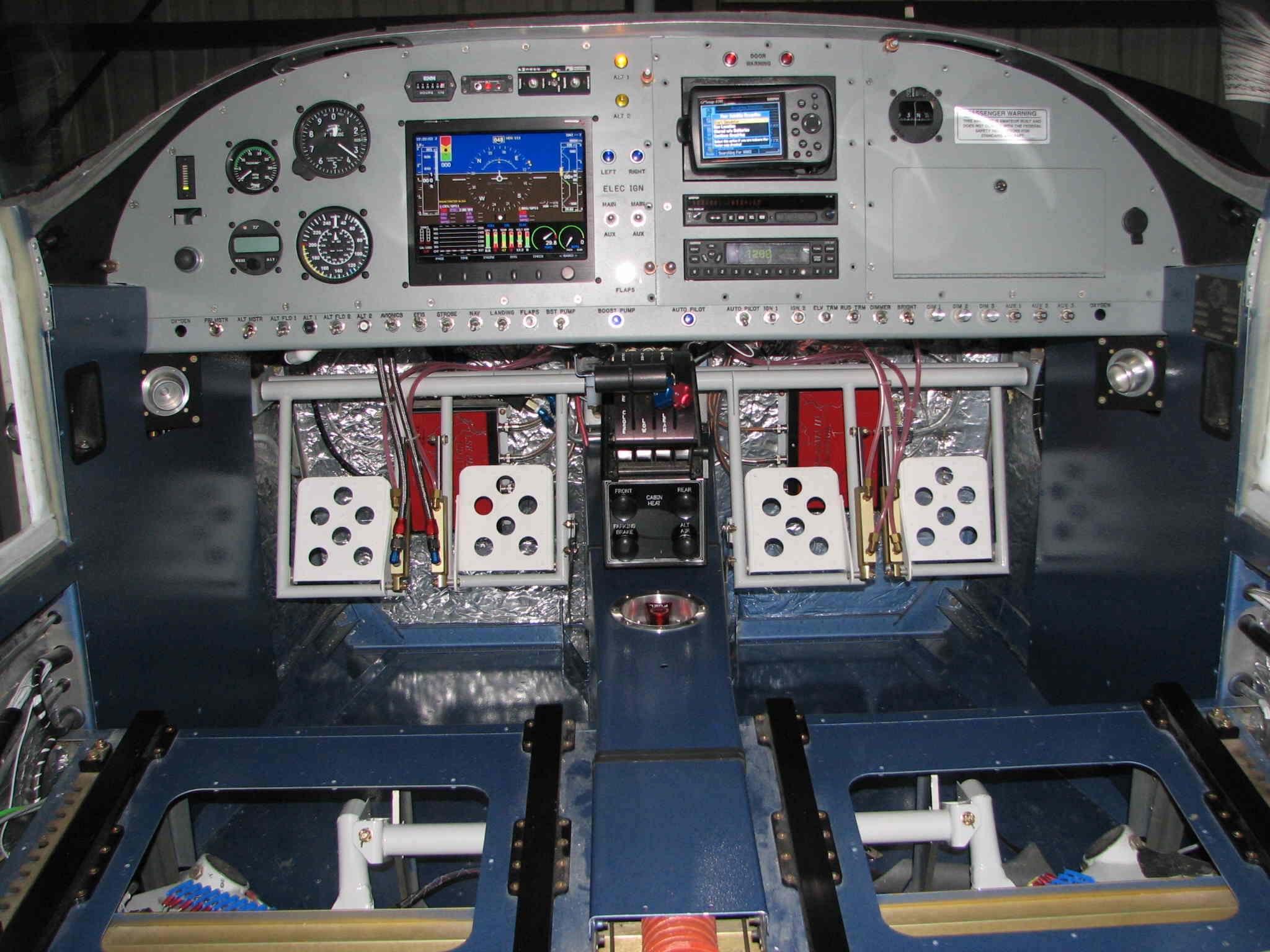

PostPosted: Thu Feb 26, 2009 3:39 am    Post subject: Re: Positioning of Lightspeed control-box and VP-200 CU Reply with quote
No VP-200, but dual LSEs...
Jay

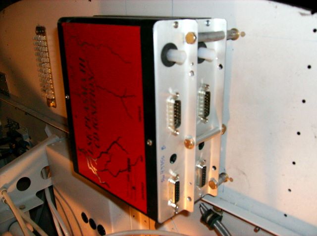

PostPosted: Thu Feb 26, 2009 7:35 am    Post subject: Positioning of Lightspeed control-box and VP-200 CU Reply with quote
Here's where I mounted my dual LSE's.
Don McDonald
