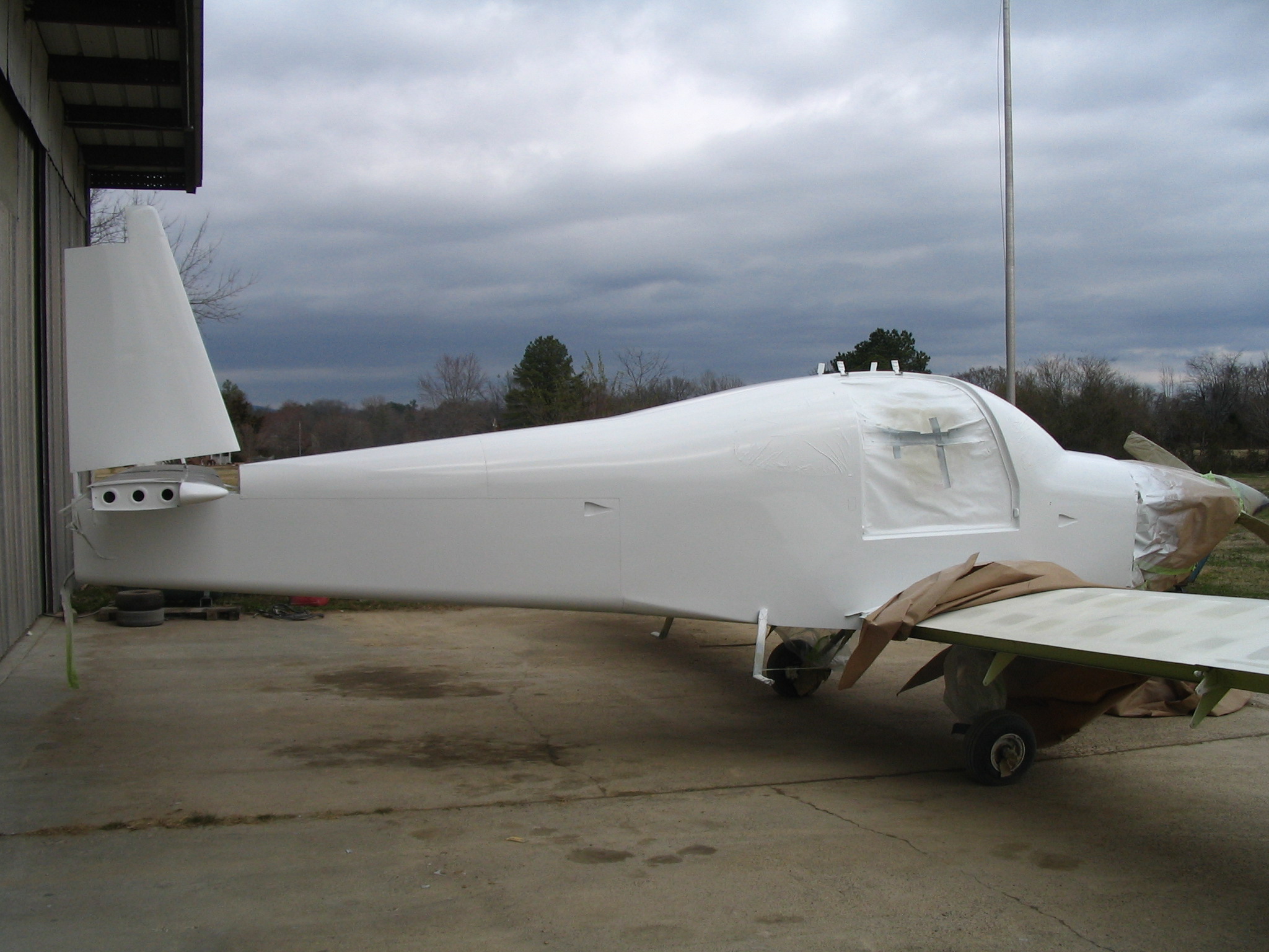

robin1(at)mrmoisture.com
PostPosted: Tue Feb 24, 2009 12:35 pm    Post subject: Finish and Paint questions ?? Reply with quote
Ok John, you really want to see my paint...I will give you a sneak
peak... I do plan to add a touch more color.
As for the Tim's question, I am paying $8K but the painter did ALL the
sanding, fill (including wing rivets). That being said I was told 3
weeks, expected 5 weeks and am passing 2 months (insert painter story
here). Oh... and Tim there are several paint jobs over $12K+. Not sure
those people will chime in but they are definitely out there (and may be
worth the difference).
Robin
 Filesize:  623.78 KB
 Viewed:  19102 Time(s)
