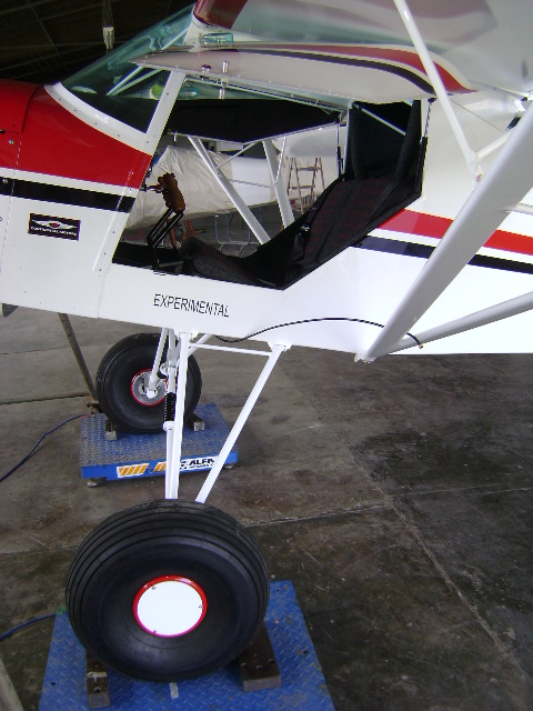

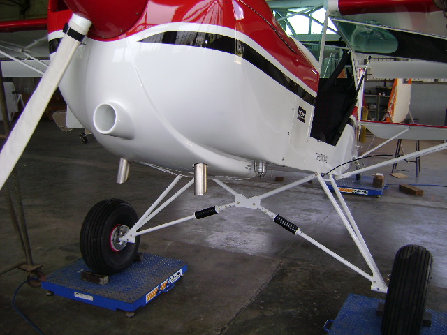

Here are some pictures of my new gear.I will give you updates as I go along.

The gear looks great. If it performs as tough as it looks, you have made a great choice.

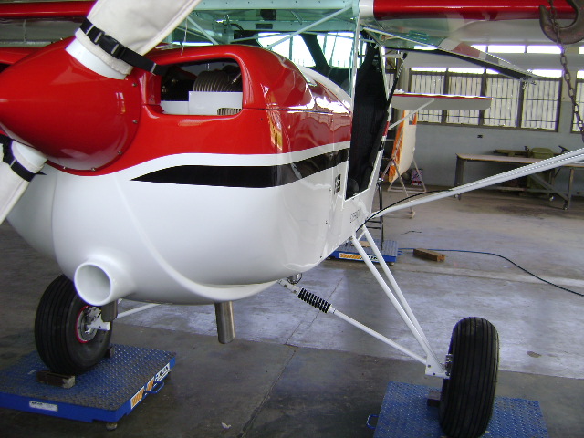

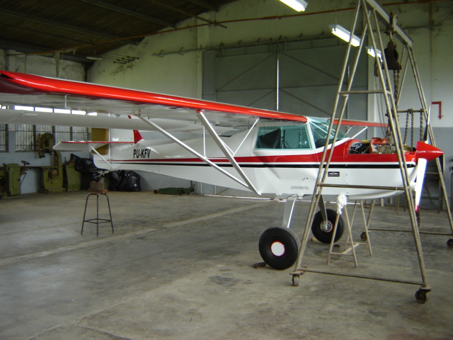

Here are some pictures of my aircraft with Kitfox Bush landing gear

Ok! now how did it weigh in any big changes in bal?

Oh, yeah, this was the one with the gear supposedly in the wrong
place....and looks like it still is. I wonder just how big that
battery is in the tail?
And how would going to this gear without changing locations....if
indeed it IS in the wrong location...change things?

Here "new" W&B situation!
I had to add 11 lbs on tail
DATUM = Leading Edge of Wing Root EMPTY WEIGHT CG Weighing Point Wht. (Lbs.) Arm, (in.) Moment Left Main, (- tare) 421,63 4,12 1737,13 Right Main (- tare) 417,22 4,12 1718,94 Tail Wheel (+ tare) 44,15 151,80 6701,99 Nose Wheel (-tare) 0,00 0,00 0,00 TOTALS 883,00 ^ ^ ^ ^ ^ ^ ^ ^ 10158,06 MOM. / WEIGHT = EMPTY WEIGHT CG, (in.) = 11,50
If you want, I could send W&B xls spreadsheet complete.

Lynn,
I assure you my gear is not mounted in the wrong place. The gear leg is pretty much identical in build and shape to the original Kitfox leg I took off. The wheel is in the same position it's just a foot further out toward the wing tip so I have to stretch to put my foot on it to get in the aircraft. I am a short guy. The gear weight is just 4 lbs lighter and the spread 2 ft wider. I now have a 6 ft spread vs the original 4 ft (actually 7 ft if you measure to the outside of the "kingfox" tires)
I am not too worried about weight and balance as the 4 lbs difference will equal the 4 lbs of stuff I put in the panel!
I am waiting for the polyflow fittings to arrive from Spruce so I can extend the brake lines.
Yesterday I installed the "visible reservoir" thick plastic brake fluid reservoir that I obtained a while back. Now I will be able to see how much fluid is in the reservoir. This will be useful when back bleeding for fill purposes. No more running over the top!

PostPosted: Sat Feb 21, 2009 4:05 am    Post subject: new bush gear Reply with quote
Dick, I have no doubt that yours is in the right place...re-read my
post. It was in response to Noel, who was responding to Francisco,
whose plane was the subject of much discussion a few weeks back, when
he sent pictures of his plane which looked like he had the gear in
the wrong place.
In looking at your pictures just now, it looks like they no longer
put the front float brackets on the fuselage...yours has 3 on each
side, as does Francisco's, while mine has 4.

I just had another look at your pictures, Dick, and I think I do see
the 4th float bracket on your fuselage...is that correct?

On Feb 21, 2009, at 6:16 AM, Catz631(at)aol.com wrote:
> Lynn,
> I am having a time painting the gear leg fairings! Call me the
> "orange peel" king. I am using Poly Tone and have tried both
> methods (primer dry and spraying a mist coat onto drying primer)
> nothing seems to work. I might have to break down and order a
> quart of enamel from Spruce (so expensive for a small amount) I
> will give it another shot today.
> Dick
> Maddux
> Fox
> 4-1200
> Rotax
> 912UL
> Pensacola,Fl

Lynn
Kitfox IV-Jabiru 2200
N369LM
Lynn Matteson
Posts: 2778
PostPosted: Sat Feb 21, 2009 8:08 am    Post subject: new bush gear Reply with quote
I hope everyone is keeping up with this thread, as it involves two
different airplanes and two different situations....it's too bad that
they got lumped into one subject title. Dick, with the Model IV, who
just changed his gear, and Francisco, who just did a W&B calculation
after (?) adding 11 lbs of battery in the tail, and now that I look
again, I see the change in gear style...I thought the bush gear was
there all along. We need two separate titles for these two planes.
I know for sure that I'm confused!

I ran the numbers and they look right to me. Now the CG envelope for
the Model IV (mine) is about 10" to about 16" (I don't have the
sheets here right now), so if this is what your airplanes' CG
envelope is, you seem to be in the "front-heavy" end of the envelope,
which is better than being in the "tail-heavy" end of things.
Did you add the 11 lbs, then do the W&B? And did you level the
plane to the bottom door, or whatever level is called for?
Lynn Matteson
Jabiru 2200, #2062, 605 hrs
Sensenich 62x46
New skis done and flying
On Feb 20, 2009, at 10:07 PM, Francisco dcubj3 wrote:
Lynn, Noel
EMPTY WEIGHT CG
Weighing PointWht. (Lbs.)Arm, (in.)Moment
Left Main, (- tare)421,634,121737,13
Right Main (- tare)417,224,121718,94
Tail Wheel (+ tare)44,15151,806701,99
Nose Wheel (-tare)0,000,000,00
TOTALS883,00 ^ ^ ^ ^ ^ ^ ^ ^10158,06
MOM. / WEIGHT = EMPTY WEIGHT CG, (in.) =11,50
FD

Ok Francisco:
What is your weight and the arm of your seat.  Also how much fuel can you carry and the arm of your tanks.
It looks like it’s getting better.  883 is a heavy plane. Compared to my 511 lb. mod II.
Noel
