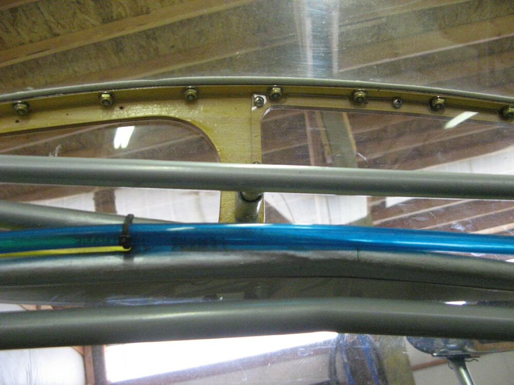

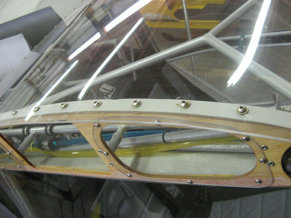

As to securing the sides of the lexan to the butt ribs, I think an aluminum strip on the bottom of the rib cap inner side makes more sense.
Ed, the classic 4 manual calls for an aluminum strip 13/32 X .02 epoxied to the underside of the butt rib cap strip.
Then, why use nutplates on the curved surface? They are accessible, so why not use nylok nuts with the truss screws. I can also see how an aluminum bracket could be installed on the center of the carry thru tube so that an additional camlock can be installed thru the turtledeck.
I used 632 screws and nylock nuts. They are a pain in the butt to install and remove. I could drill rivets out and replace much faster. To access
the nylock nuts I did not cover the inside of the butt ribs. I covered the bottom of it with fabric and the outside with lexan. I can see into my wings while I'm flying. Pictures attached.
As for the angle and cam lock, I would not drill any holes in the spar carry through tube other than those indicated in the manual.
For what its worth, the rib cap strips are just stapled and glued to the rib web. There have been reports of the butt rib cap strip separating from the web due to the lift generated by the skylight. The fix is to make some aluminum or stainless steel angles and install to butt rib and cap strip.
Damit, wide post again. What am I doing wrong?
edited 2-18-09 to correct butt rib cap strip reinforcement for skylight rivets from stainless steel to aluminum.

Lynn, Agreed, sheetmetal or wood screws into the wood, I wasn't
considering. I believe someone said thats what they had though. At
this point I am leaning towards aluminum pop rivets with an
aluminum washer on the bottom side.
Pat Reilly
Mod 3 582 Rebuild
Rockford, IL

> Date: Wed, 18 Feb 2009 20:30:51 -0500
> To: kitfox-list(at)matronics.com
> That metal reinforcing strip is only good in the area near where the
> rivets go through it, and a little distance beyond. So the
rivets, if
> you choose to use them with a large-area...relatively
> speaking...washer, they should serve roughly the same purpose. Of
> course, the addition of the metal angles added to the rib/capstrip
> junction sounds like a good idea. I can't remember whether I did
this
> or not. If I didn't, it sounds like it is unnecessary, as I've been
> tossed about a little bit in mine and no apparent damage done.
> I would never use metal screws into the wood...maybe only to get
home
> in an emergency.
> Well, being as how the builder's manual that I have calls for
> drilling and cleco'ing the skylight, and doesn't mention doing any
> attaching beyond that, I'd say they think the cleco's will hold it
> on! Keep in mind that I have the Model IV manual and yours may
> actually tell you how to finish up the job. Kidding aside, it all
> depends on a few factors...what is the Vne of your plane, and how
> hard will you fly it? How many violent storms or weather will you
fly
> in? Will the plane see turbulence? Of course, none of us know these
> answers..most of them anyway, so we try to follow the manual or
later
> service bulletins, or call those building the plane now...John
> McBean....and see if any new methods have come into existence.
> When I installed my wing tips, I ordered the "removable wing tip
kit"
> consisting of...what else?....Aluminum strips, K1000 anchor nuts and
> machine screws to attach the tips after the anchor-nutted strips
were
> flush-riveted in place. More work? You bet, but once done, it's done
> right, and they can be removed with one hand, a screwdriver, and no
> drill.

PostPosted: Wed Feb 18, 2009 8:39 pm    Post subject: Greenhouse construction Reply with quote
Hey Guys C One thing I am doing that no one else is doing. You all have the heads of your screws or rivets bearing on the Lexan. I am using a 1/16th" x 3/4" wide strip of aluminum on top of the Lexan drilled out for the row of rivets front to back on the ribs and cross wise above the spar carry through tubes. I didn't do it C but if I was to do it again C I would put some sort of rubber tape on the bottom side of the aluminum strip to cushion it slightly. I don't know it just looked like a good way to spread the holding force of the rivets over a large area of the Lexan to me. I really don't like a bolt or rivet head bearing on a piece of plexi C even with a fender washer. I did the same thing on the plexi observation doors that I made.
Pat Reilly
Mod 3 582 Rebuild

--> Kitfox-List message posted by: Lynn Matteson <lynnmatt(at)jps.net>
Probably a good plan C Pat...maybe even steel washers underneath C just
to keep a flat surface contact instead of a possible dished one.
Important to get a good diametral fit to the rivet C though C with
either. Another thing to consider...aluminum mandrels C or steel?
Maybe a knowledgeable engineer might offer some help here. : ) An
aluminum mandrel might not allow enough squeeze before popping C while
a steel mandrel might squeeze too much.
Lynn Matteson

I'm a little confused. How did you confirm there was no
metal backing if you can't get to the underside without removing
fabric? I'm definitely not understanding your configuration.
Guy Buchanan

LP Aeroplastics sells a dense foam tape, self-adhesive, for that very
purpose. I still say the rivet idea is not the best, because of no
way to control tension, and the bearing area is too small. You've
covered the bearing area with the aluminum strips, but is it a good-
looking installation?
cross wise above the spar carry through tubes. I didn't do it, but
if I was to do it again, I would put some sort of rubber tape on
don't like a bolt or rivet head bearing on a piece of plexi, even
doors that I made.

Lynn
Kitfox IV-Jabiru 2200
N369LM
Lynn Matteson

Good one, Pat. : )

just
> Important to get a good diametral fit to the rivet, though, with
> either. Another thing to consider...aluminum mandrels, or steel?
> aluminum mandrel might not allow enough squeeze before popping,
while
> Lynn Matteson
> Kitfox IV Speedster, taildragger
> Jabiru 2200, #2062, 605 hrs
> Sensenich 62x46
> Electroair direct-fire ignition system
> New skis done and flying
> > Pat Reilly
> > Mod 3 582 Rebuild
> > Rockford, IL
> > > From: lynnmatt(at)jps.net
> > > Subject: Re: Re: Greenhouse construction
where the
> > rivets, if
purpose. Of
capstrip
> > this
I've been
> > home
> > > in an emergency.
doing any
hold it
all
how
you
> > fly
these
> > later
> > kit"
nuts and
> > were
it's done
and no
> > > drill.
> > > Lynn Matteson
> > > Sensenich 62x46
> > > On Feb 18, 2009, at 7:23 PM, patrick reilly wrote:
> > > > Man Oh Man. I checked the bottom side of my butt ribs.
There is no
> > > > metal reinforcing strip on the bottom! I had to repair one
wing
> > > > tip. The last rib on the outside end of the wing had that
metal
> > > > reinforcing strip on the bottom of the rib to keep the
rivets on
> > > > the wing tip from pulling through. What the hell do I do
now? Do I
> > > > remove the fabric covering on the rib and bolt down the
cabin top?
> > > > Do I use sheet metal screws in the wood? Or are the rivets
through
> > > > the wood just fine. The plane flew for 200 hrs as originally
> > build,
> > > > no metal reinforcing strip on the underside. But, I don't know
> > what
> > > > type fasteners were used originally, as the windshield was not
> > > > installed when I got it. I guess I better look at builders
manual.
> > > > It seems that there are an awful lot of different methods
being
> > > > used by you guys to attach that cabin top.
> > > > Pat Reilly
> > > > Mod 3 582 Rebuild>===
