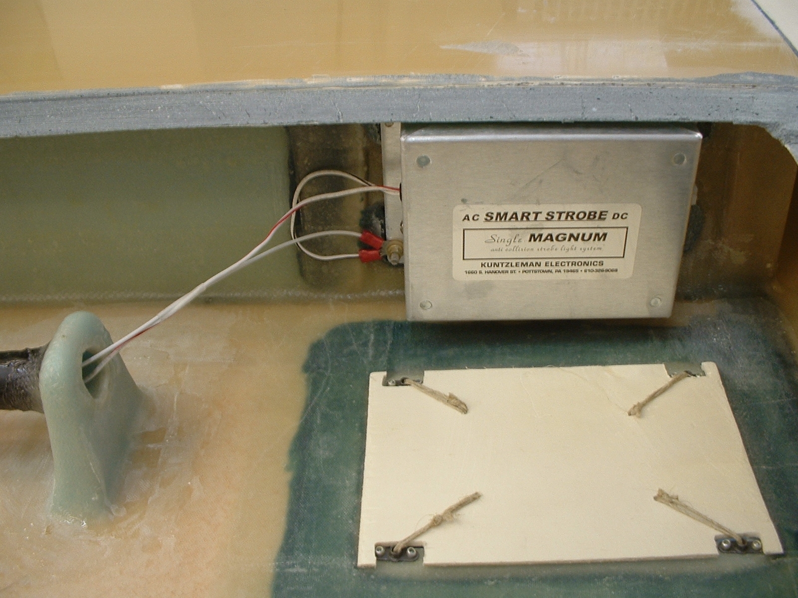

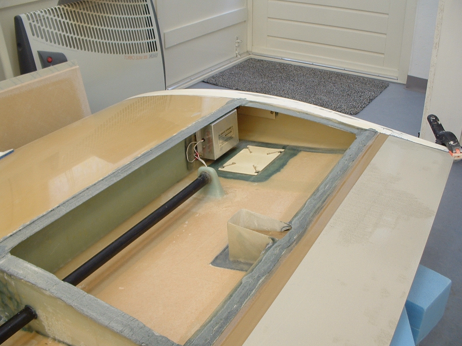

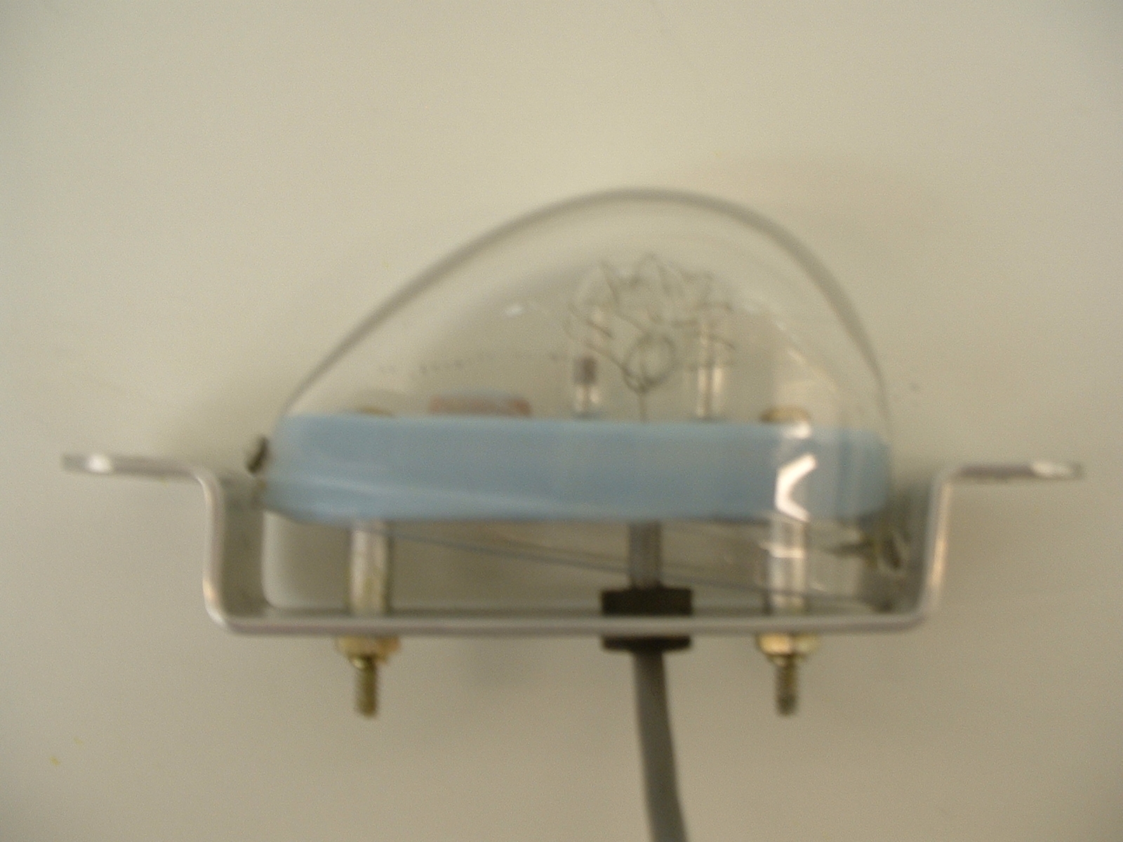

Hi Ron,
I put a single strobe power supply on the outboard end of each spar with
an access hole below.
The strobes will be uncoordinated, but I keep the high voltage wires short.
Attached some pictures, quality soso.

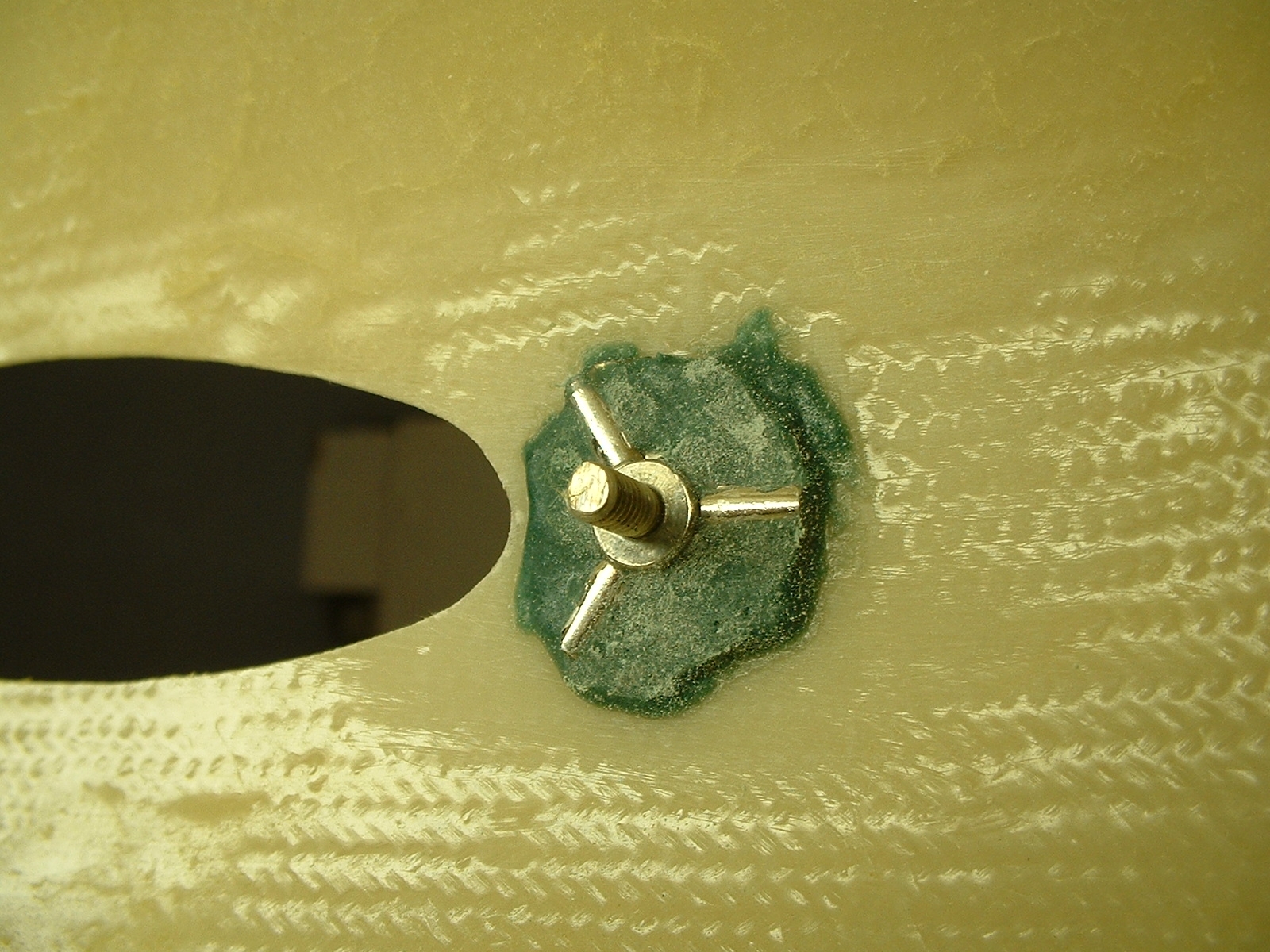

Access holes are a little large, because my first plan was putting the
power supplies on the lids.
Power supply attachment using reduxed McMaster-Carr studs and bid.
Light fixtures attached with cut down studs reduxed only.
Jan de Jong
 Filesize:  833.93 KB
 Viewed:  4576 Time(s)
 Filesize:  836.21 KB
 Filesize:  841.5 KB

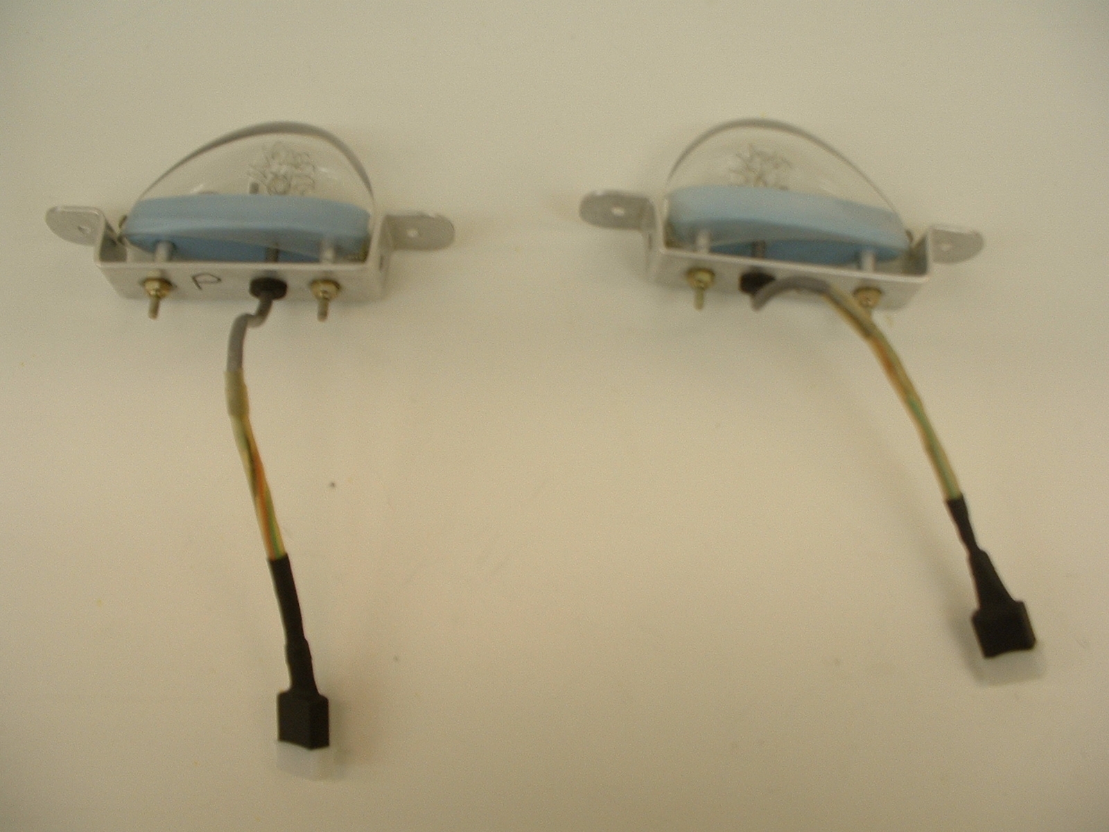

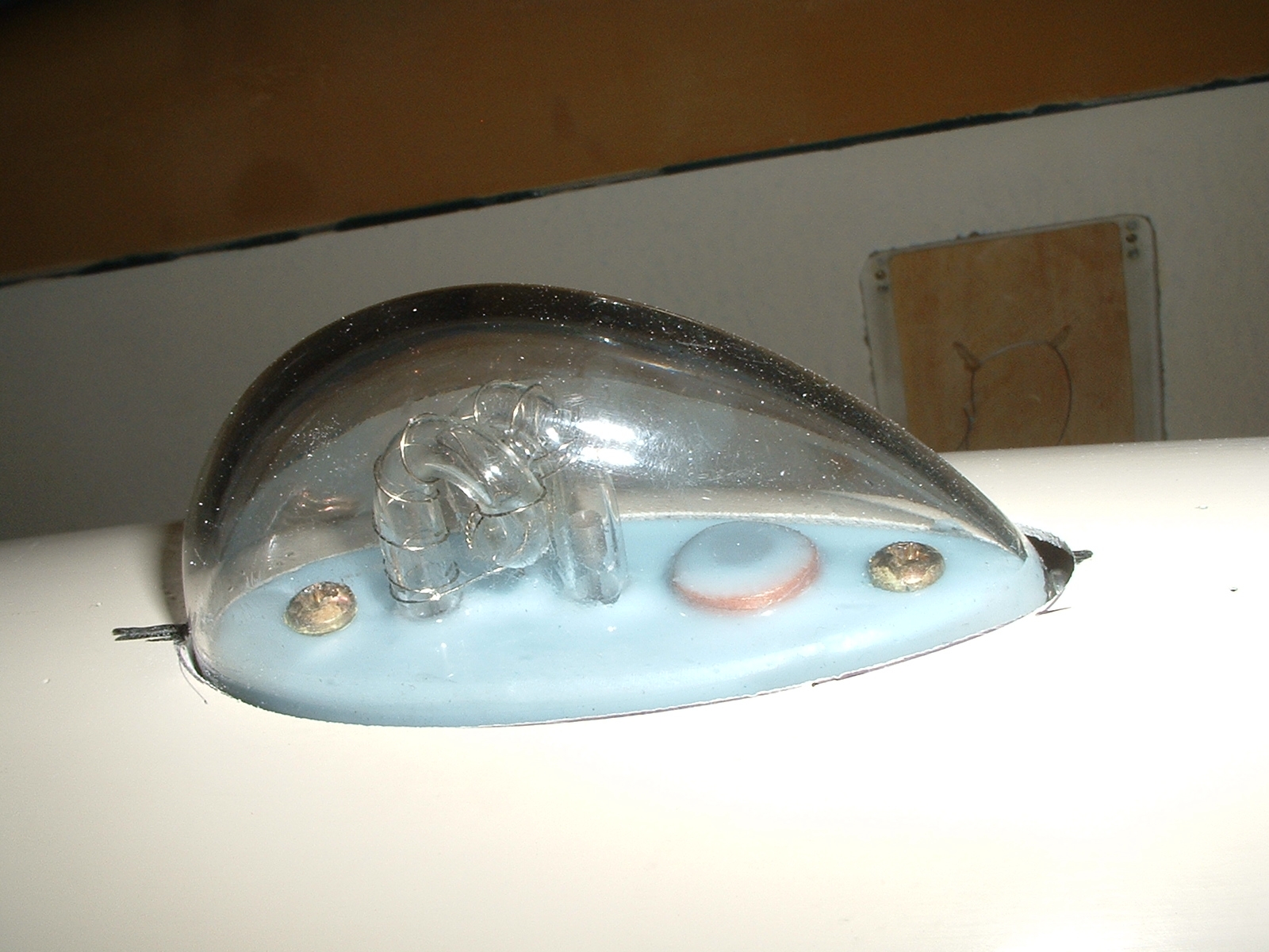

jan_de_jong(at)casema.nl
PostPosted: Tue Feb 17, 2009 9:36 am    Post subject: Anyone have info how they mounted wing tip strobe power sup Reply with quote
Hi Ron,
The other 3 pictures I thought to send.
Jan de Jong
 Filesize:  910.3 KB
 Filesize:  936.11 KB
 Filesize:  984.19 KB
