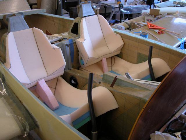

Using 1" of blue & 1" of green Confor foam, 16 x 18, for the seats, and 1" of uphostery foam for the back (rolled around a core of blue and green cut-offs for lumbar support)...plus assorted uphostery foam wedges...I think I spent close to $300. I allowed the seat foam to cantilever forward of the thigh support for additional thigh support for my long legs. Seat backs are separate, and (temporarily) supported by foam blocks in photo.
That Confor foam is really great stuff...very comfortable.
Fred
A194
