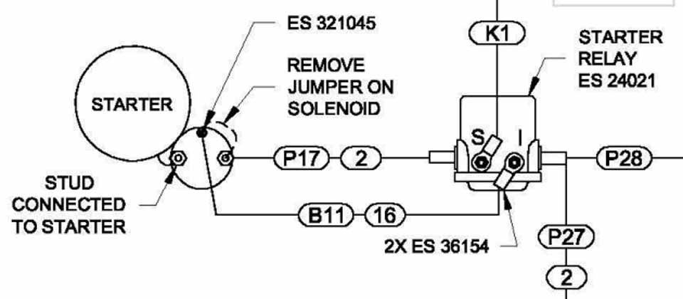

At 10:16 AM 2/18/2009, you wrote:
| Quote: | --> AeroElectric-List message posted by: "Vern Little" <rv-9a-online(at)telus.net>
Bob, Sky-tec's web site has information on wiring up their starters without starter contactors. In addition, they seem to directly contradict the recommendation of Van's aircraft on how to wire a starter contactor if one is used.
See http://www.skytecair.com/Wiring_diag.htm for more information. |
With all due respect to Skytec . . . the diagram offered
by Van's is technically correct and practical solution
for eliminating delayed starter dis-engagement reported
by many builders . . .
[img]cid:.0[/img]
| Quote: | | I plan on using an automotive relay instead of a 30A pushbutton switch to activate the solenoid as they recommend, but the principle is the same. |
Correct. You can do without external contactor providing
a robust current control path for the extra-ordinary inrush
demands of the built in contactor
See also . . .
http://www.aeroelectric.com/articles/strtctr.pdf
http://www.aeroelectric.com/PPS/Adobe_Architecture_Pdfs/Z22-23K.pdf
http://www.aeroelectric.com/PPS/Engine/Starter/PM_Starter_w_RunOn_Relay.pdf
| Quote: | | The folklore that I'm used to is that you need an upside-down starter contactor to be immune from large G-loads activating the starter. |
Urban myth . . .
| Quote: | | Seems if you eliminate the contactor, this is not a problem. Of course, this all depends on the design and reliability of the Sky-tec internal solenoid. |
I have no reason to suspect that the built in
contactor on a Skytec is any better/worse than
any other built in contactor.
See also . . .
| Quote: | | I've asked Sky-tec for clarification on the potential failure mechanisms of their solenoids (G loading etc.), but have had no response. |
G-loading concerns for contators are bogus.
| Quote: | | Any opinions on elimination of the contactor? For bonus marks, how about commenting on Van's recommendation of using the I contact in the starter contactor to feed the starter motor solenoid (both pics on the link above)? |
It's a slick implementation of features offered in
automotive contacts and has much to recommend it.
( . . . a long habit of not thinking )
( a thing wrong, gives it a superficial )
( appearance of being right . . . )
( -Thomas Paine 1776- )

rv-9a-online(at)telus.net Guest
Posted: Wed Feb 18, 2009 10:57 am Post subject: Sky-tec starters - elimination of Starter Contactor |
Thanks, Bob. I am using Z22 with diodes (like your last figure), only the ground of the relay goes to an oil pressure switch to prevent accidental operation of the starter when the engine is running (don't ask!).
I understand the run-on problem is due to self-generation of the starter, and Van's prevents this by splitting the solenoid current from the primary feed. Clever use of the "I" terminal on the contactor.
Since Skytec is pretty adamant in their wiring diagrams, I suspect that they have not experienced run-on problems... but who knows?
My choice of a relay vs. contactor comes down to whether I want a hot battery lead connected to the starter for the full duration of flight. I suppose that if it ever came off the starter and shorted that bad things may happen. I just have to mitigate or accept this risk.
Thanks for your help.
Vern
