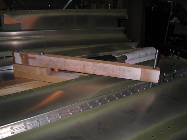

I made a very simple rivetting tool out of wood, a few bolts and piece of .5 ID tubing. It was the best 1 hour I've spent. I use it to rivet alls sorts of things. You use a half inch steel rod as the driver, and a hammer to set the rivets with. I did all my spar rivets with solid rivets (make sure to get the hardened ones). I'll post a picture. There are a lot more pictures on my website at:
http://daniel.dempseyfamily.us
Dan

This is the rivet tool.
 Filesize:  32.66 KB
 Viewed:  8138 Time(s)
