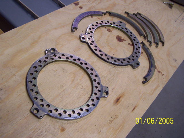

I noticed that my model II Matco brakes has a rotor that has lighting holes drilled all over. The newer brake assembly that came off a model IV that I am installing does not. Has anybody heard if there has been a problem with the older rotors?

no problem. They came solid and people drilled them out to save weight. I have a set of each also. I used the drilled ones as they were noticeably lighter.

My Model IV manual shows the lightening holes in the brake rotors to
be an owner-modified option. I did the drilling and cutting on mine,
and have had no problems whatsoever in over 600 hours.

Matco as of recent has started to lighten up their brake systems. I believe this was due to several factors. One being the LSA Mfg's wanted lighter brakes for aircraft sold overseas. Their weight limit for the plane is 450Kgs instead of our 600kgs. This was an issue for Flight Design planes where these Mfg's count ounces and not lbs.. I am an OEM for Matco brakes. Also it would stand to make since that less material used in the entire Matco brake line products would add up to lowering cost. The older rotors were quite thick and heavy. Now many newer rotors are thinner and have debris/water removing groves cut in. In the last year they have done some redesigning. They have made a flange mount brake for the Flight Design round axle socket so it can be adjusted for toe-in and out plus camber. They have been great to work with.

I also drilled and cut to save weight.  With a 912UL had a hard time holding the airplane on runup.  Did fast runups C bought new rotors C cut extra material on outside but drilled no holes.  That worked with the 912UL and can hold my 912ULS now.  With a 72 inch 3 blade prop and 912ULS a lot of thrust.  Should be no problem with a Jabiru.

I offer the following as a substitute for a NASA Form 277 (get out of
jail free)...Snake will know what I mean....and maybe Guy will too. : )
Charles-
Here is what the lightened rotors look like....as you can see, just
cutting off the material that just goes along for the ride quite a
bit of relative weight is saved. I weighed mine at the time of the
operation, and the original disc weighed 1#, 10 oz. and after
drilling and cutting weighed 13 oz., so the weight is cut in half.
For further lightening, you can drill the axles, also shown on the
original drawing in the builder's manual. I did this as well, and
saved a further 6 oz., but I didn't record at the time if this was
one axle or both...either way is wasn't much.

PostPosted: Sat Feb 14, 2009 11:18 am    Post subject: Brake rotors Reply with quote
Lynn C I drilled mine. But C was wondering how you cut off the outside edge between the mounting tabs. Can't use a lathe C which I don't have anyway C because you'd cut off the tab also. I imagine I removed a little less than 1/2 the weight you did by removing the outside edge.

PostPosted: Sat Feb 14, 2009 1:20 pm    Post subject: Brake rotors Reply with quote
As you can see by the picture, I drilled a large...can't recall the
size, maybe 7/16"... hole so that the edge was tangent to what would
become the new outer diameter of the rotor proper, then bandsawed the
rest of the material away. Previously, I had "painted" the whole
rotor with Dykem blue layout dye, and marked out each hole and cut-
line with a scribe. Then it was just a simple matter of doing the
drilling and the sawing....pretty standard metal-removing tactics for
a home shop...with a bandsaw, of course. Any local machine shop could
do it if you don't have the saw.

On Feb 14, 2009, at 2:17 PM, patrick reilly wrote:
Lynn, I drilled mine. But, was wondering how you cut off the
outside edge between the mounting tabs. Can't use a lathe, which I
don't have anyway, because you'd cut off the tab also. I imagine I
outside edge.

PostPosted: Sat Feb 14, 2009 2:25 pm    Post subject: Brake rotors Reply with quote
Lynn C OK C thanks for the info. I have a craftsman 12" bandsaw I use on wood and occasionally aluminum. I don't think it is powerful enough to cut steel 1/4" thick. What bandsaw and blade did you use? I drilled mine after laying out per builders manual similar to you. If I take my wheels off and have the time I will either buy a bigger bandsaw or lay it out C drill the holes and have a machine shop saw off the outer rim.

PostPosted: Sat Feb 14, 2009 3:54 pm    Post subject: Brake rotors Reply with quote
Pat-
Don't even try to use a wood bandsaw for steel unless you can reduce
the speed from the wood speed of approximately 2500 blade-feet-per-
minute, to about 675 bfpm for the steel. Then you need to use at
least a "general use" saw blade with (at the least) about 18 teeth-
per-inch (TPI). I have an old Delta bandsaw that has a speed reducing
gearbox, and that's about the only good way to get the blade speed
reduced. You can try to make a jackshaft for your machine, but it
takes some pretty big...and small...pulleys to get the speed down to
where it is safe to cut steel. And the blade needs to say on the
package that it's for steel...it will have the aforementioned fine
teeth, and a blue color. There should always be at least two teeth in
contact with the metal at any time during the cutting.

On Feb 14, 2009, at 5:24 PM, patrick reilly wrote:
Lynn, OK, thanks for the info. I have a craftsman 12" bandsaw I use
bigger bandsaw or lay it out, drill the holes and have a machine
Pat Reilly

PostPosted: Sun Feb 15, 2009 9:17 am    Post subject: Brake rotors Reply with quote
Lynn and Patrick, I would remove the outer rim of the rotors by making 4 or 5 radial cuts with an angle grinder and cutoff wheel, up to the outer radius desired for each segment to be removed (like slicing a pie). Then lop of the segments with the cutoff wheel and round off the circumference with a grinder wheel on the same machine and dress with a file. No need for a band saw here. I didn’t bother because the weight savings seemed small, but next time the rotors are off I will. I also drilled my axles one inch and tapped them for a 5/16 bolt for future wheel pants. Then I made a C shaped clip out of thick steel wire to pin the axle bolt and eliminate the cotter. Now I can drill the axle dust caps, and install a stud to stabilize the pants. I want to fly it a bit before adding the wheel pants. Got the engine and radiator in this weekend. I vented the cylinder head into the water line exiting the head above the oil pump since my water fill tank has no nipple. Any 582 guys see any problem with this? I also didn’t like the use of only three bolts for the exhaust manifold, so I put short studs in the upper inside holes and can put nuts on it by tightening the two nuts gradually as the manifold goes on. I had to grind a little weld material from the flange so the nuts are seated flush. Worked great.
