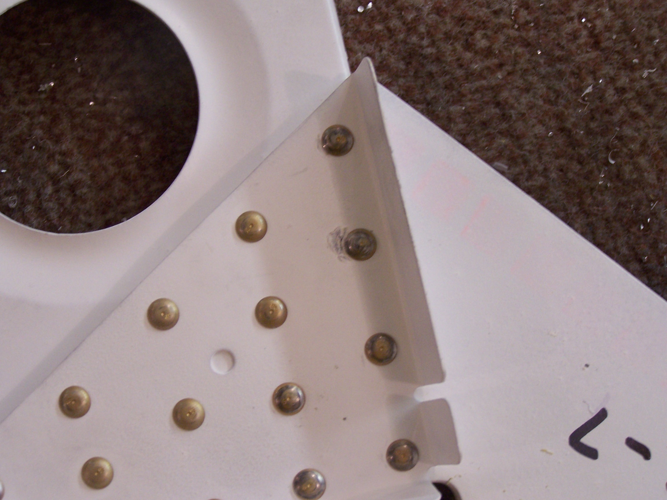

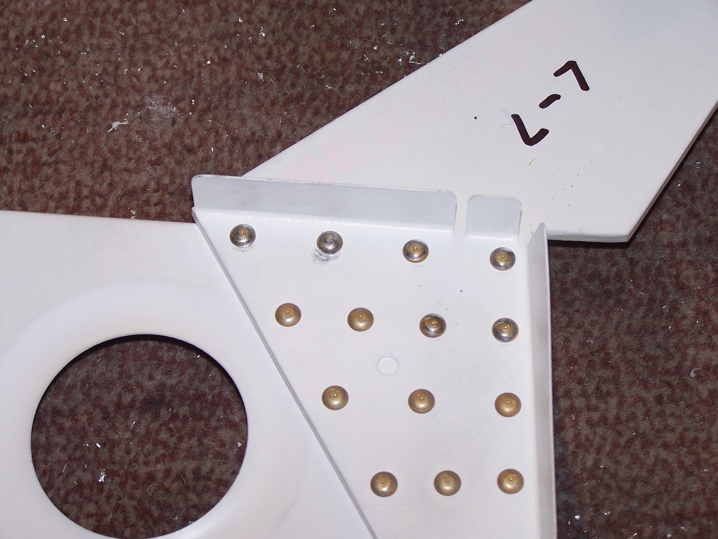

Page 14-3 step 5. Tonight I was riveting the W-1025B-R Flap hinge rib and W-1025A Flap hinge bracket to one of the W-1011-L inboard wing ribs and my rivet gun slipped. Bottom line is that I "smilied" the flap hinge rib a little bit below one of the rivets. I'll attach pictures for details. Is there enough strength in the rest of the rib/rivets to leave it alone or do I need to fix it??? If I need to fix it could I cut a doubler to go over the damaged hole and to the rivets surrounding the damaged hole???

That doesn't look too bad, I'd probably just leave it, unless you see
that it really went deep into that rib. But it really doesn't look
worth worrying about. If you did do a doubler, you'd want to do one
that covered a bunch more area, so you'd probably end up removing
at least a couple more rivets.
