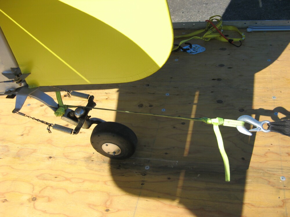

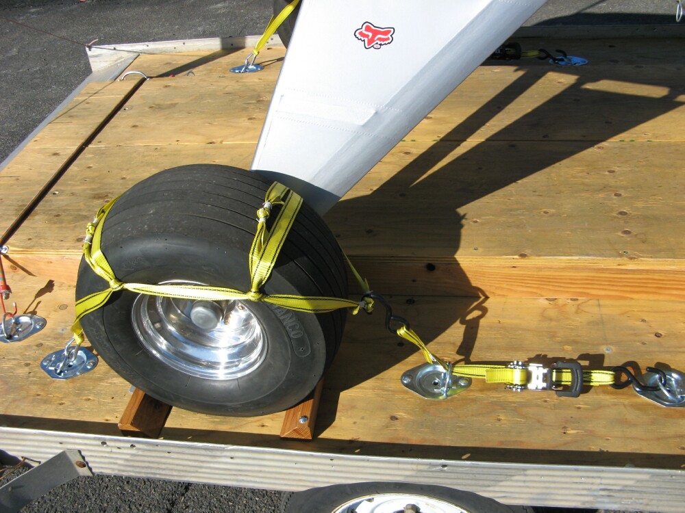

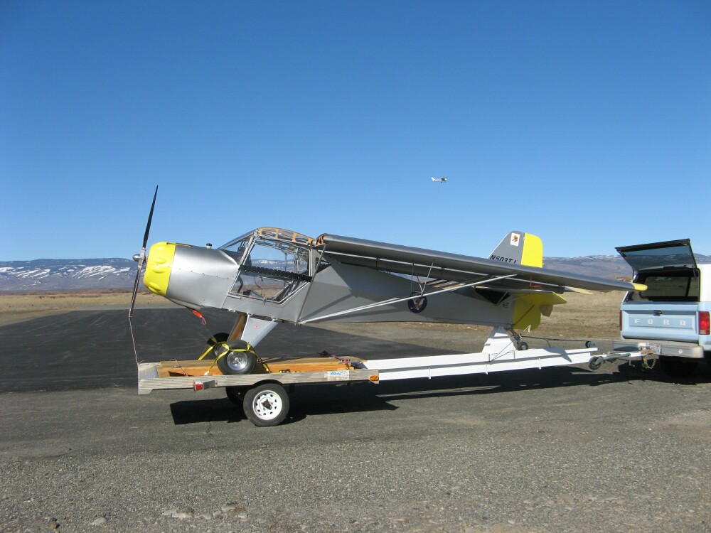

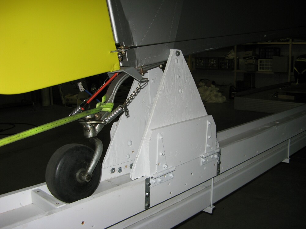

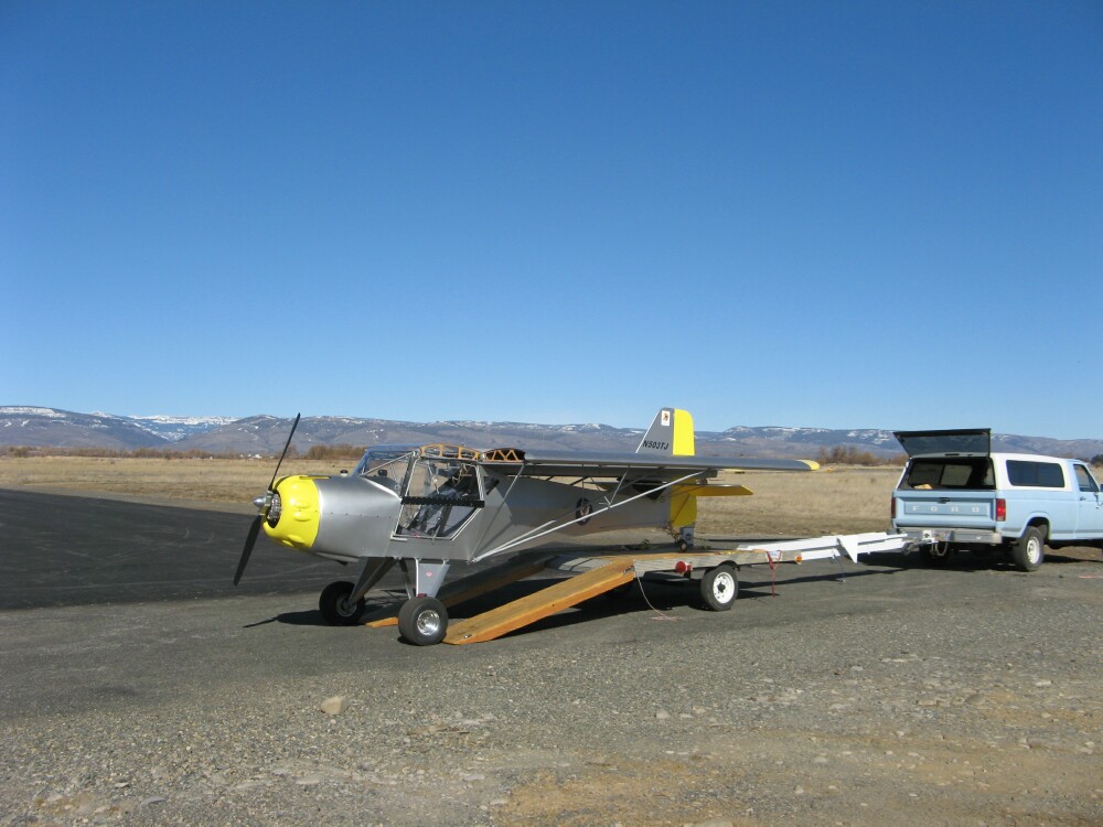

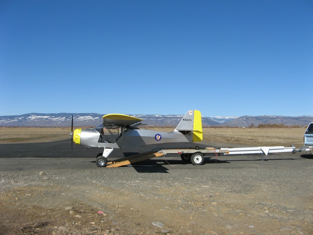

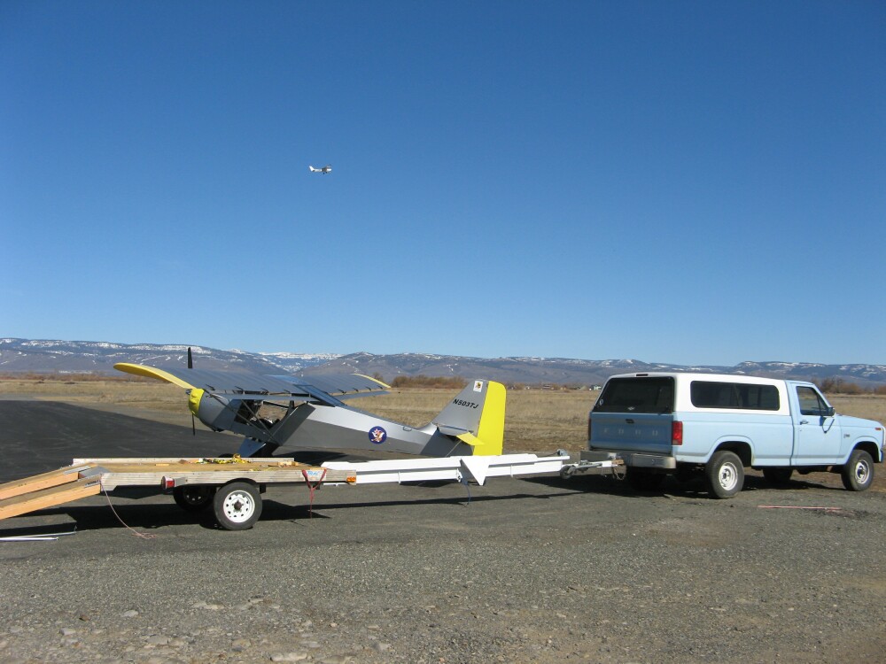

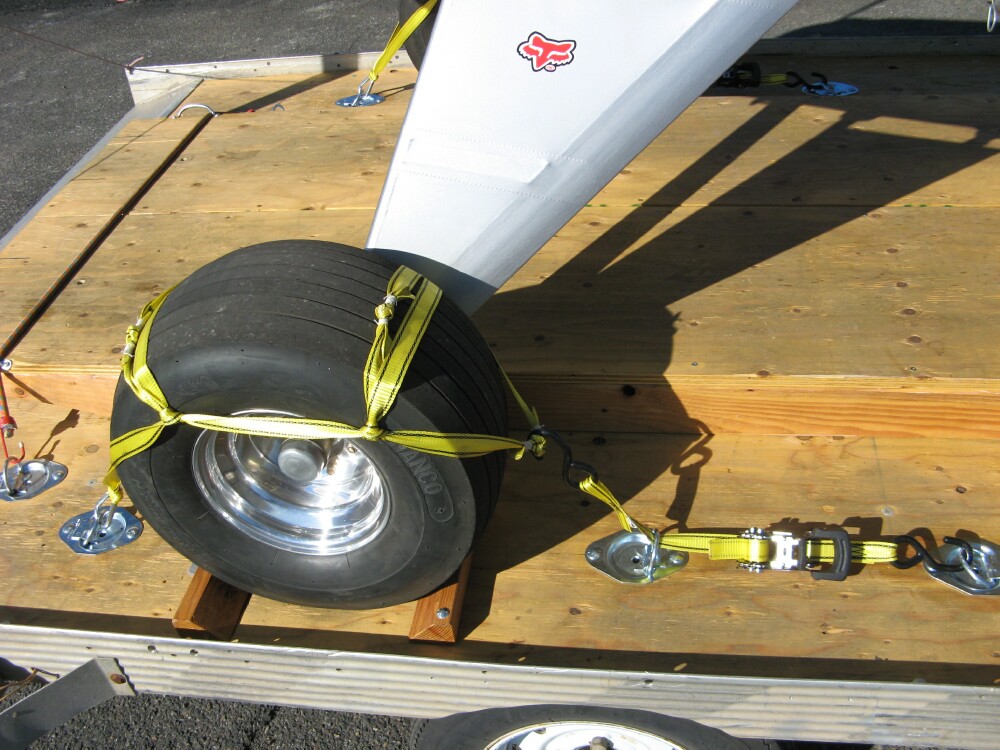

John, Attached are a few photos of my kitfox trailer. I couldn't attach them in a reply to PM, so here they are. Others may be interested anyhow.
It is an old two place snowmobile trailer. I replaced the tongue with one 16 feet long. There is a little hand crank boat winch on the front of the tongue to crank the Kitfox up onto the deck. I set the tail on the deck before folding the wings.
If I was starting from scratch I think I would design a trailer so that the kitfox would sit lower to the ground like you see some of the modified boat trailers. I just used this trailer because I already had it on hand.
