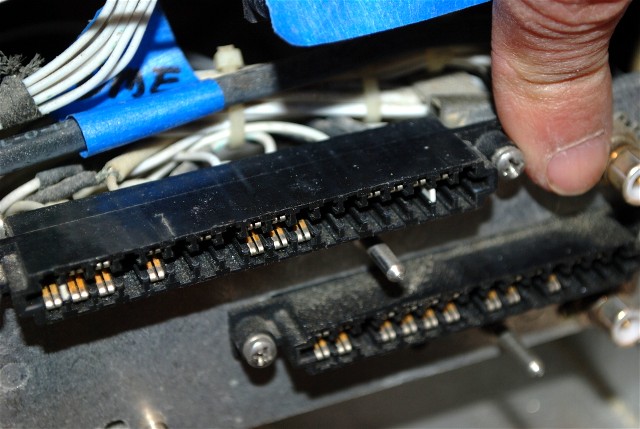

Without having access to the manufacturer's parts
list, identifying a second source for a suitable
connector is not possible. Can you post a photo
of the original connector? It would also be useful
to see a photo of the back of the radio. Finally,
confirm the wire-to-wire spacing of conductors
on the card edge.

PostPosted: Wed Feb 04, 2009 6:20 pm    Post subject: Re: Trying to obtain card edge connector for KX165 Nav/com Reply with quote
The connector is an 18 position, double row, with .156" spacing. I'll try to attach a picture below. Looks more like an AMP part than Molex, but for testing purposes I suppose it does not matter. Since I don't want to spend money on special crimpers and insertion/extraction tools, I suppose I would benefit from a type I can solder on to. If you know off hand of a suitable part number, I'll give it a try.
Would it be OK to power up the KX165 without connecting anything to the Nav section?
--Jose

PostPosted: Wed Feb 04, 2009 6:44 pm    Post subject: Re: Trying to obtain card edge connector for KX165 Nav/com Reply with quote
Correction - the Com section connector (P401) that I need is a 15 position connector. (The 18 position connector is for the Nav section, presumably.)
