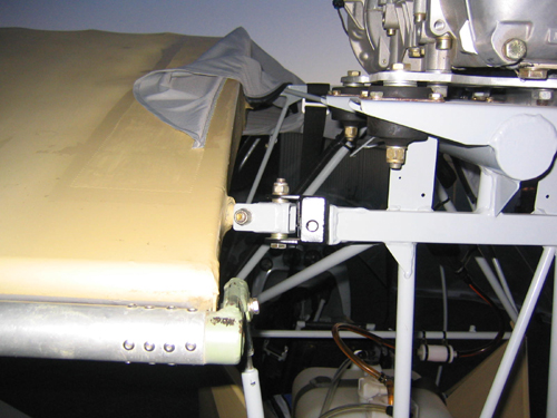

PostPosted: Wed Feb 04, 2009 9:22 am    Post subject: Re: legs Reply with quote
Hi All,
Perhaps another way to tweak the incidence on your Kolbs is to pickup a set of the England U-Joints. They will allow you to make minor changes in the wing incidence to see if it is something that would improve your Kolb with out cutting or welding.
If you see some improvement you like then you can make permanent changes to your wings or tail feathers.
Best Regards
Carlos G
 Filesize:  162.56 KB
 Viewed:  643 Time(s)

I like the behavior of more dihedral because it allows you to cruise
more with your feet.
On 4, Feb 2009, at 12:22 PM, The BaronVonEvil wrote:
Hi All,
Best Regards
Carlos G
http://forums.matronics.com/viewtopic.php?p 28462#228462
http://forums.matronics.com//files/english_u_joint_328.jpg
