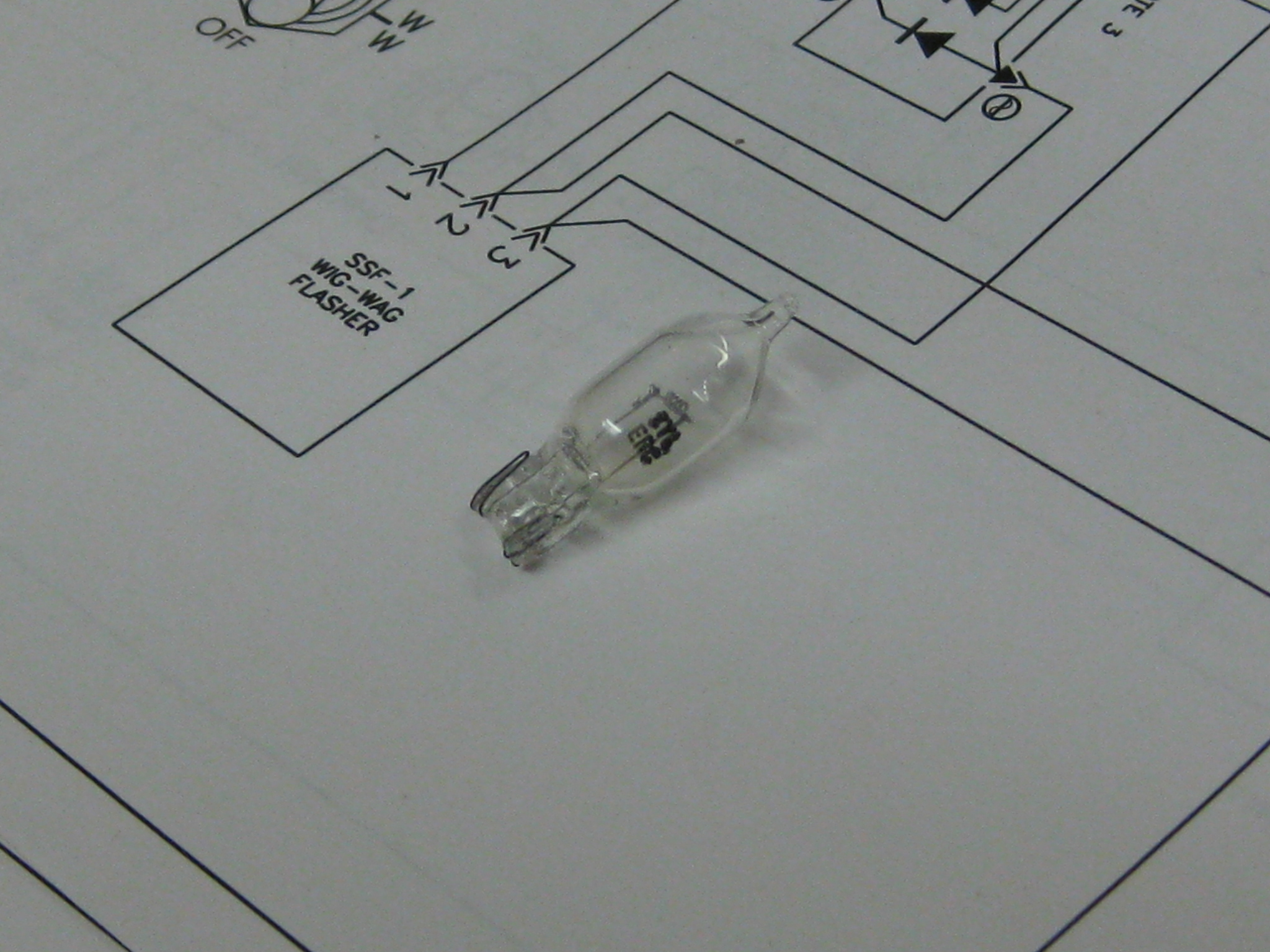

n8zg(at)mchsi.com
PostPosted: Fri Jan 30, 2009 7:52 pm    Post subject: Whelan white position light Reply with quote
Shemp -
This one looks remarkably similar to an automotive turn signal / marker
light.
It's marked:
SYL
ERC
Or maybe it's
SYL
ERG
The receptacle is marked: TP20 - (bulb type?)
Neal

 Filesize:  869.76 KB
 Viewed:  236 Time(s)
