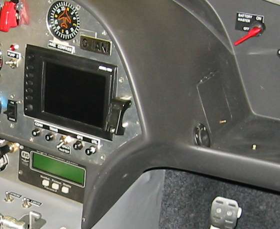

g-iani(at)ntlworld.com
PostPosted: Fri Jan 30, 2009 10:55 am    Post subject: Instrument module access cover Reply with quote
Mine covers the access to the serial connectors for attaching a computer to various items. Picture attached
Ian Rickard G-IANI XS Trigear, 200 hours
Europa Club Mods Rep (Trigear)
e-mail mods(at)europaclub.org.uk
or direct g-iani(at)ntlworld.com

ptag.dev(at)tiscali.co.uk
PostPosted: Fri Jan 30, 2009 12:55 pm    Post subject: Instrument module access cover Reply with quote
Hi! Raimo.
I have to somehow change my radio stack to accommodate my Mode S Transponder and since it is the top unit it is out of sight from the engine side of my FWF removable panel.
I expect that I will cut out a sizeable panel, construct some flanges and make such a flap removable since my panel is not removable. I don’t consider the Europa Panel to be a structural item anyway and provided such cut out is re-enforced I don’t see a problem.
Bob Harrison G-PTAG
PS if Steve Hagar is reading this his reply re:- fuses in such a place concerns me that he can access the fuses from the P1 position if he has to change one in flight?
Bob H
