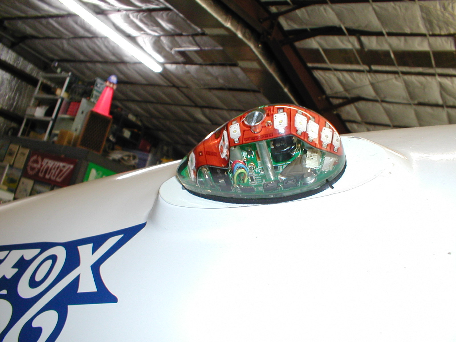

In regards to The Aveo strobes,I have them on my Kitfox. The amp load is very low and that is why I bought them. I removed my Whelens and sold the set on EBAY. Now I wish I had them back. The Aveo's work well but they are no where near as bright as the Whelens.

I to have switched out my Whelen strobe system for the Aveo. I on the other hand really like the system vs. the standard strobe setup. First I would say the important issue is visibility in flight not on the ground. Our tests (not formal) show that a new Whelen strobe is a bit more visible then the Aveo. We also found that the Aveo is more visible then the Aeroflash system. Most importantly we noted that on three airplanes that had Whelen systems that were two years or more in age the Aveo was the same or more visible. The pros to the Aveo system: in most installations a 3 plus pound weight savings was achieved, a savings of 170 watts +/- 20 depending on which brand of strobe you installed( that's 14-amps on a 12v system), the Aveo does not put out high voltage and therefore is less problematic with RF noise, the Aveo light life has a 20,000 hours life and is virtually maintenance free, the Aveo unit takes up much less space, and most importantly, if you find the right dealer the price is half or more depending on which brand of strobe you purchased.

<Kitfox 038.jpg>[b]

I totally agree with you in regard to the Aveo strobes. They are very light,compact,no power pack,and very low amp draw which I needed for my Rotax. Max continuous is supposed to be around 14 amps so I am trying to keep the strobe draw low as I have other equipment (all low draw). I just wish the Aveos were a little brighter. I ask the guys on the ground if they see them and they pretty much say no. I am going to keep them though.
I am looking into the new Kentzleman (sp) landing,taxi, recognition light. It is supposed to be 2 1/2 times brighter than a 55 watt halogen headlight and draws less than 1 1/2 amps ! Put a flasher on it (auto store) and you would look like Southwest with their flashing landing lights! The thing is only 3" x 1" It too uses high power LED's. Anybody have one? It's an expensive item (about $230 (at) Spruce)
I installed a Monroy 300 in the panel of my Kitfox for traffic alert. Now that little jewel works great and in this high traffic area it is handy to have! We have a large number of T-34C's and helo traffic from the Navy.
