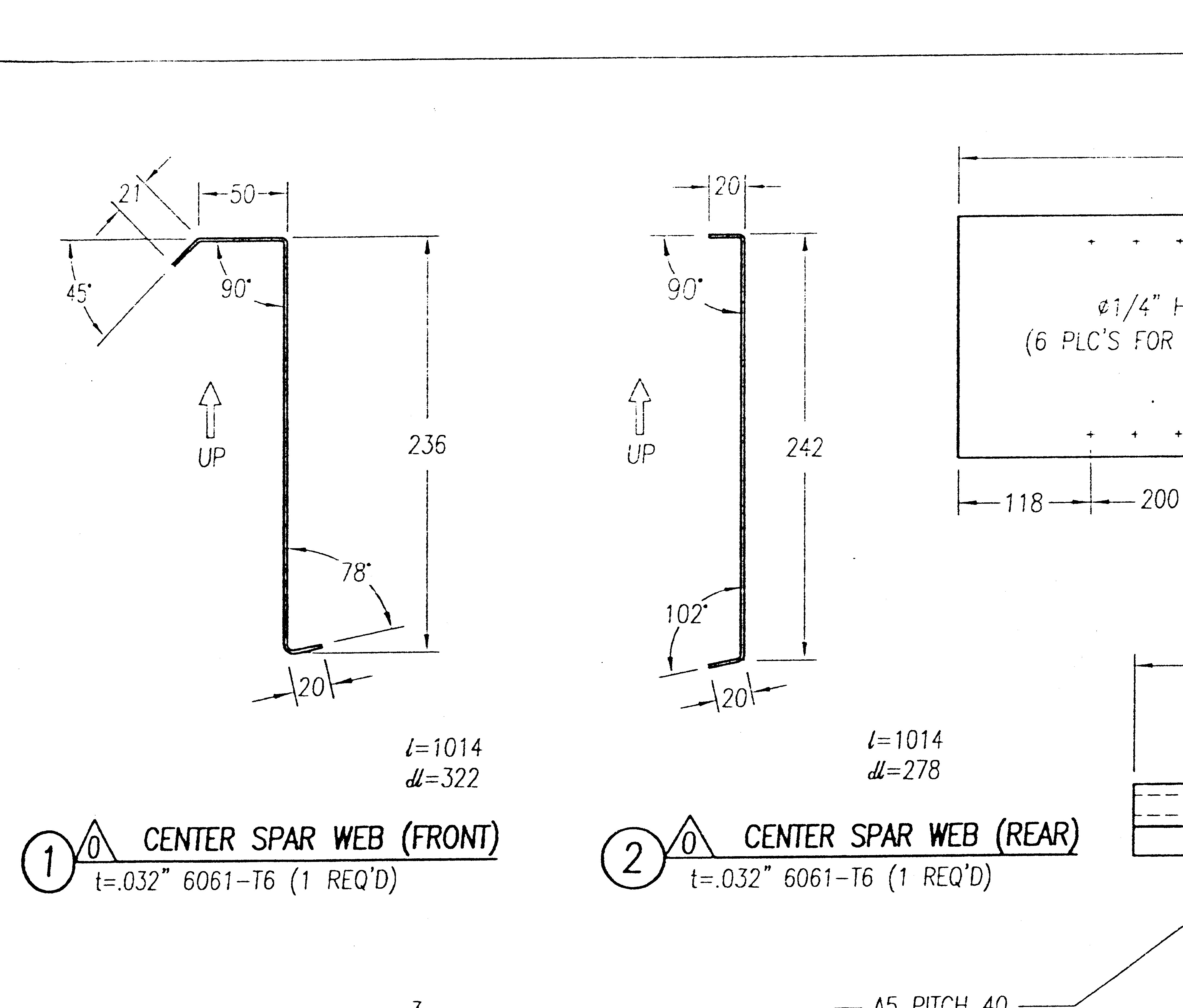

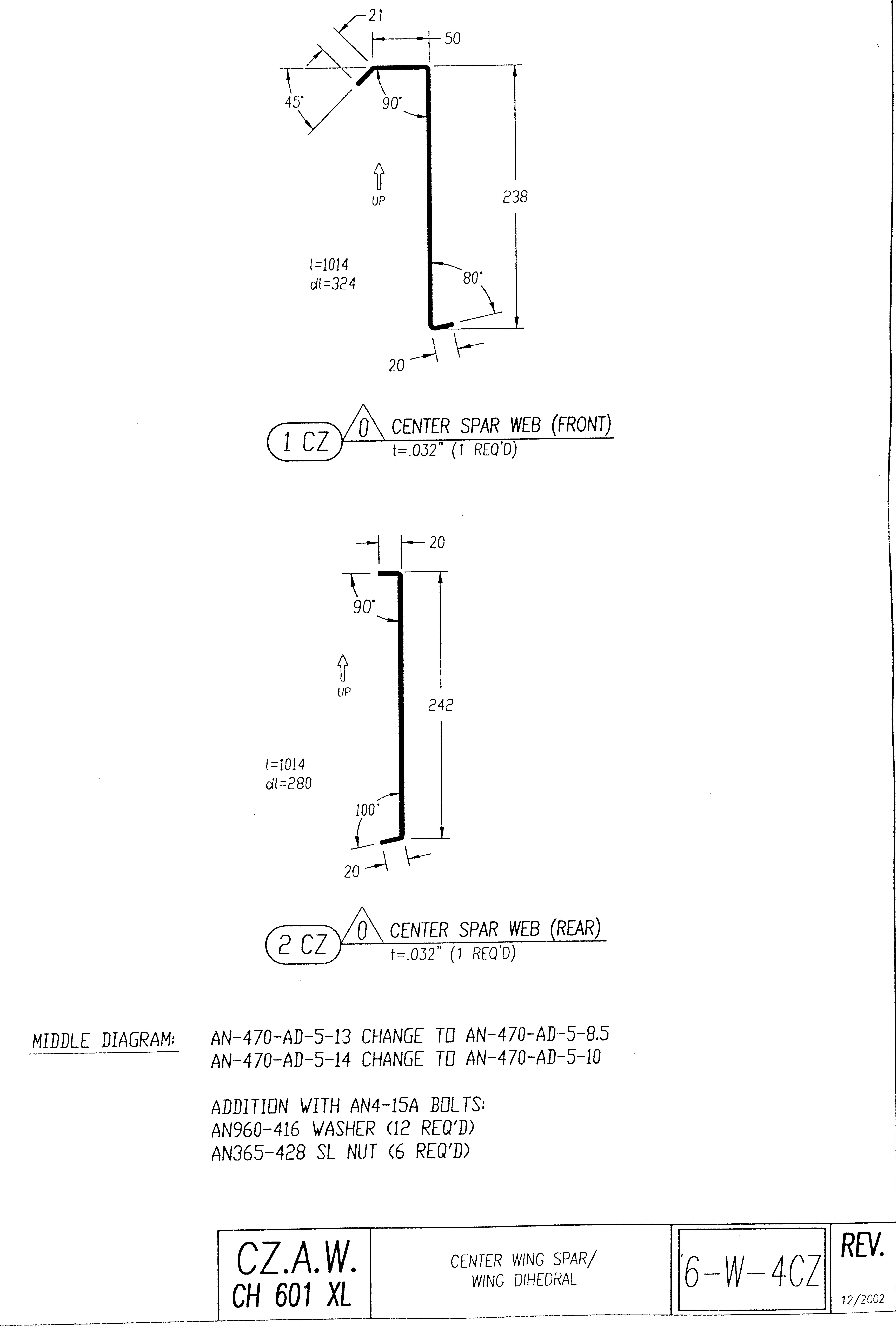

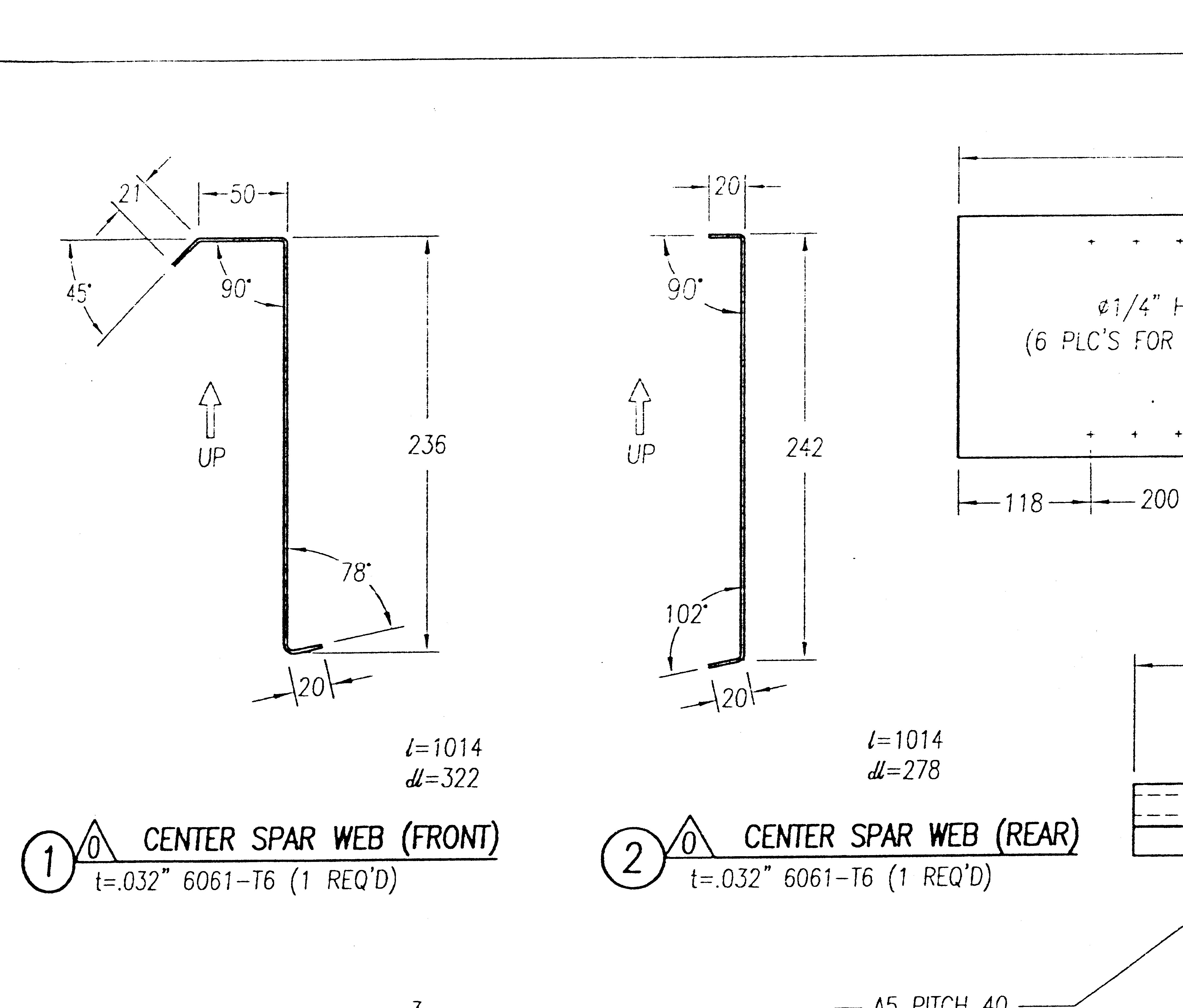

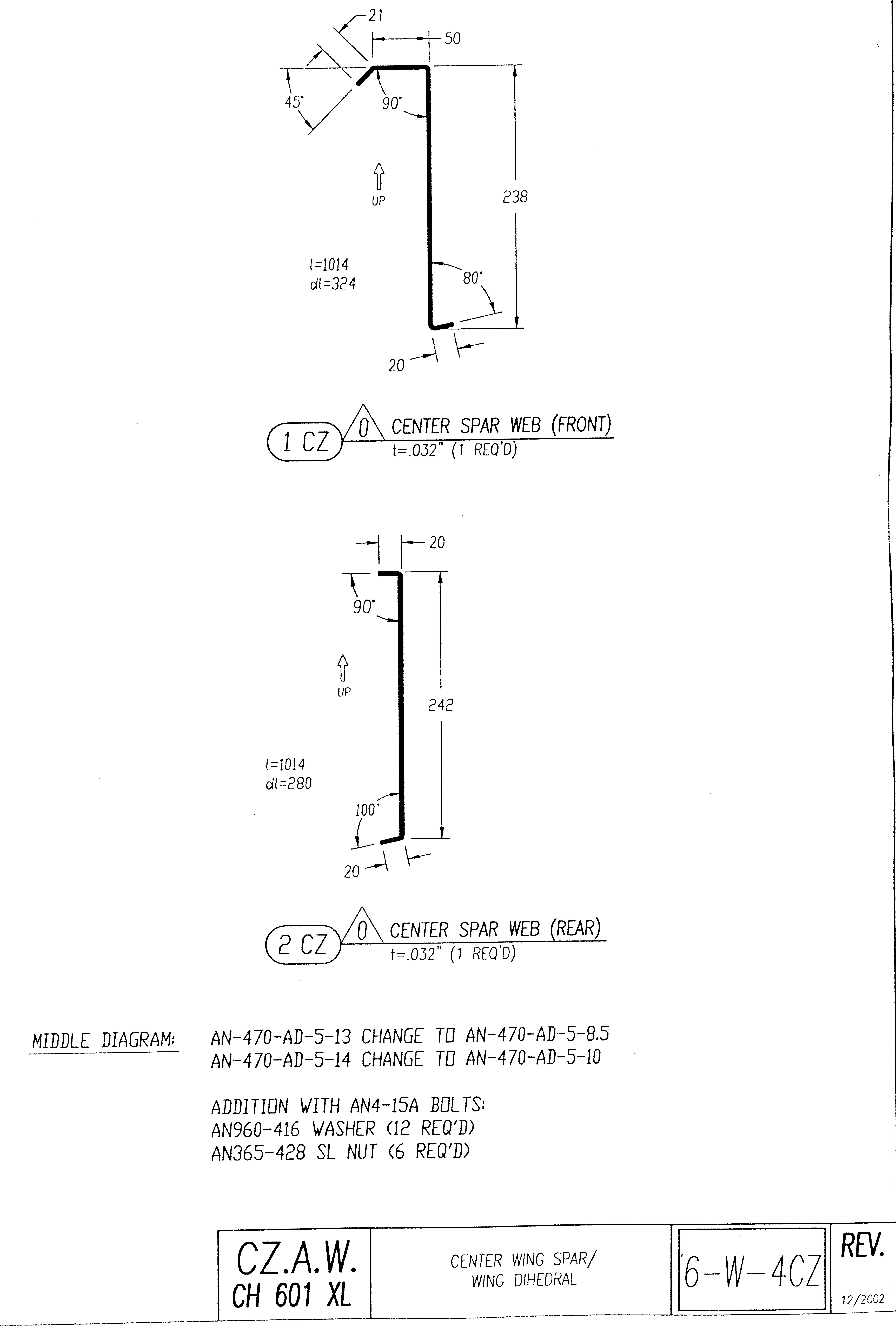

Sabrina,
I have scanned in the spar web drawings from my CZAW set. The drawing set
includes the 'standard' set, together with additional sheets showing the
CZAW changes. The relevant sheets are labelled 6-W-4 and 6-W-4CZ
I think you can see that the CZAW webs use 80 & 100 degrees, compared with
the original values of 78 & 102
I hope this answers (at least 1 of) your questions!
Dave Johnson
